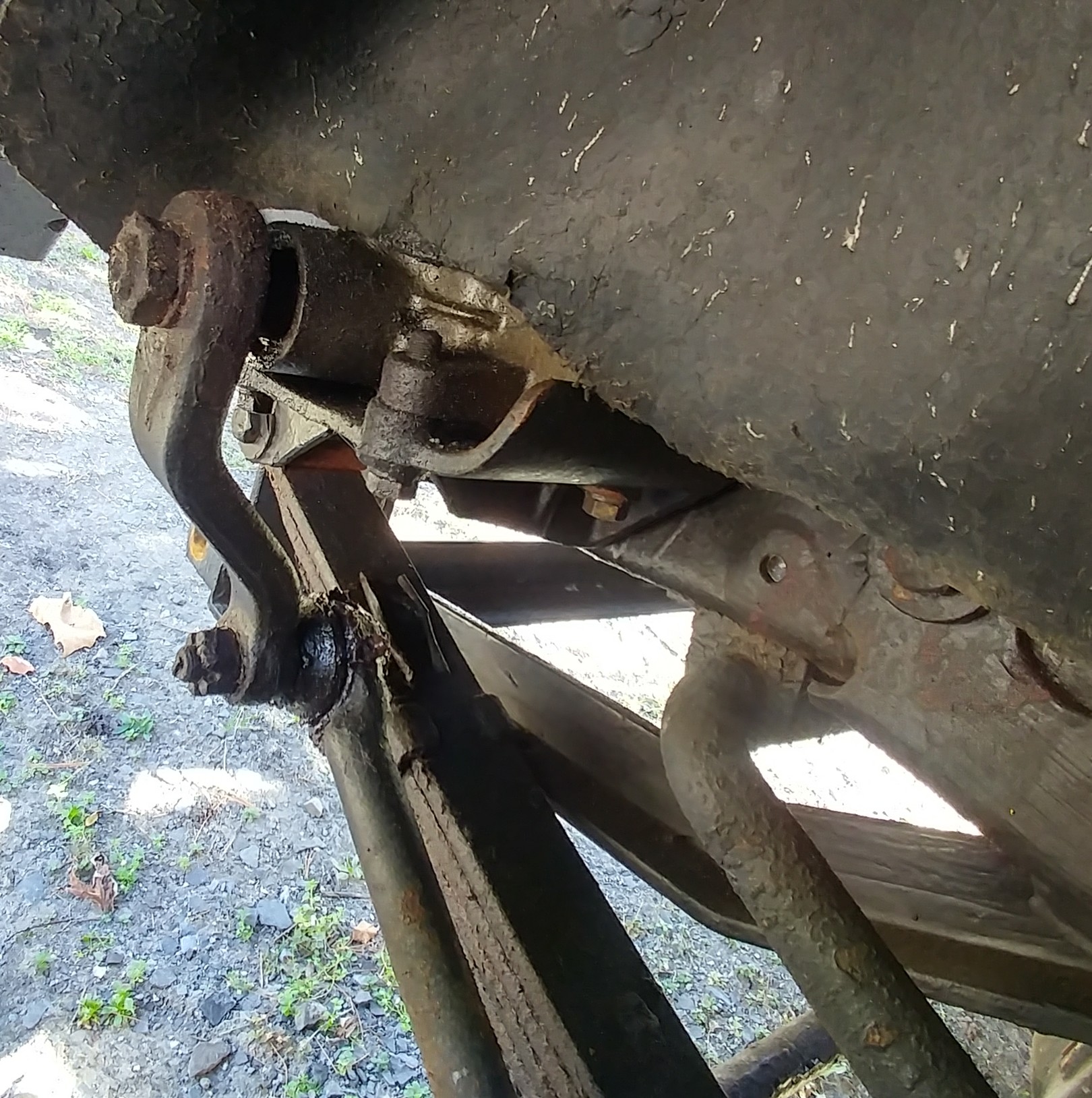

  #160
Center to center of each hole is approximately 6.5". Total drop is approximately 2.5"
Old Oct 21, 2017 | 02:11 PM
  #161
juggernautt's Avatar
Joined: Sep 2009
Posts: 45
Likes: 6
Thank you! You're help is much appreciated.
