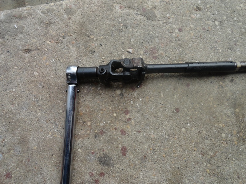

Since I try not to make decisions based upon opinion of others, without some evidence presented, I decided to take matters into my own hands, and prove to myself whether or not that the jeep joint / shaft is safe.Today, I took one of the jeep shafts and tested it for strength of the joint.
I took the spline end of the steering gear that I had lying around, and installed it into an impact socket by grinding the base to fit the hex. After doing so, I put the 1/2 shaft from the jeep into my workbench in my shop. I set my torque wrench to the maximum it would produce which is 160 FT LBS of torque. I proceeded to then put all of my 235lb body weight downwards on the torque wrench to attempt to twist the shaft till torque registered in the wrench.
Results ?
The torque wrench didn't make it to the 160 ft lbs.
Upon testing, the 1/2" double "D" shaft, that's welded to the top of the joint which heads upwards towards the steering column, twisted upon itself and prevented the torque wrench from registering it's setting of torque. I nearly killed myself, because my workbench, which weighs upwards of 300 lbs (due to all the machinery on it) lifted up @ the rear of the bench, and was going to topple over on me, if I kept wrenching down on the torque wrench.
So, let's review
  • 235 lb guy using a torque wrench set to 160 FT LBS
  • Twisted upper shaft (like a torsion bar on a chrysler front end)
  • lifted a 300 lb bench while attempting to reach the 160 ft lbs setting on the wrench
  • No effect on the joint.
You guys decide whether or not it's safe....
BTW...
Borgeson doesn't use any "bolt or roll pin" to attach itself to the steering gear, as it uses a "set screw" pressured up against the flat spot of the gear input shaft. When I asked them about this, they said "it was perfectly safe, and after decades of using this system, they don't see any issue with it at all " I'm sure this may be true, but the simple fact that Chrysler engineers use a 5/16" Equivalent bolt to "lock" the joint to the input shaft, I feel more confident that it's a better setup that a simple set screw pressured up against the flat spot of the input shaft.
I like to make my decisions based upon real world testing, and reviewing best options at the time, whenever possible.

Old Mar 17, 2012 | 11:33 AM
  #145
bobva's Avatar
Posts: 840
From: granite falls washington
Well thank you Adam Savage I'll be waiting for this episode on mythbusters.
Ok Adam you proved the Jeep Joint can handle a torque load with pressure applied slowly.
Although Im 6'2 @ 295ish lbs and can stand on a beer can without crushing it. Pressure applied slow and careful.
I think what we need is sudden impact action.
Since the use of C4 should not be used in your shop. We should resort to the simple tool of a 10lb sledgehammer.
Allways wear your safety goggles & hearing protection when performing these tests.
Old Mar 17, 2012 | 12:57 PM
Well, Daisy
http://www.youtube.com/watch?v=63h_v6uf0Ao&feature=fvst
After doing my test, I think I'm ok with the "strength" of the joint, which to me was what was the only thing in question.
The Impact that was the advised "concern" previously, doesn't really mean anything to me now (after my test of strength) , as it would require a "perfect storm" scenario where the steering wheel was locked while driving. As far as I can remember, I can't hold a steering wheel locked in place, as I'd have to move the key back to lock the column, ..... which would make it difficult to drive..
If it didn't break with a 3' long steel bar bearing down on it, it's not going to break during an impact with an immovable object, such as a curb. The tire would deflect, and I'd lose one of my mudders first.

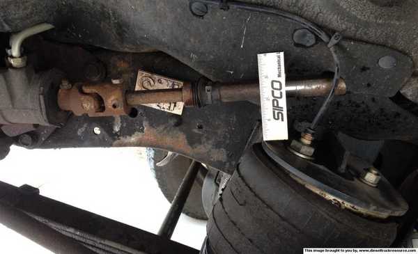

Old Mar 18, 2012 | 12:38 PM
  #150
james1's Avatar
Posts: 807
Likes: 41
From: Englewood, TN
Question question
Have finally assembled all the components necessary to do this modification and am now concerned about the Kelderman airbag. Will installing the reverse rotation box change the angle of the steering shaft enough to interfere with the airbag? There is currently about 1.875" of clearance between the shaft and the steel airbag mount.
TIA.
