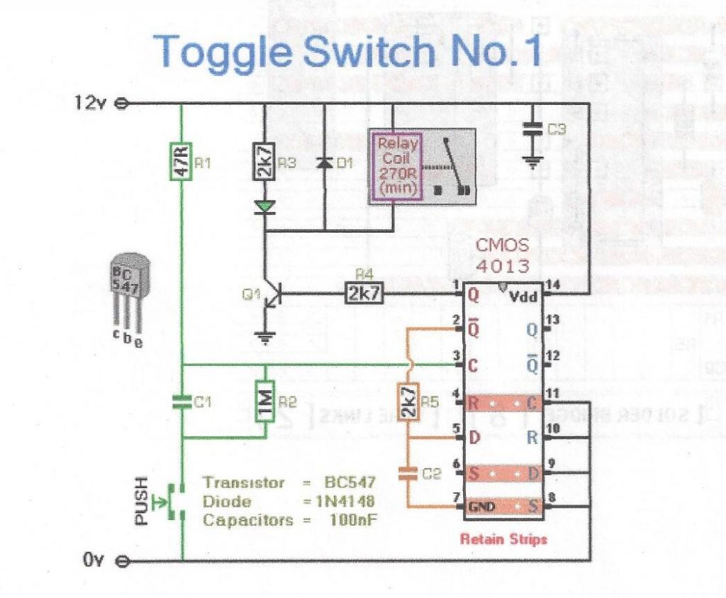

You can use your exiting OD on/off switch with this simple to build circuit. The switch, and light will act as though it were still attached to the ECM but isn’t. The circuit defaults to the OD on position when the ignition switch is turned off just like factory. One push of the button and OD turns off and illuminates the OD light. Another push, the light goes out and OD engages. Just like factory.

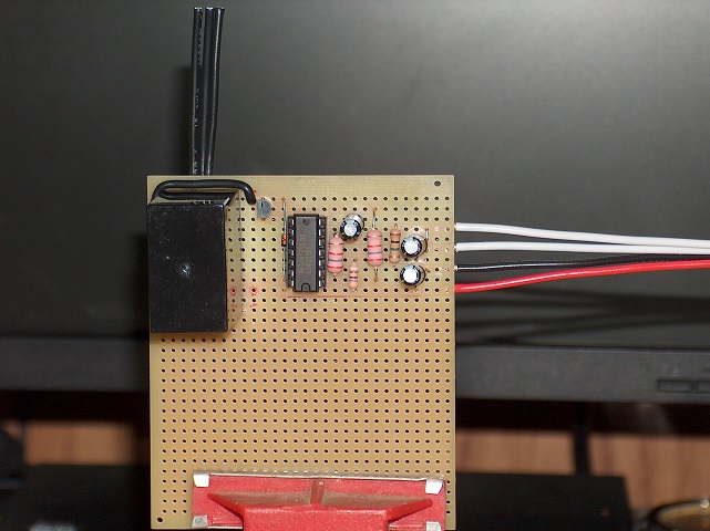

Building the toggle switch board is fairly easy with basic soldering skills and an Exacto knife to cut the traces on the board. All of the parts I used I ordered through Digikey except for the relay I used.

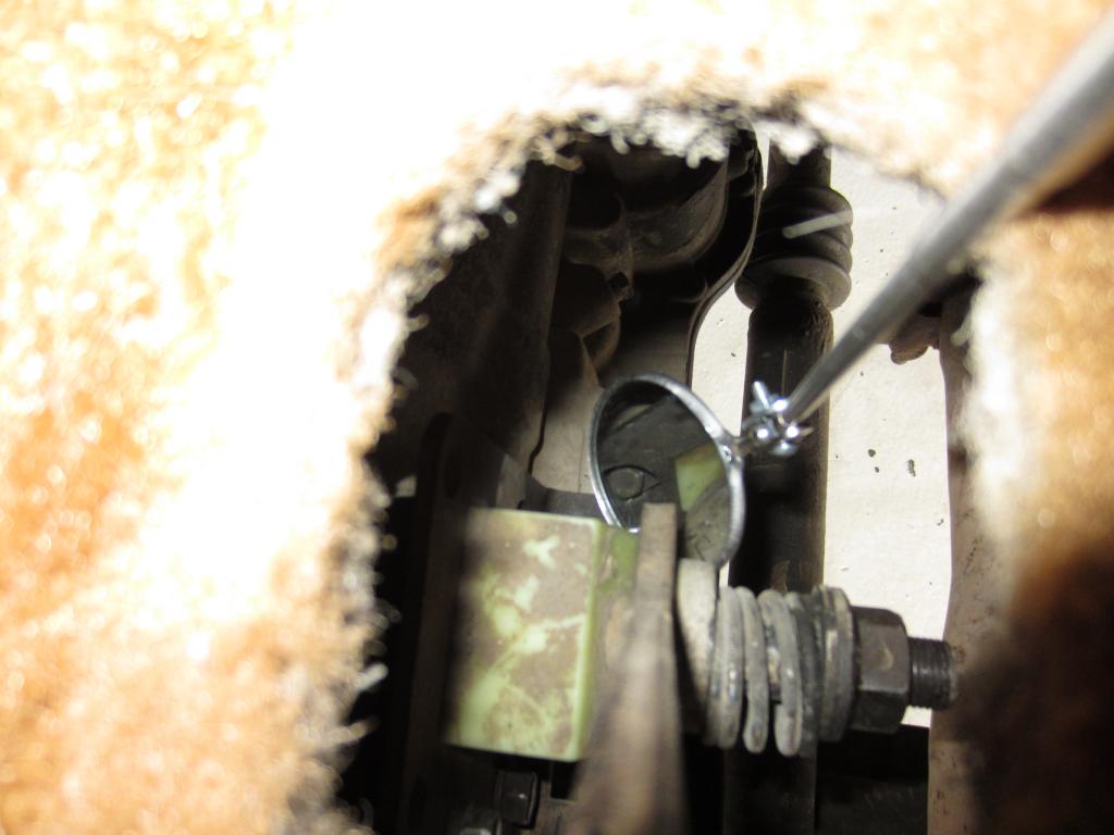

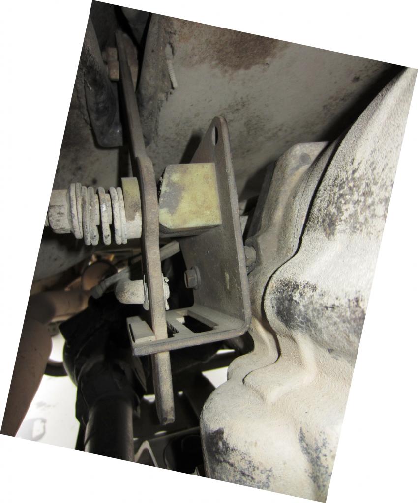

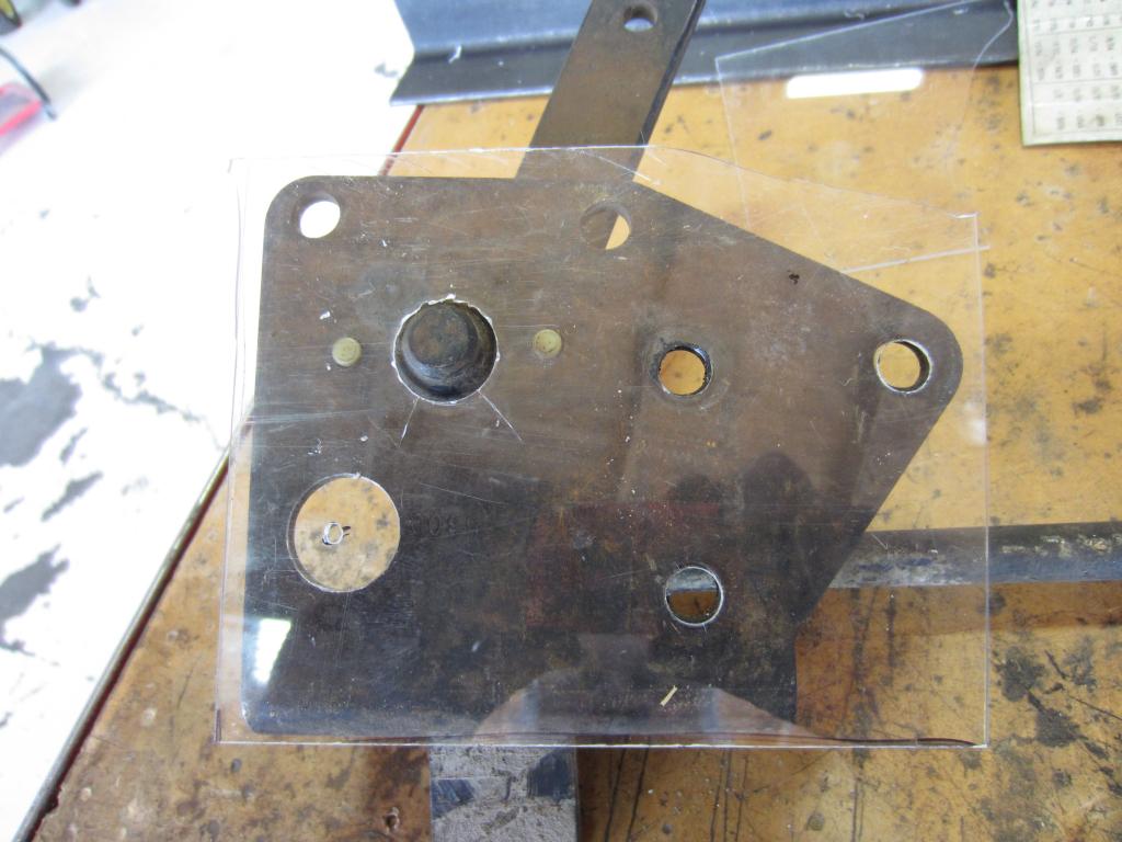

For those of us with 4 wheel drive. Get yourself a piece of plexy glass to use as a template. Remove you transfer case shift linkage and put the piece of plexy in its place and mark the location of the pressure port plug. Transfer that pattern over to the shift bracket and drill a 1" hole were the plug should be and reinstall. I had to make (cut and re-thread) a close nipple of the correct length to put an elbow on. Then an extension to put the pressure switch on.

After running this for a while I discovered a little flaw with it. It doesn't like extreme cold. The simple solution was to install an on-on-on double pole switch. In the center position it operated of the switch board as normal. If the switch board stops working for some reason, you now have a back up.

Couple of ?'s
How is this different from the potentiometer fix?
Do u have a parts list that u ordered...for the electrical impaired?
I didn't see one.
Old Dec 2, 2013 | 02:29 PM
cougar's Avatar
Joined: Apr 2009
Posts: 3,317
Likes: 485
From: alaska
The parts list is on the diagram. All you need to add is a generic patch board and an IC socket.
The "pot" assumes only the TPS is bad. If the PCM is bad or if you have a wiring issue, this will bypass all of that.
