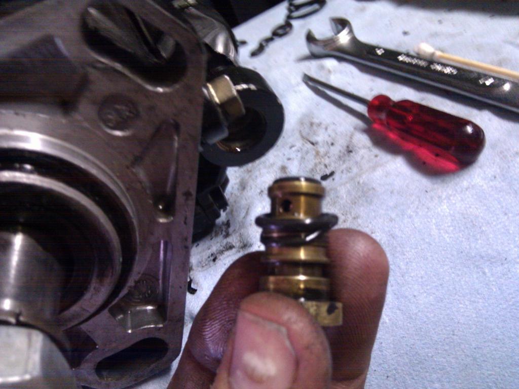

I thought for sure mineral oil would be good enough. The only reason I found out the huge head oring was damaged was because I told myself that since this was my first time, I'd better pull it apart and take a 2nd look. Otherwise I would not have known. It actually had 2 bites taken out of it. The second oring I damaged was the one on the kfb valve brass plug. The plug was screwing in fine then suddenly felt like the oring lost it's grip on the bore. It felt like it slipped. So I pulled it out and sure enough it was sheared big time.
When I hear back from the pump shop this morning I will ask them what they use.
Here are the pics of the damaged orings.

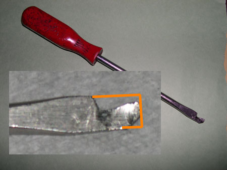

This is a tool a few guys have used to get the front seal out from the front.
