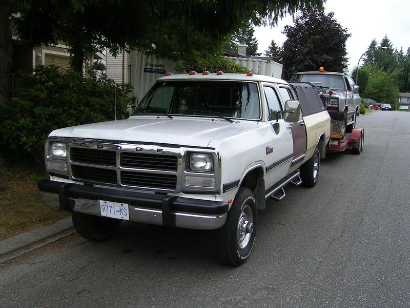

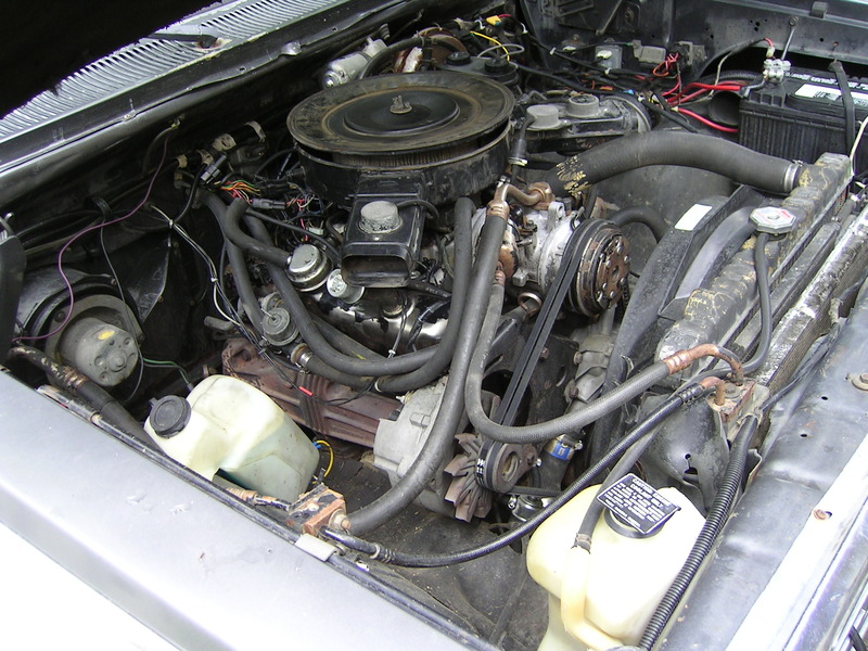

Done a bit of work on Sno Ball....got it brought across the borders and home, went very well with no issues.

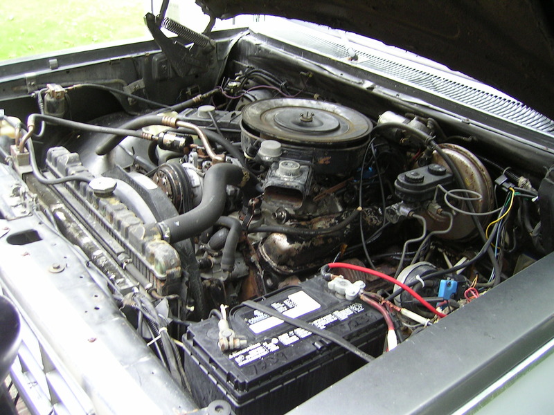

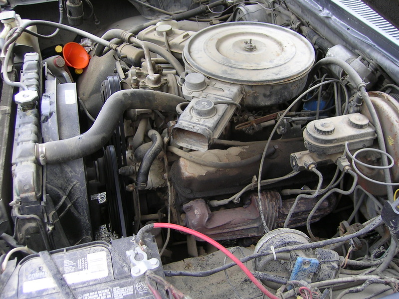

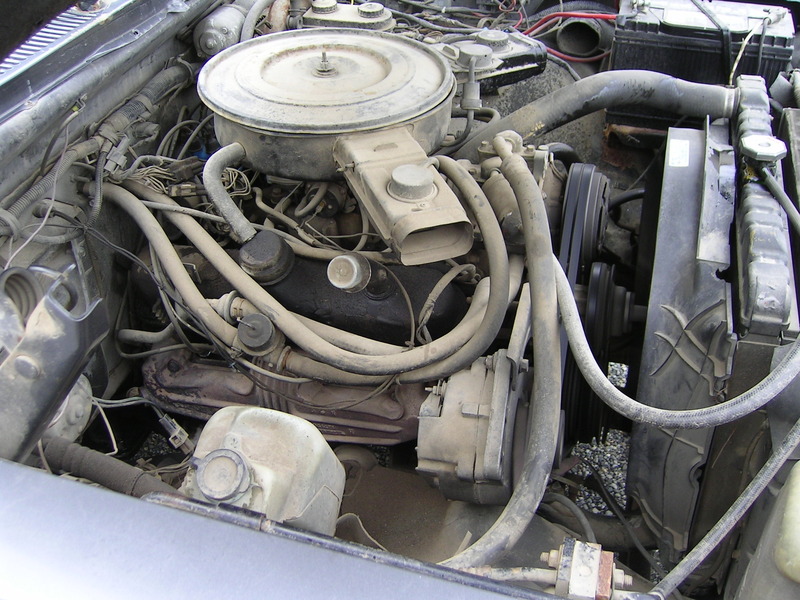

Then started doing some clean up.
Engine bay before.....
After.....

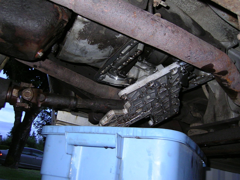

Once home I opened the tranny up and figured I'd do a band adjustment, filter change and replace the selector shaft seal.

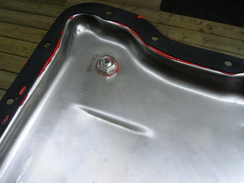

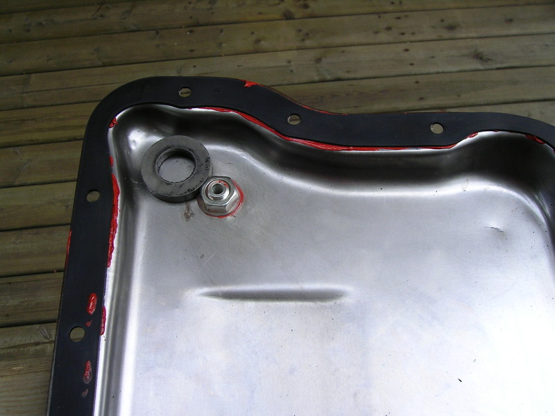

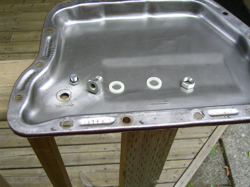

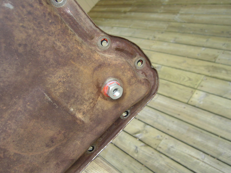

Also added a drain plug...as I always do. Usually get the B&M kit, but NAPA has the exact same unit for about half the price.
There is a small dimple where the magnet goes over to help keep it in place. I drill out the center of that to about 9/16, the hammer the dimple flat, then re-drill and install the drain. Magnet fits fine behind it and does not interfere with the dip stick.

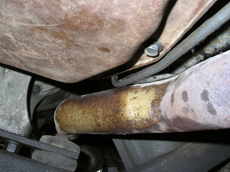

But I think I have figured out why the fluid smelled so burnt...at least once of the reasons...
Tranny line is resting right on the exhaust pipe! Some poor dual exhaust installation. Will see if I can adjust the pipe away, if not then I will install one of those heat socks you can use on spark plug wires if too close to headers or manifolds.

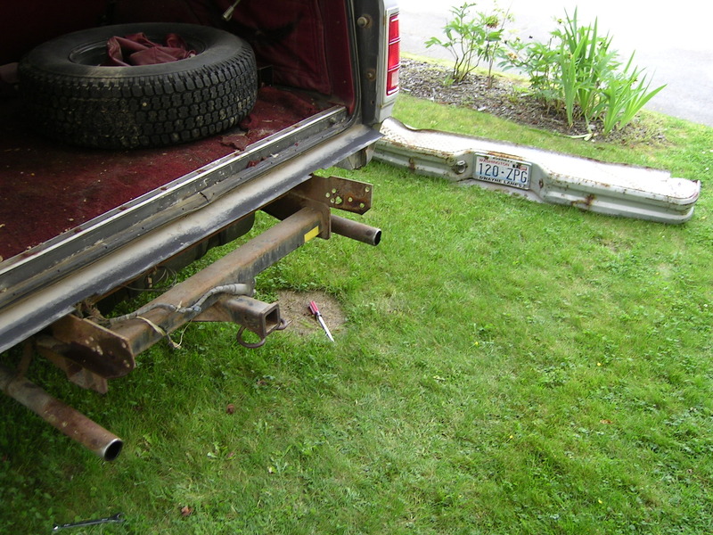

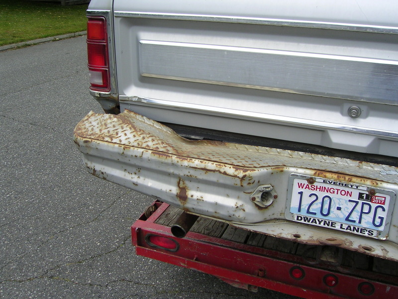

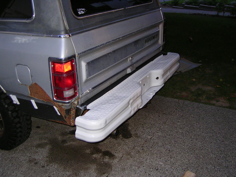

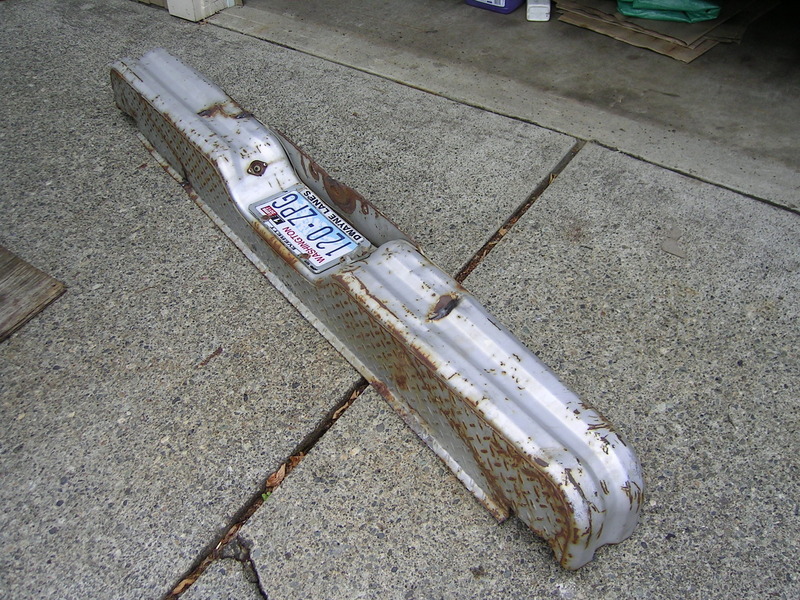

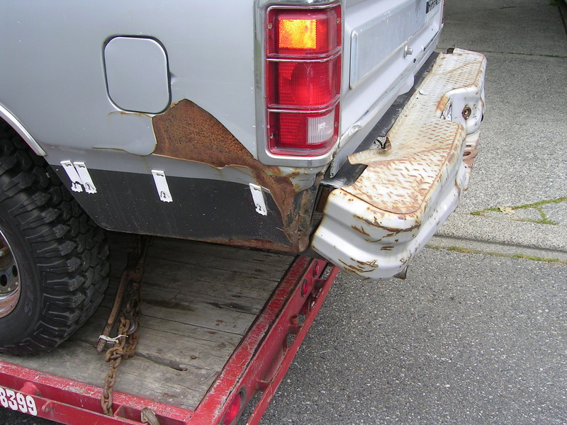

The rear bumper was bent up.....and because of that the rear hatch would not open.
So pulled the rear bumper....all the bolts broke which was nice. And got the hatch open.
My friend/neighbour and I beat the thing back into basic shape with some big dunnage, couple sledge hammers and hammer and dolly.
The bumper was pretty beat, so also required some re-welding.
Coat of light grey paint and installed it back on.
Not sure if I like the light grey...was looking for silver but could not find it in Tremclad brush on. Might re-paint it later, or see if I can find a more RC-esque type rear bumper.

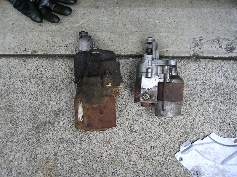

While was under the truck I had to pull the old gear reduction starter to pull the inspection cover to see if there was a drain plug on the torque converter...I never get one of those. Anyway since I had the starter out I figured I would toss that old 15lb beast and install one of my Junk yard high torque mini starters.
Haven't done much since then, other then order some needed parts, and dip into my parts stash for some more needed parts.

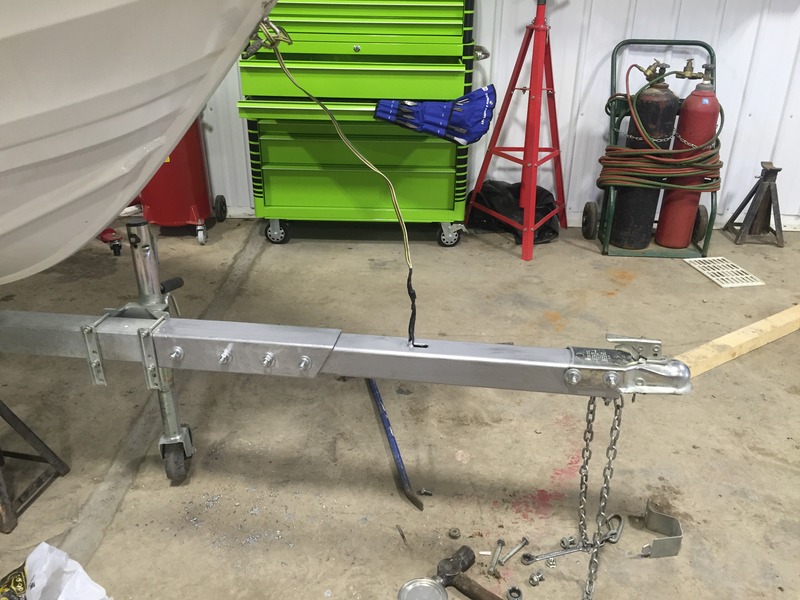

Tremclad aluminum might be what you are looking for, here's a pic I took while building a hitch on my boat trailer. The tremclad is at the front of the trailer. If not a Westin surstep bumper looks good on these trucks IMO

I know next to nothing about auto trannys other than adjusting bands. What is the silver plate hanging down and why? Can't you adjust the bands without taking that off?

That's the valve body. Not sure why he's got it a hangin.....

Yes that is the valve body, and it's hanging by the park rod, and it's hanging because you have to pull it down and swing it out of the way to replace the selector shaft seal.
Also if you can't find a drain plug on your torque converter, loosening, or pulling down the valve body will allow about half the torque converter to drain back through.
