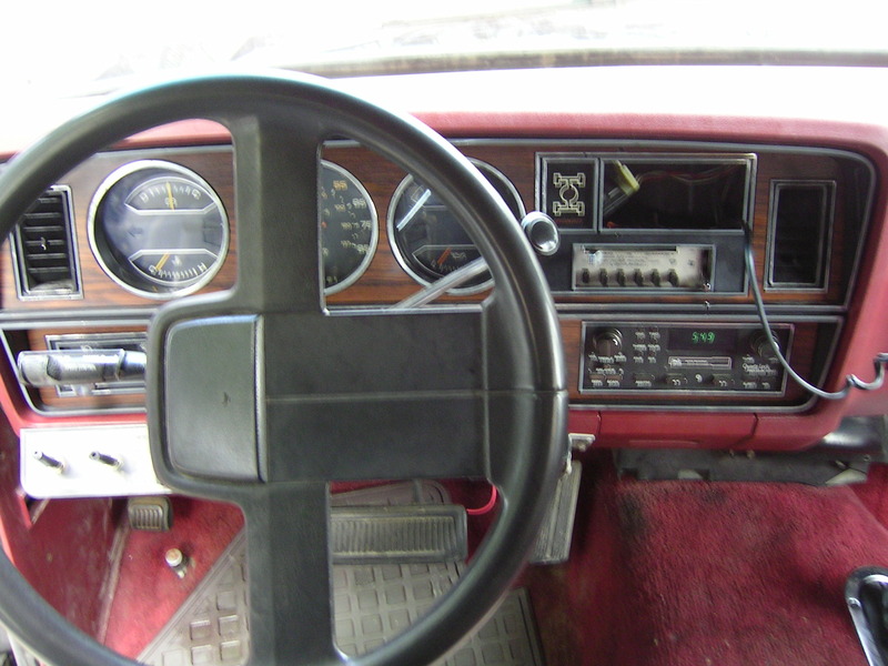

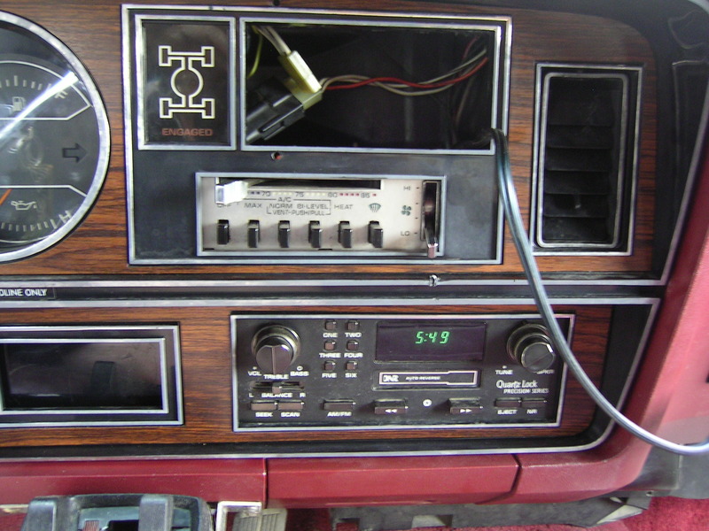

The Heater controls had been messed with pretty heavily....and had been HOT.

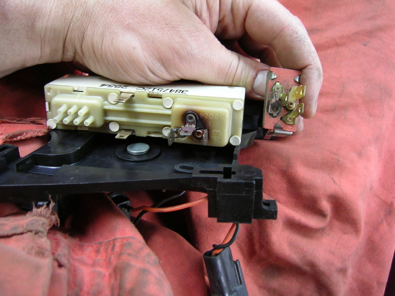

So I dipped into my parts stash for a few decent used parts. Used a control panel from a 80's RWD chrysler.....had to swap the temp lever, and that was about it. Works fine now....just looks a little off.

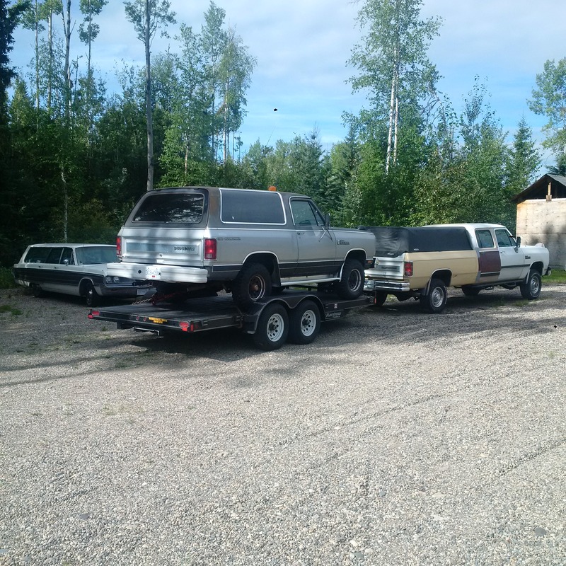

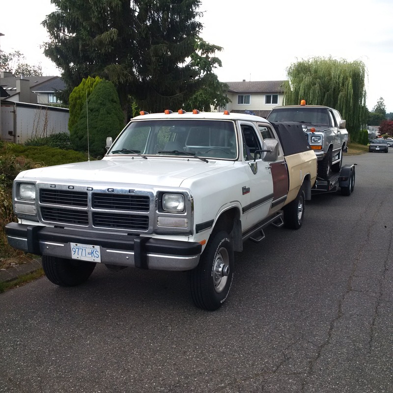

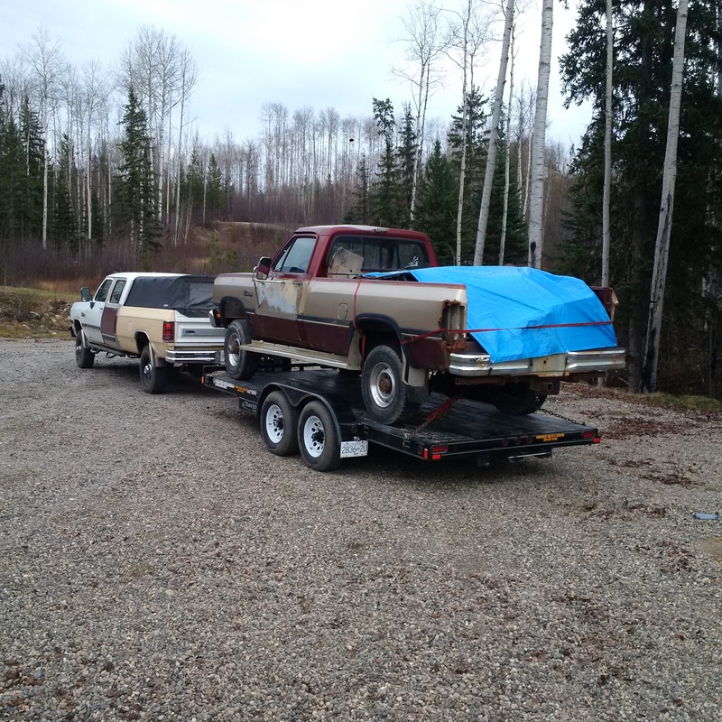

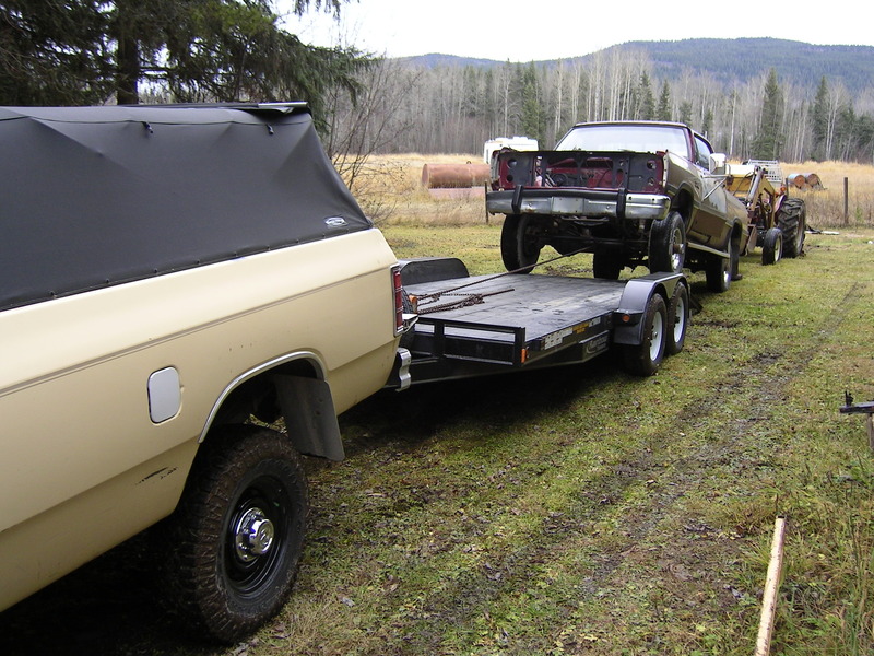

I passed my inspection a few days before we had to be out of the old house, so I insured it for a few months and parked it at a friends house until I could get back down to bring it up to the new homestead.
Couple transport pics....

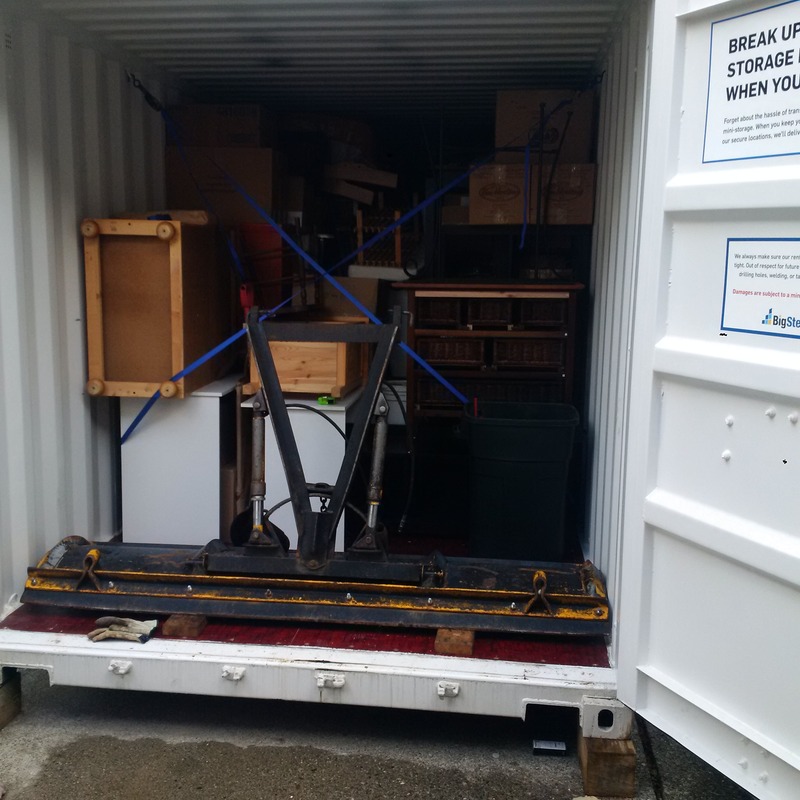

The plow I managed to sneak into one of the shipping containers we used to move all our household stuff.

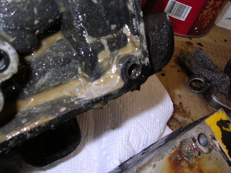

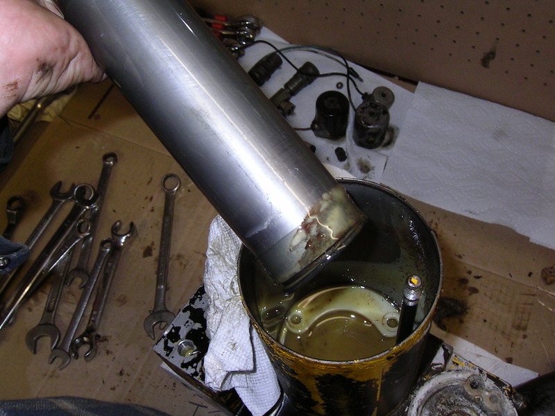

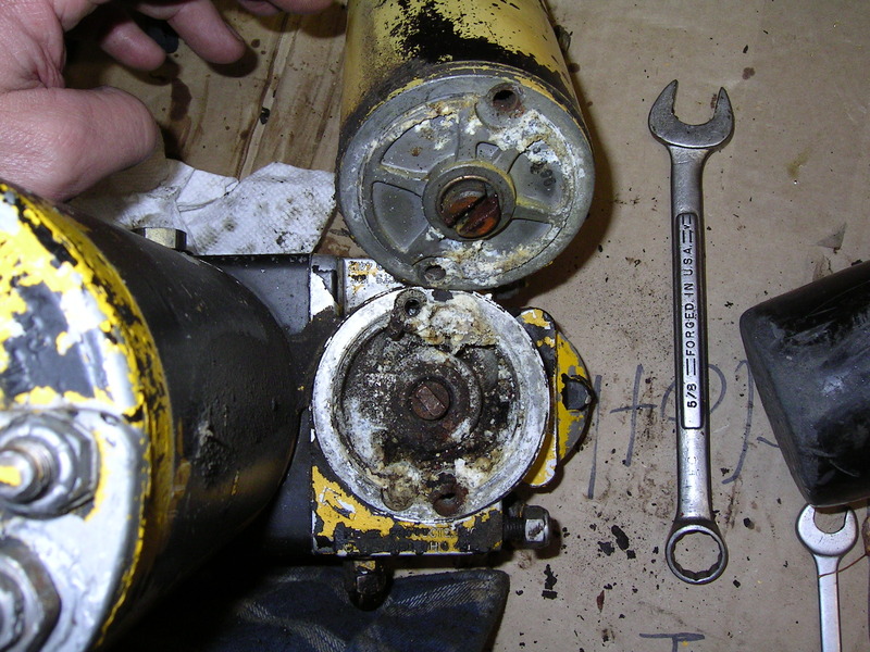

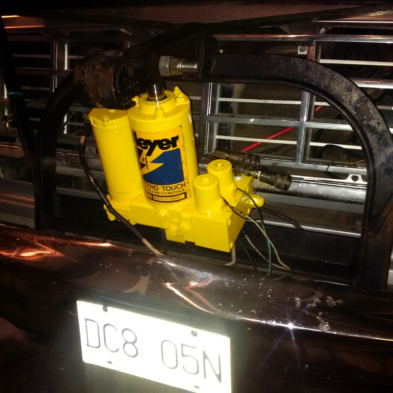

Once I got Sno-ball home I embarked on rebuilding the plow pump and other systems.
I used this site for the rebuild.....
Smith Brothers Services - Step by Step Rebuilding a Meyer E-47 Plow Pump

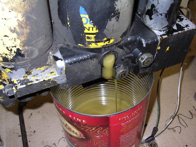

Draining out some of the nasty fluid...

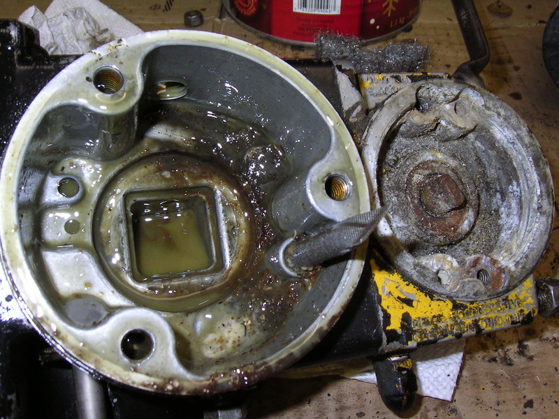

Some corrosion between electric motor and main body....

Some nasty sludge....
Lots of fine sand had made it between and into the parts and pieces....

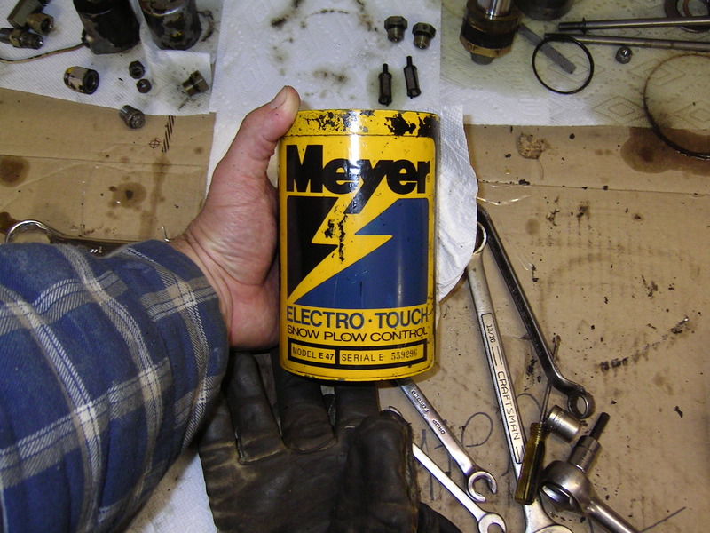

Used my fingernail to clean off the old black repaint to expose the original decal on the main body....

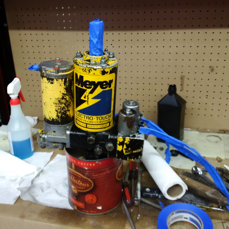

Pump all rebuilt and ready to be repainted and installed.
Went to the local auto parts store and bought a can of engine paint that looked close to the original yellow. Got it pretty close....looks much better.

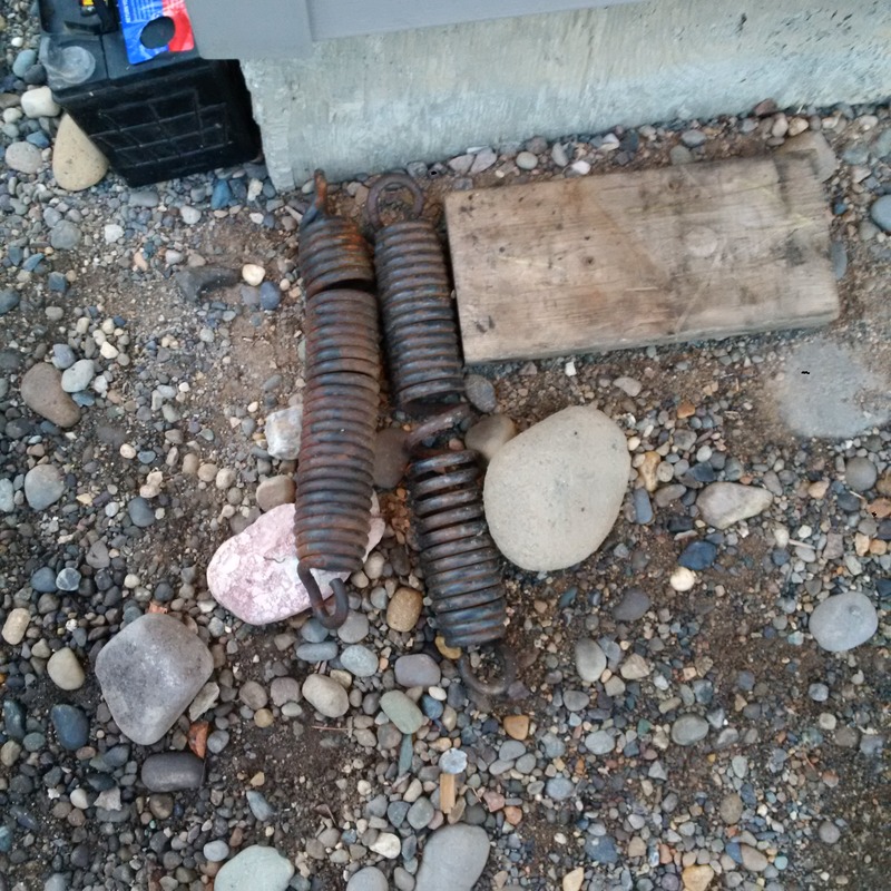

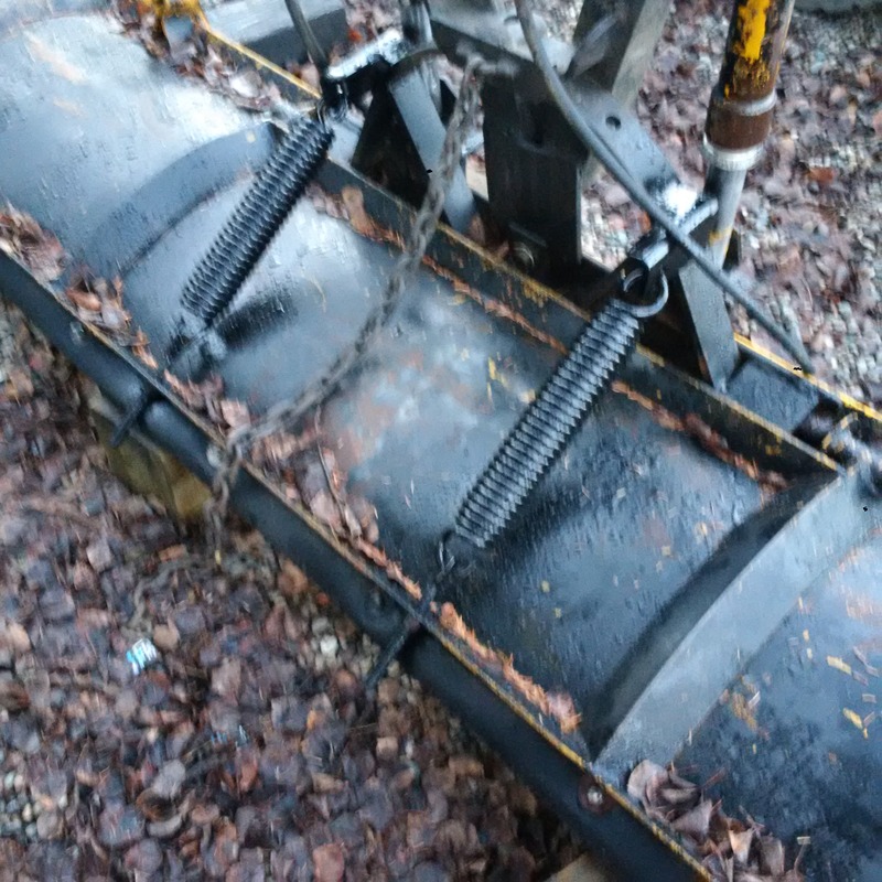

Replaced the trip springs....they were looking a little rough.

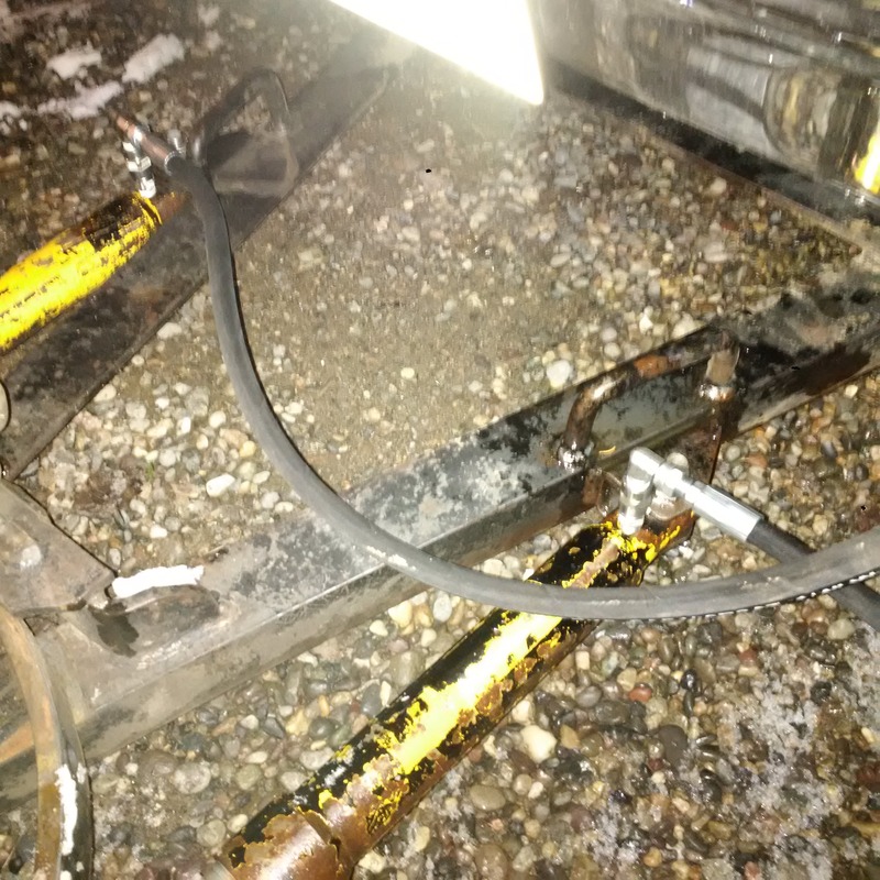

And some new lines and fittings.
When I first got it all back together I had no power to the main controls in the truck. Hunted and messed around with the wiring for several days until I finally started tracing wires and found that the power is supplied by the A/C fuse in the fuse panel. All the on-line wiring diagrams I found showed it powered through different fuses....depending on year. Tossed in a new 30amp fuse and it works like a charm now.

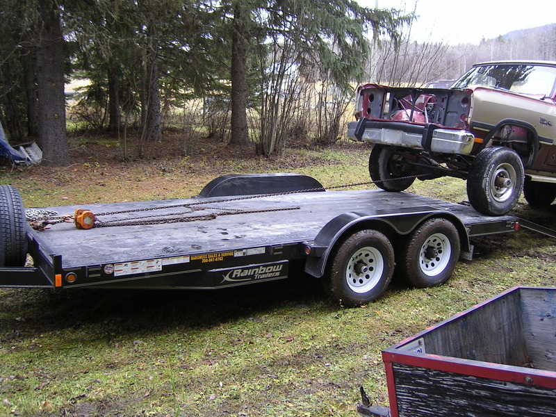

And then there is the purchase of the donor truck for the cummins conversion. Found a local guy who was selling just the axles....3.54 D60F and D70 from a 93 1st Gen. Called and he said they were still in the truck. Well I asked how much for the carcass and the axles....same price!
Tons of good parts still on the truck, and he tossed in a bunch of spare 1st Gen parts he had laying around as well. It was a pretty decent score!
Loading it up with the trusty old chain block....slow, but always gets the job done.

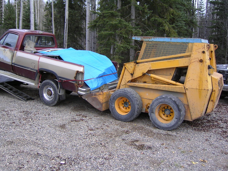

Unloading with my new-to-me Case 1845C....
