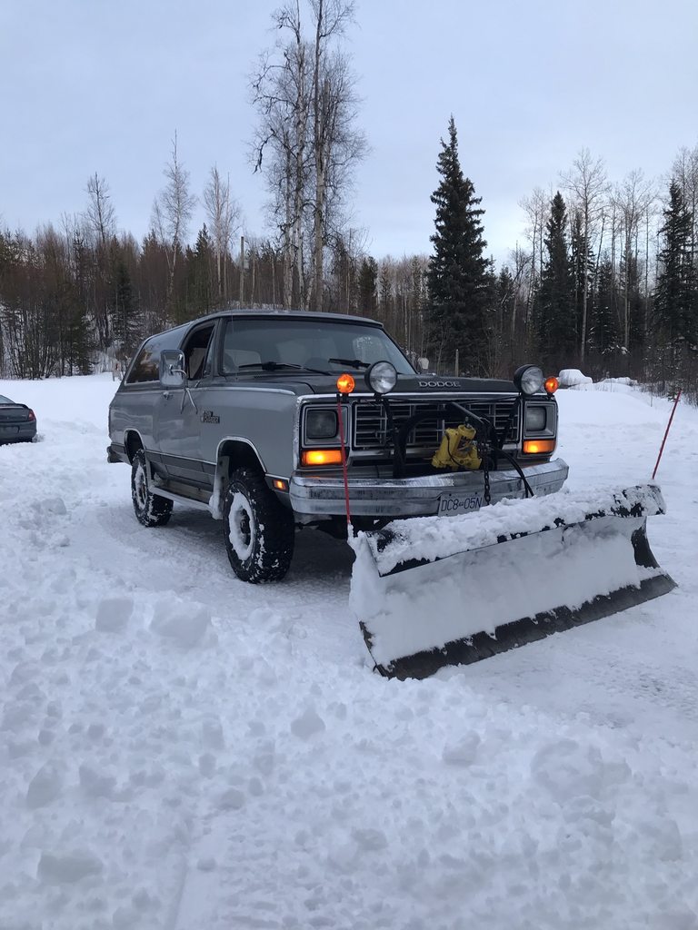

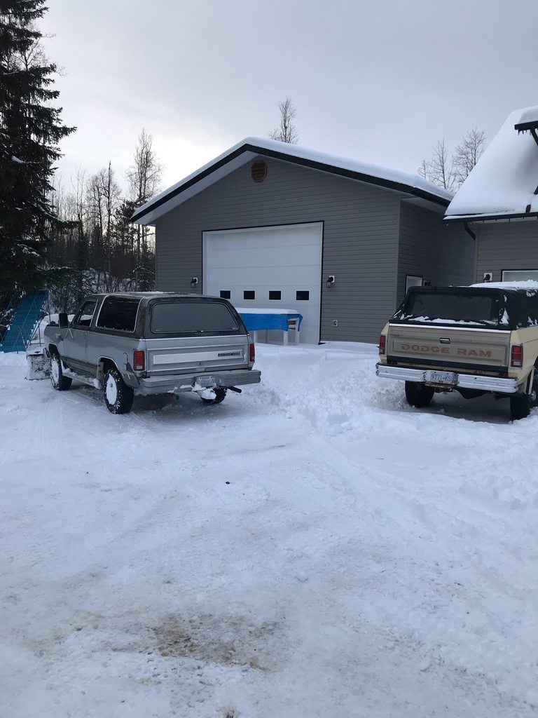

Was nice and cold last night...about -8*C and we got about 8-10" of nice fluffy snow last night, then it decided to warm the frick up to about +5 today...what the heck!! Regardless I had a bunch of plowing to do today.
Pics to prove it...
Ol' Sno-Ball is gonna need some love though, the water pump started leaking and then it started dropping tranny fluid on the ground every time I plowed forward, then paused while lifting the blade, then starting to back up. Thought it might just be a loose hose clamp, or fitting on one of the cooler lines but when I crawled under the truck it didn't leak....put it in gear and started leaking from the bell housing, guess the pump seal is toast.

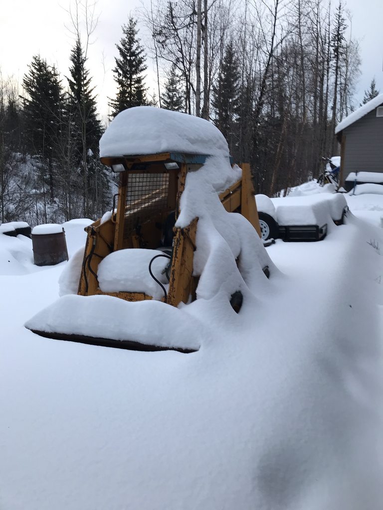

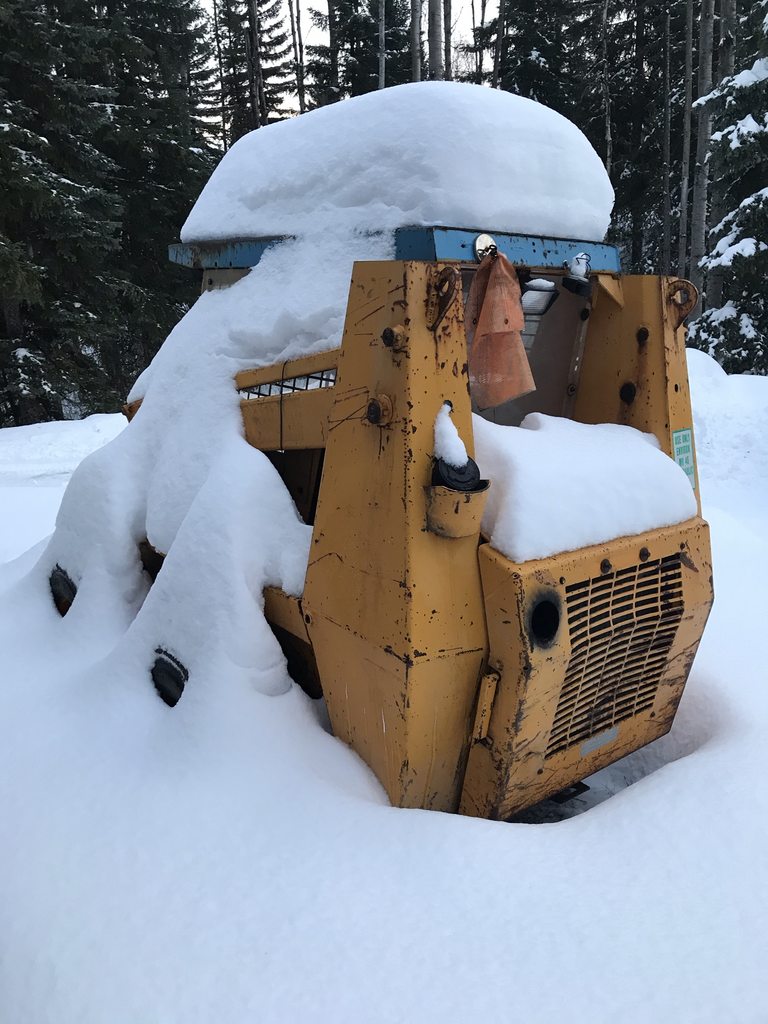

Because of the cold ground and then the melting snow the yard started to turn into a skating rink, Sno-Ball got stuck once and had to grab Patches to pull it to new ground. So decided to use the Old Case Skid Steer....but it was a littel buried.
Plugged the block heater in to warm it up while I was digging it out, then had to wrestle the chains on the tires. Went to fire it up and all I got was a clunk, clunk at the starter, gave it a couple hammer blows but still wouldn't turn over. Just sat there and twisted the key for a minute of two and it eventually turned over and fired up. Guess a starter rebuild is in the future.
