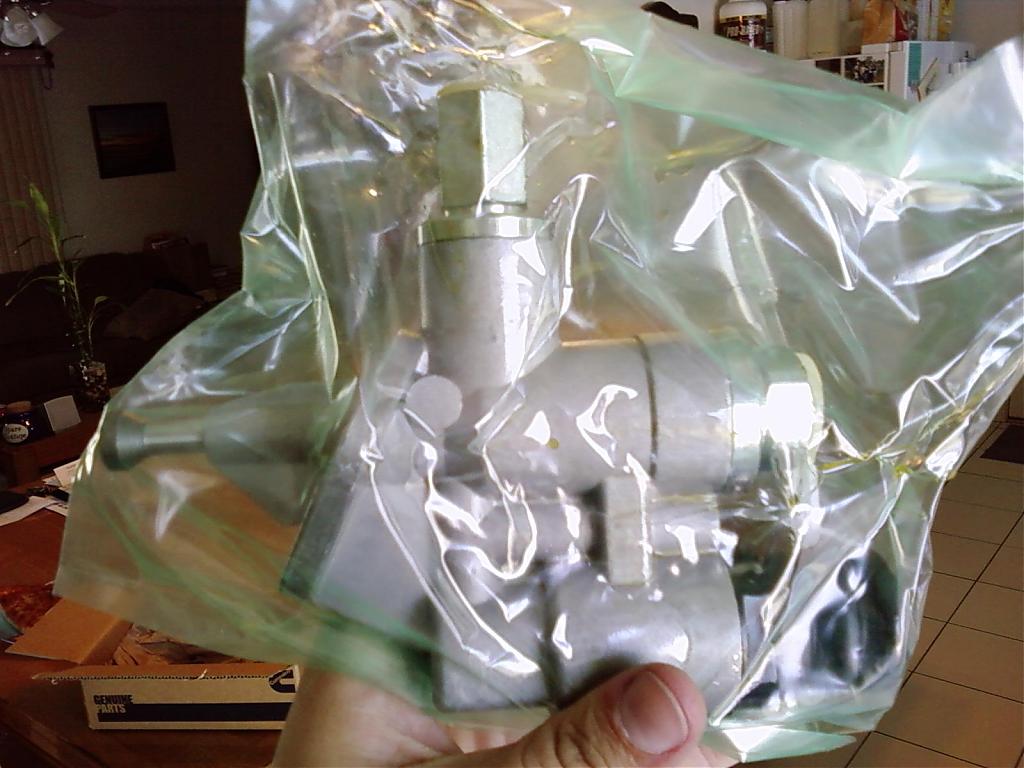

just getting back from cummins. $592 later, i have all the parts i need this piston pump looks huge!!! and a slight change of plans. i didn't think clearly about painting the head. i know it's probably gonna see 500* or more, so i grabbed some black bbq paint at home depot that resists up to 1200*. the valve covers will now be hemi orange as well as the heater lines, alternator bracket and other accents that might look good with black. mark and richard haven't returned my phone calls yet and i'm starting to get frustrated. is there anyone here that happens to know them and can maybe speak with them, please? i'd like to order the 370's but the longer i wait, the longer i'm without my truck. i'm probably gonna have to bite the bullet and order a custom set from bosch. i'd rather not spend the money, but if it comes to that, i've almost got no other options and i've gotta get this done!!
Attached Thumbnails progress update: 9mm head, 500K+ miles... no cracks?!-piston-pump.jpg
