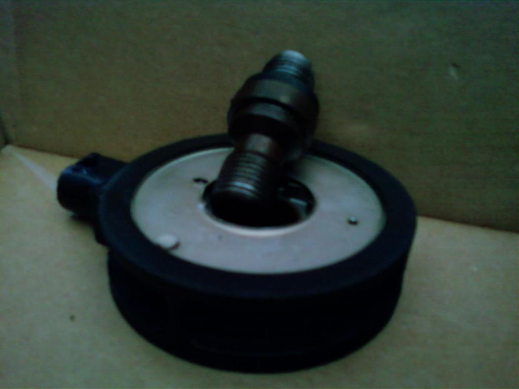

btw, is this a bad thing? the guys at the machine shop said they broke the heater loose, but the fitting would budge. so they chiseled it to motivate it and then it spun off. is it supposed to be in 2 pieces like this?

Yep. That's the fuel heater and the filter spud.
whew! had me worried a bit! how is the heater held in place when the filter's not screwed on though?
By the metal threaded spud. Make sure it is tight,mine always gets loose,so i have to get a long screwdriver to tighten it.
