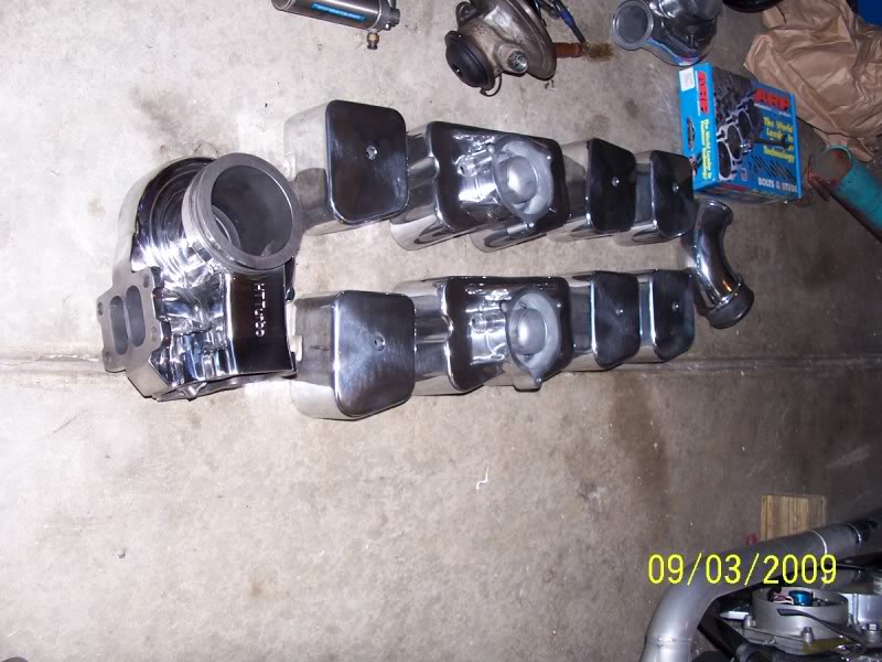

good observation!! yes i am. my inners are new since they were once mounted on the fronts and were removed soon after due to feathering. my grandpa told me they didn't wear well up front. he gave them to me earlier this year and i mounted them to the original stock steel wheels he still had. i had the tires mounted to the steels when i got them and put them on the truck back in june/july. still have the other inners in my backyard. my grandpa ran them at 80psi all the time, so the centers got worn really fast. then i got my hands on the truck and i only run 40psi in them when i'm empty as there's not much weight to be supported.
DTanklage over on cumminsforum had his valve covers polished not cheap from what he tells me, but they're nice looking!!
