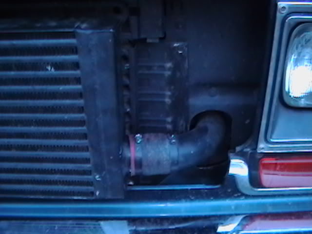

brandon, i snapped these pics of my i/c set-up for you. this is my tube on the compressor side. and also, the 90's off of the intercooler. small, i know

My 91.0 Banks intercooler that we sold to ''Mattster'' didn't mount like that, You actually had to cut the holes for the tanks to come through just like a factory 91.5-93 i/c

that's exactly what mine looks like. thanks for clarifying that richie! it only has 2 brackets that hold it in place. one at the top that bolts up under the hood release and another at the bottom that bolts to the bottom of the radiator support. my grandpa's had close to 30psi running through this thing when towing on grades. maybe a PS i/c should be on the wish list lol
