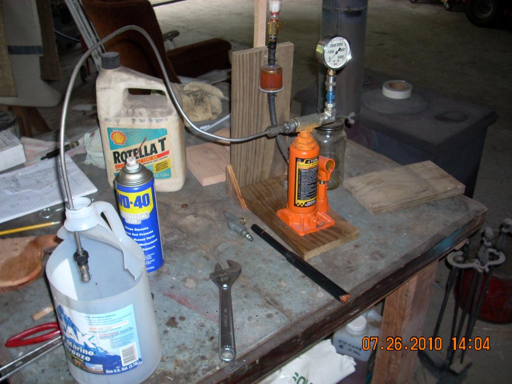

Legs's Avatar
Joined: Nov 2009
Posts: 8
My new toy
I made this ,found it on the internet,sorry don't remember where.Works good.I have done 1st and 2rd gen. injectors.
