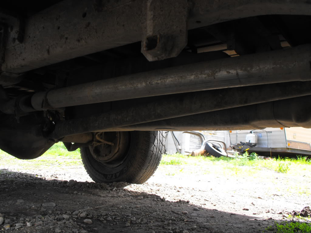

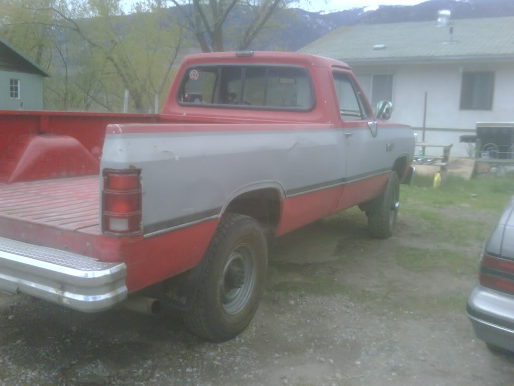

No clue why Name:  DSCF0083.jpg
there's the tail pipe by the tail light. Name:  IMG00120-20110503-1214.jpg
