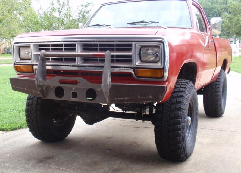

As for the front bumper? I am pretty much going to straight-up copy Eric Yate's front bumper of his truck "judge" as seen here:
I already got permission from him LOL,
. He even donated his extra pair of frame mount plates to the build. I personally think he really nailed a very clean looking design that compliments the factory lines of the truck. As soon as I saw that bumper when he first debuted it, I was in love with it.

My opinion on "rounded corners and edges" (hey, I am a VERY opinionated guy! LOL)
For one-off stuff, that means grinding the welds. That is a pretty big no-no in my book. It always bugs the dookie out of me when I see something fabbed up, and then all the outside corners are ground to have a radius on them. That means the material left behind at the apex of the radius is paper-thin.
I understand, some welds need ground for aesthetics. But, I (personally) will never grind a weld if I think it could possibly compromise strength.
I totally agree with what you saying. our local shop can roll corner rounds with there brake up to 3/16 thick metal. that way there is not but welds on the corners. they look similar to how the buckstop bumpers edges look.
