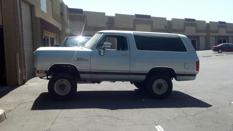

So, I had approval, and the hunt was on! I started scoping craigslist daily. It didn't take long before a super-clean, low mile 2wd 89' caught my eye. I was kinda thinking 2wd anyways as the suspensions are so much softer, the bodys are usually in MUCH better shape. And as I expected, that was true in this case. I figured it would be much easier to swap the tranny-tunnel (that gets covered up anyways), than have to deal with cowl-cracks, or worn out mody mounts, or any of that usual fun stuff. The rig in question only had 50,000 original miles on it. It really was the proverbial "old lady's car". I didn't even haggle with her! I paid the $1500 she was asking, and drove it 40 miles home.
Here is a picture I took in her driveway:

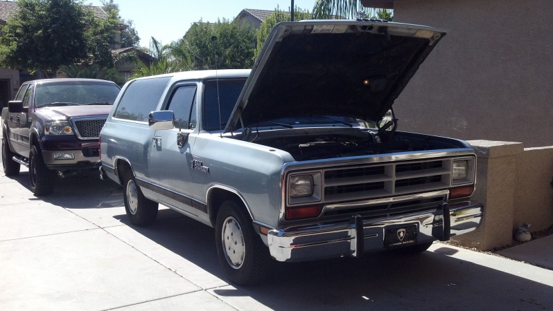

pretty freakin' clean! The paint on the hood/roof is oxidized bad. The paint on the drivers-side is oxidized kinda bad. And the passenger side is gorgeous LOL.

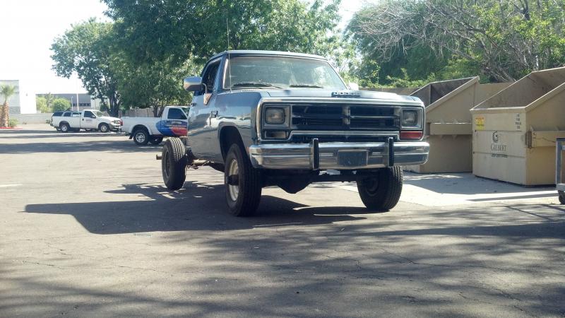

Here it is in my driveway an hour later:
You can see the effin' 150 gas-guzzler behind it. So, the plan was:
1. Cummins
2. 4x4
3. automatic
4. keep it very stock so that it is a pleasure to drive as it WILL be my daily driver. This approach will also maximize fuel mileage as I wont be trying to push a tall rig on big tires around.

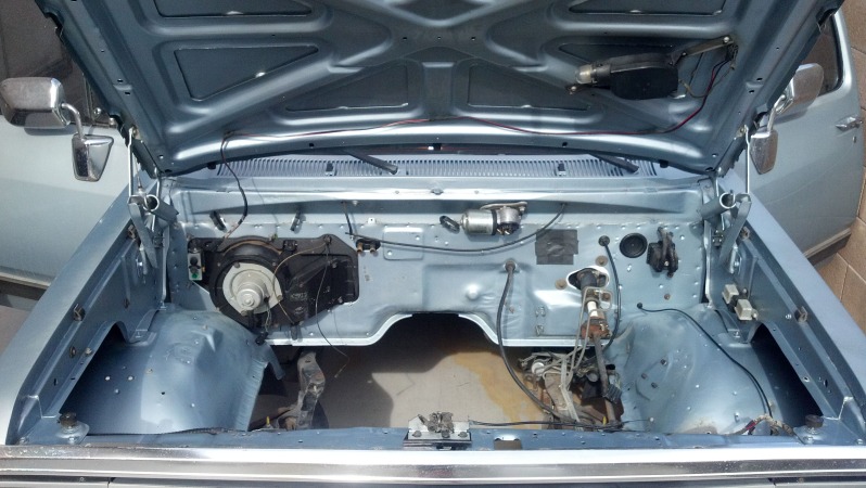

I left everything attached to the engine that was possible to leave attached. Just cut the harness 6" from the bulk-head, and right where the front-end lighting came out from the main harness. Ready to come out:
And out!
Then I proceeded to give the engine compartment a good scrubbing:

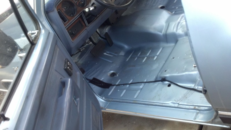

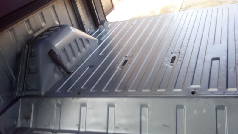

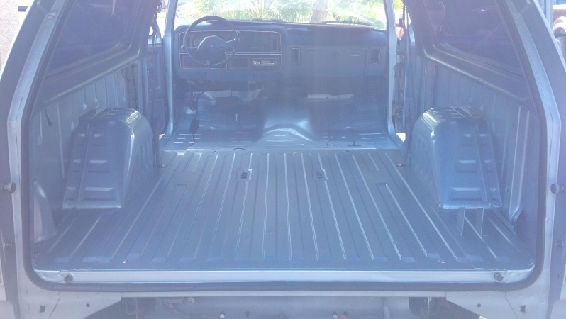

I was soooo happy with how well it cleaned up I just kept on going. Gutted the interior and scrubbed out the tub:

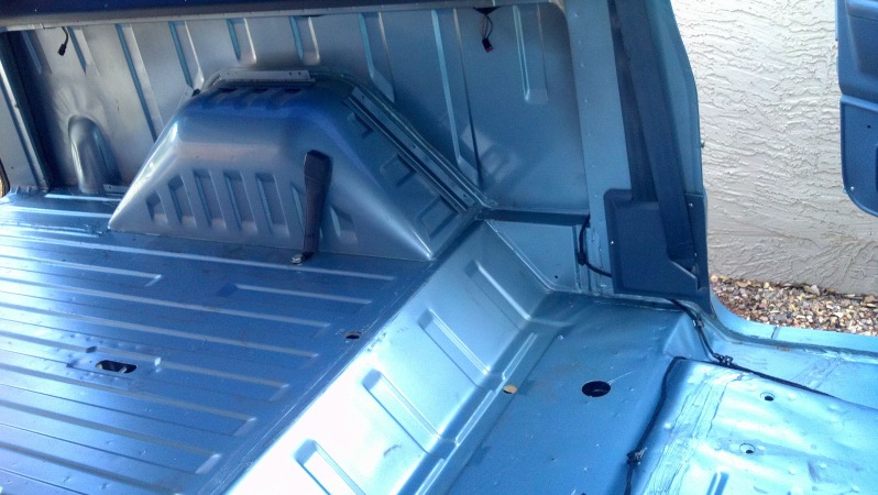

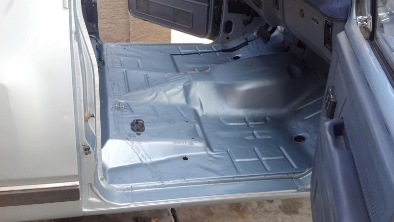

About half-way through that cleaning session it hit me! "hey! Thats a 4x4 tranny tunnel!!!!! WOO-FREAKIN-HOO!" That was a most excellent day all around. I had a bare clean canvas, that needed zero sheetmetal work. I could not have been happier.

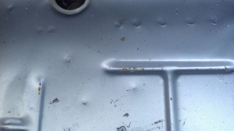

This is the entire extent of rust on the whole truck:
Seriously, that's it. Yea, I was jazzed.

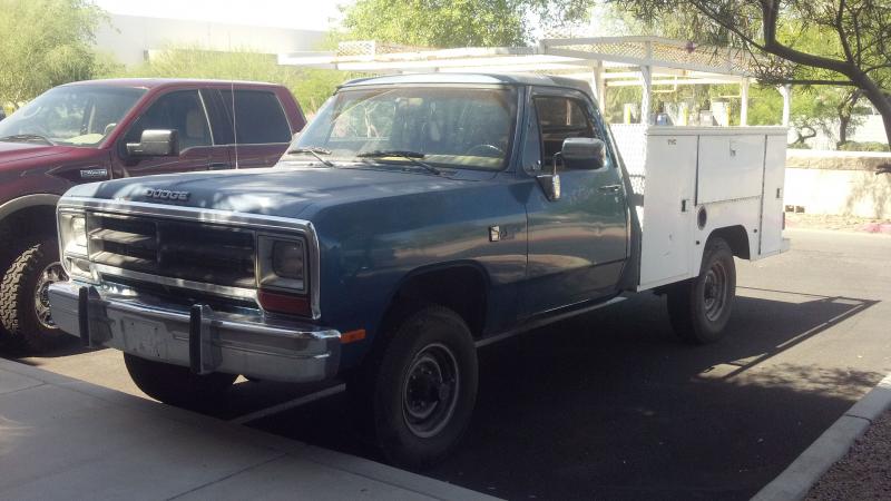

So, now I had Moonshine sitting behind the gate. And a complete, very driveable donor of the same year! This was good! As I was cleaning the glove-box out I found the reciept for the brand-new 10ply Michelins! They had a whopping 5,000 miles on them. Sold those right quick! Then sold the utility bed also right quick! I gave the cab to a guy in PA restoring his old Dodge (I think he is on here). And by the time it was all said and done I had about the same $750 into this:

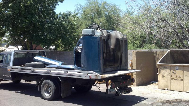

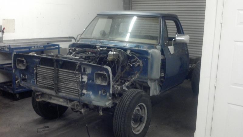

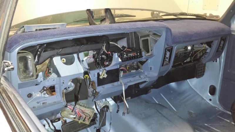

So, I did not have room for both trucks at home. The donor had to live at the shop. Where I proceeded to rip and tear. Here is the cab headed for the mopar nats. in Carlisle to be picked up by its new owner:
I have not talked to him. But what I know is his cab had a bad case of roof-rot top-dead-center of the windshield. I was glad to give it to him to help save a great old truck! And slowly but surely:
I kept on pulling a few parts here, and a few parts there:
Until I finally ended up with only what I needed tucked into the corner of the shop:

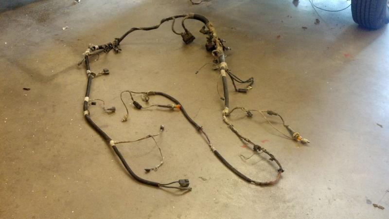

Unmolested under-hood harness! Not one wire has been cut. All factory fuseable links are intact. This might be the first one I have ever seen that has not been modified in any way. Dash harness was the same story. Here are both dash harnesses laid out to compare:
Only a few minor differences. Direct swap!

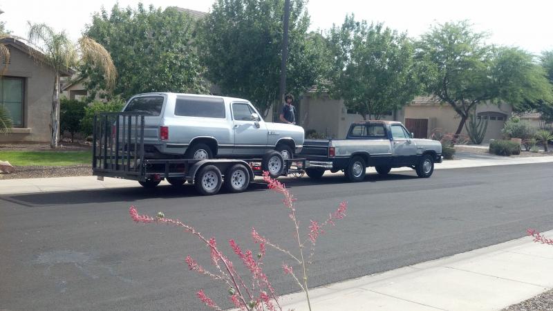

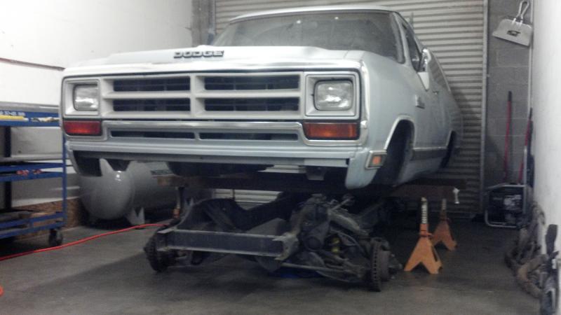

So, since The goodies were now tucked in the corner, and the bay-door was open again. It was time to drag moonshine to the shop. My buddy that sent me the text about the donor did the hauling:
Leaving the house. Now I finally have everything in one spot! At this point I have most everything I need to get the project about 80%, except time! LOL

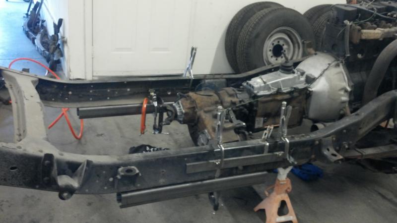

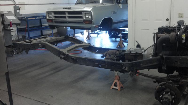

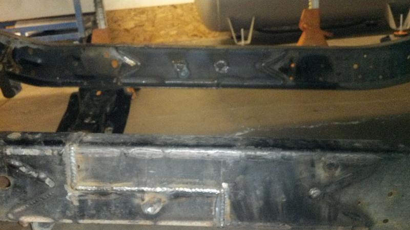

I decided to graft the rear of the Ramcharger frame to the front of the W250 frame. And it would prove to be the smartest decision I have made during this whole project! It was easy! What would have taken me several weekends of crappy work, only took one long weekend! Here it is all mocked up:
Measured about 100 times. (I have factory sevice manuals for both trucks) My initial cuts put me perfectly square, but about 3/16" too long. So I tore it all back down, and trimmed. Somehow ended up with an 1/8" gap on the rear vertical seam on the pass-side? But, it fit up perfectly square again. Was a cake walk to get level. Measured corner-corner in several different spots. all easily within 1/16". Checked length one last time. And welded it up!
And the splice:
After the initial welding was done my argon bottle was down to 100lbs, so I called it a day. Still needed to cut and weld the fish-plates. It would have to wait till next weekend (which ended up being about a month away LOL). And, that was worlds easier than swapping the 4x4 stuff to the 2x4 frame. It really was not hard at all. Very glad I decided to attack it this way.
And the splice:

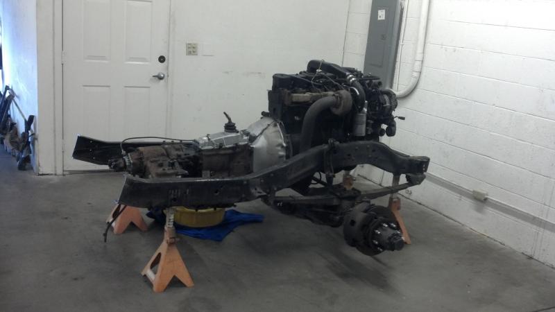

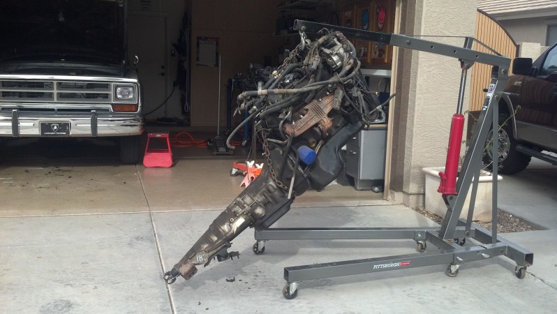

After the frame was in one piece it was time to pull the drivetrain out of it. I pulled the motor/tranny together, and split them on the floor. I plan to crack the tranny open and go through it real quick. Getrags are soo dang easy to work on, and the parts are cheap. It wont hurt to freshen it up. After the drivetran was out, I eventually got around to those fish-plates:
Sorry, thats a crappy picture. But its the only one I have. Then I went and had a set of U-bolts made to bolt the rear axle up under the stock Ramcharger rear springs. Then bolted the body back down on the frame on top of brand new body-mount bushings. And eventually pushed it outside for a profile shot of what is now a 3/4-ton 4x4 Ramcharger. with the frame to back it up. not just the axles:

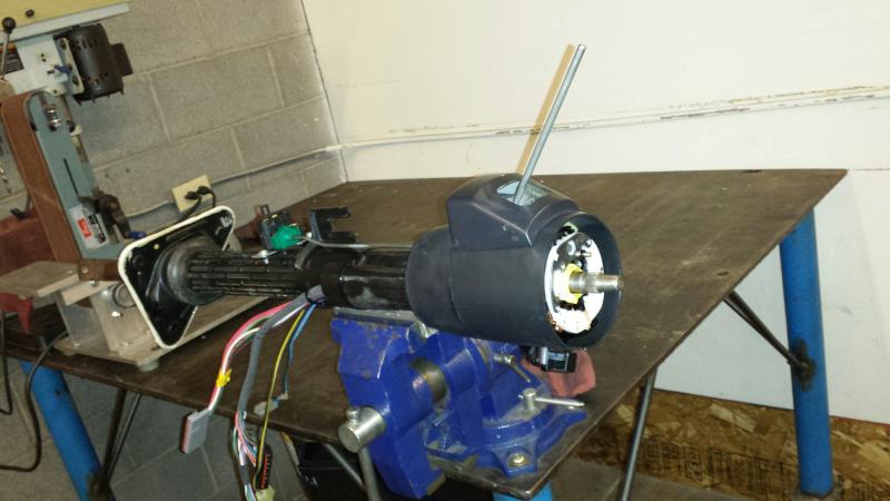

I hate that job! Glad its over. I also completely rebuilt the manual steering column out of the donor. It got NOS mopar turn-signal switch, NOS mopar delay wiper switch (which is actually the turn signal stalk in this column), new lock-cylinder, ignition and high beam switches. Completely disassembled, cleaned, repacked bearings, and meticulously reassembled. pretty much a brand new column right here:
