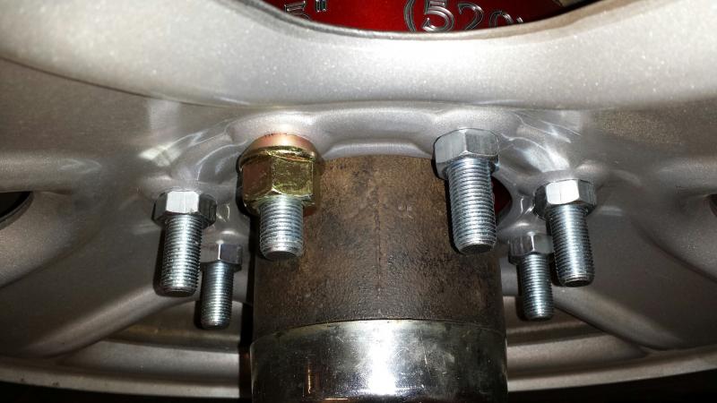

So, which lug-nuts would you use?
DUH! I know which ones I am using. So I picked up 32 of those at NAPA (ouch $$$). And I have 32 9/16" studs ordered to replace the factory 1/2" studs in the hubs. And I really don't like these cheapie lug-nuts that came with the wheel-spacers. So I will probably buy 32 more lug-nuts to hold the spacers to the hubs! LOL, Hey, if your gonna run wheel-spacers, you have to do it right!
