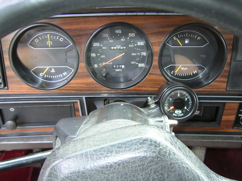

If you totally remove the column shift handle the collar that goes around the column will flop around. Mine was cut off even with the collar, so it still held things in "park" and doesn't move.
Here's what I did with my nubbin'.....
