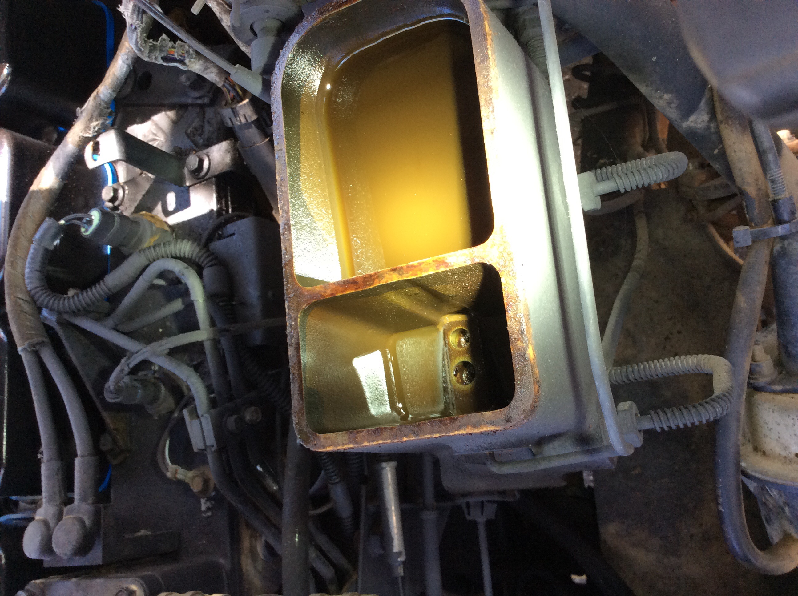

Well the tale unfolds on the brake light and ABS light being always on. Just popped open the MC for the first time since taking ownership. Funny thing, is it stops well, LOL! Gonna check a couple other items also besides flushing and refilling this out

That is some gross looking brake fluid...at least the little bit you have...

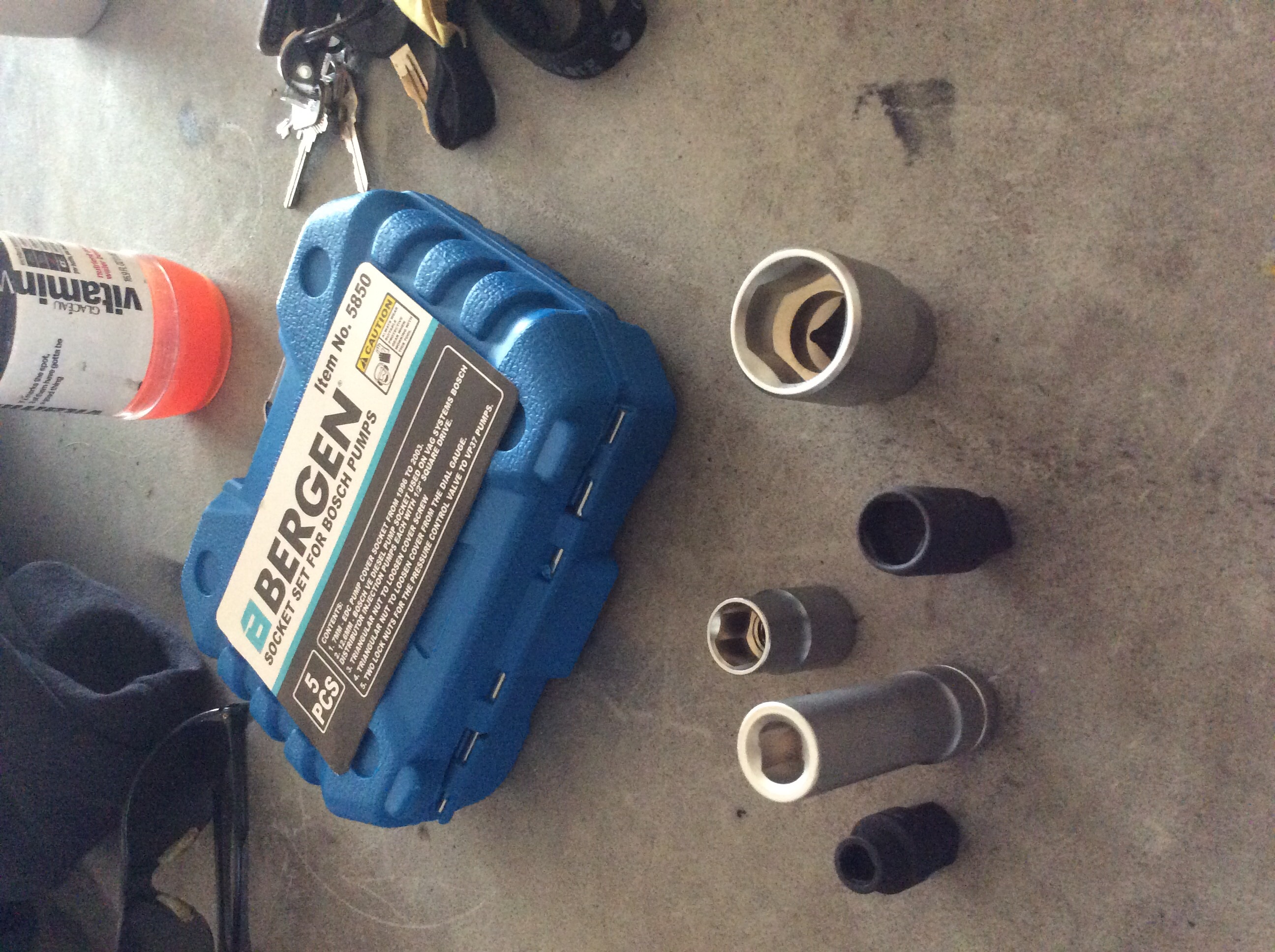

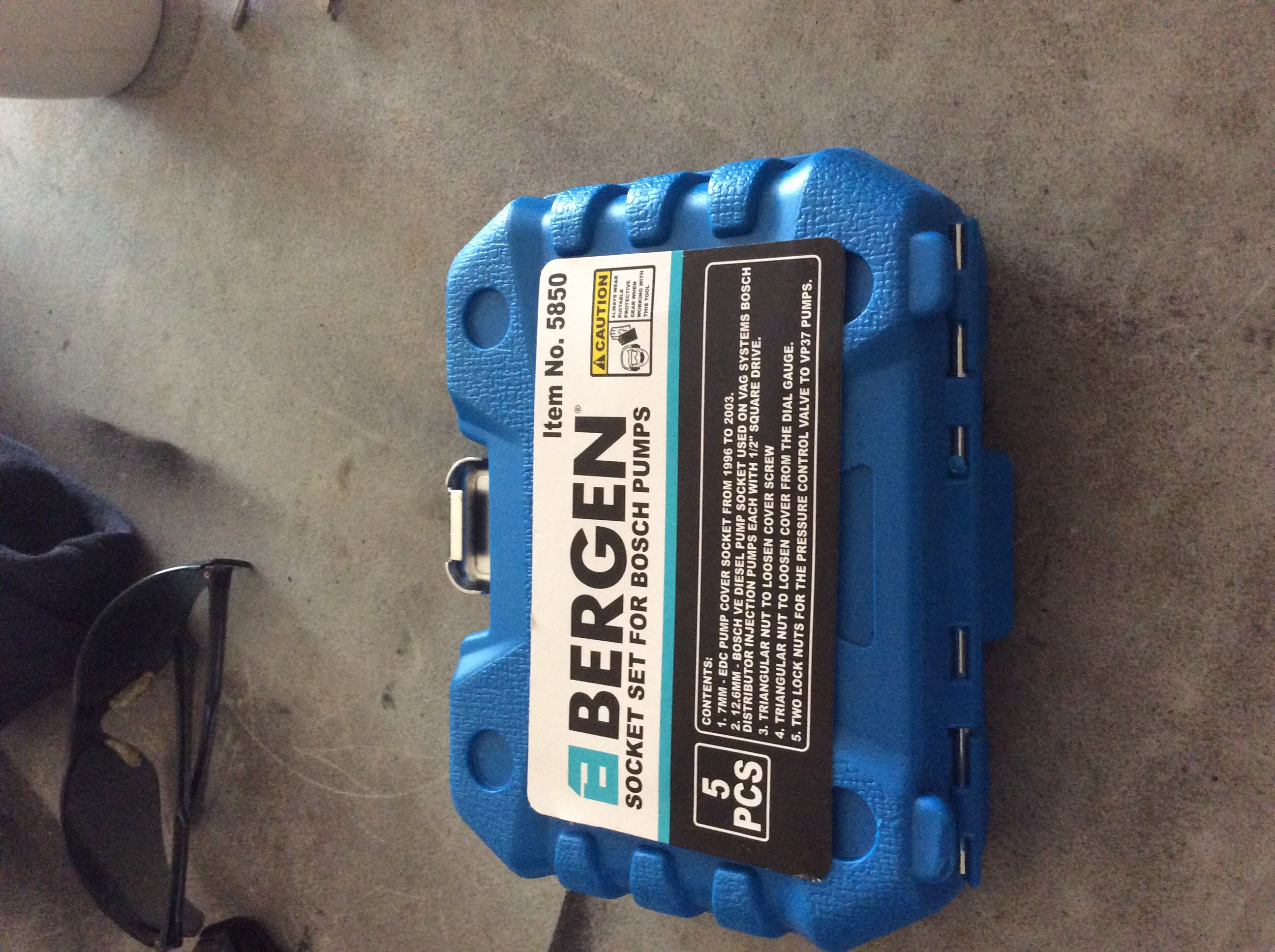

Well, just need to pick up a re seal kit, and tool wise, I should be ready. Found this kit on fleabay, sold by A.B.Tools Online. Not bad quality at just under $25.

Has four different sizes of sockets to access those triangular shaped bolt heads, and one to access an oval shaped socket. The two black sockets are 1/4" drive, the other three are 1/2" drive. Storage case is double wall quality.
Nice acquisition on those tools. I used a Gator Grip socket in a pinch on the triangle one, and it worked ok surprisingly.
