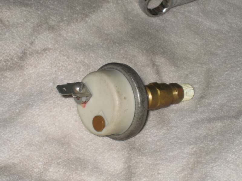

Here is a similar switch that I used for my starter interlock,
And here is the Hobbs Switch that I replaced it with, they are much more reliable.
And yes you need to make sure you have a healthy fuel system or the light might be on most of the time.
