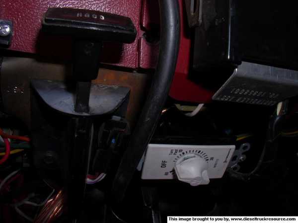

I just installed a countdown timer made for hot tubs under my dash so I don't have to sit in the truck forever watching the temp gauge. I just ran a hot from a non switched battery source to the switch, and the other wire to the fuel cutoff solenoid. All you have to do is turn it dial past 10 and back down to a few minutes, turn off the key and leave. (I also chock a tire because my e-brake is totally messed up and unreliable).

Crude but effective. I like it!
