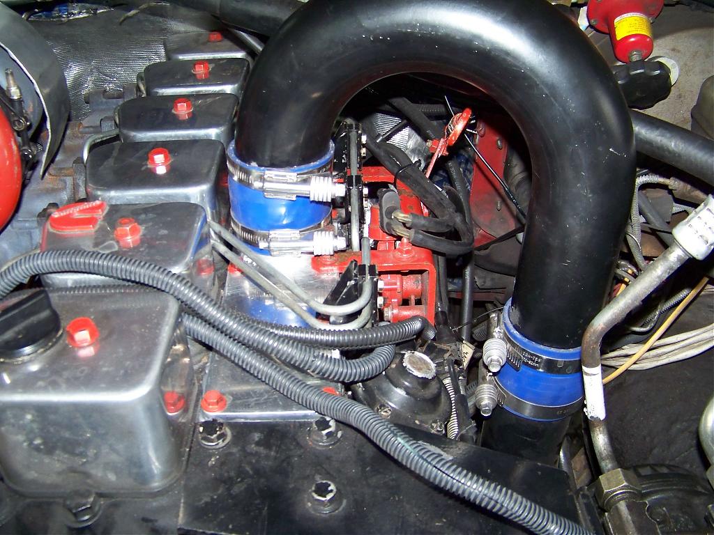

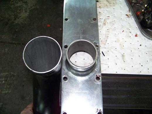

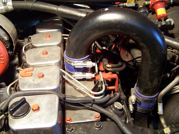

So Thanks to Soggy and the great job that he did on his intake I decided to have mine redone as well. When I did the swap, I used 3" Intercooler Piping, but when it dropped into the intake it is restricted down to a 2 1/4"ID intake manifold Inlet.
I have a buddy up the road from my lot that owns a welding shop. He took a look at it for me yesterday and said that he could fix it. So I got the intake off and will be taking it to him on Monday along with pics of Soggy's and well see what he comes up with. Even if he can replace the 2 1/2" id to a 3" that would be a big inmprrvment.
Here are some pics so far, well update when I get it back.
Attached Thumbnails Intake Horn Restriction-102_5840.jpg   Intake Horn Restriction-102_5841.jpg   Intake Horn Restriction-102_5842.jpg

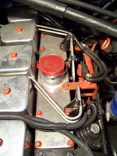

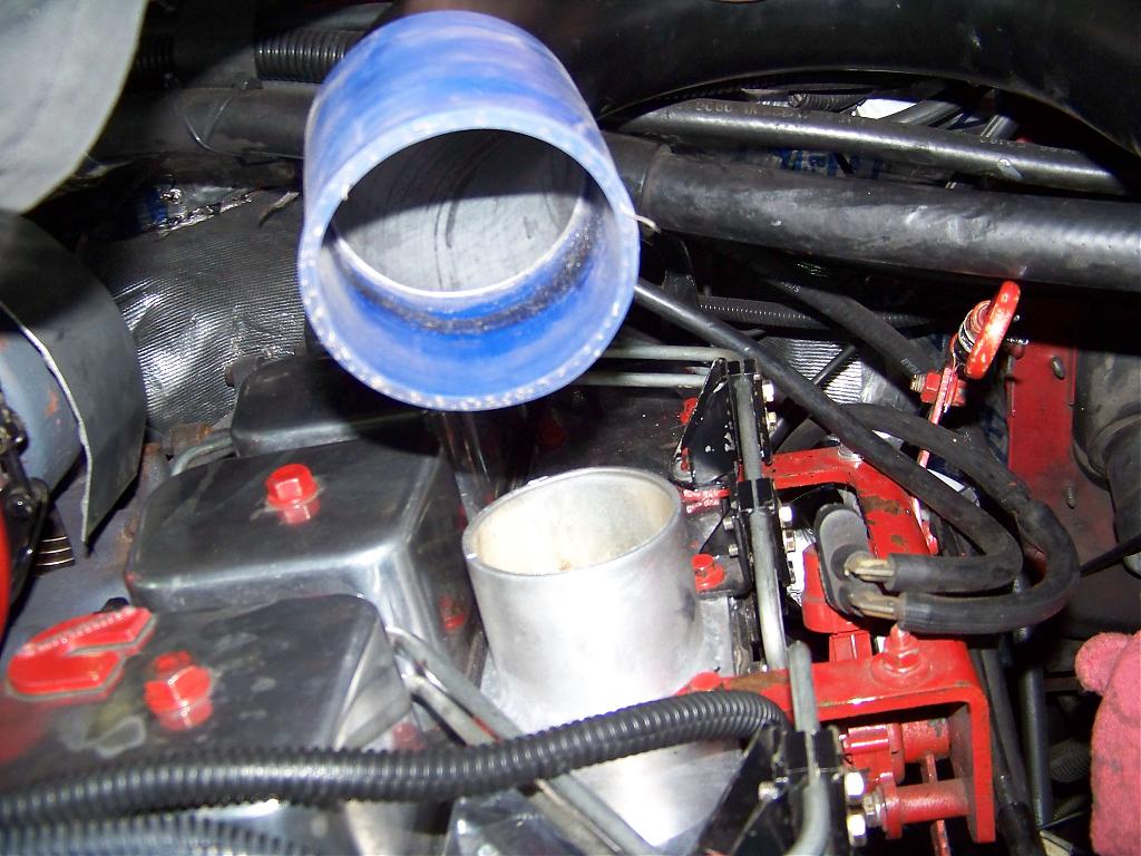

My point was the intake inlet itself had an inside diameter of 2 1/4", and the intercooler piping is 3". So I wanted to have the intake inlet redone with a 3" intake so there would be no reducer, or restriction.
So I got it back and it is now the same size as the intercooler piping, not much to show but here it is. Just what I wanted.
I realize that any restriction is bad but to you think this will make any difference? I honestly think it is not a difference that i will actually feel,.
