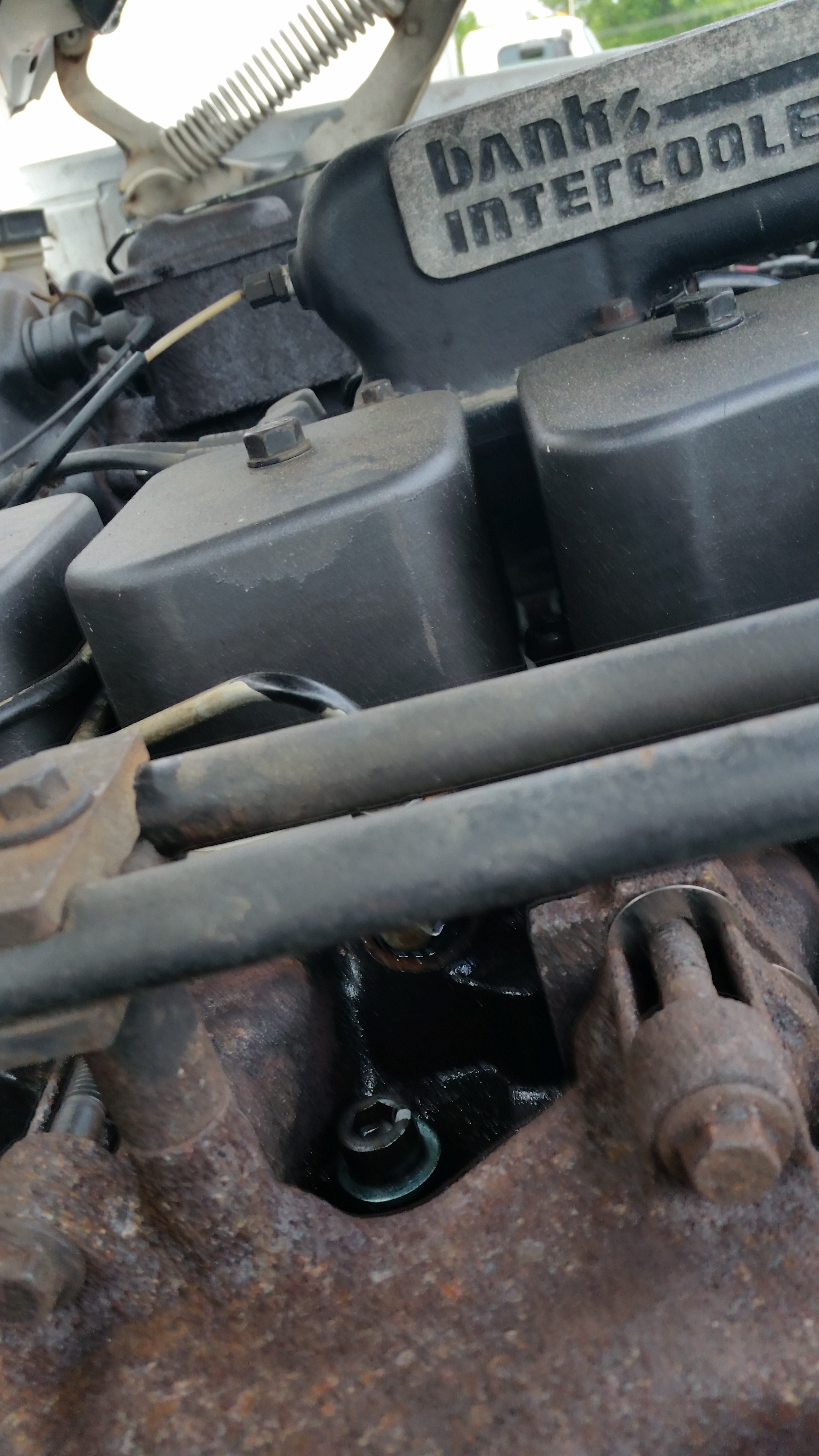

Hey Guys ,
Thought it was time to get some opinions.
So I have this injection leak that's shooting past the debris o-ring on the injector body and hold down nut.
9mm injectors non I/C style.
Just did the head about a few months and still cant get this thing to stop I've tried cleaning the bore again after the machine shop did,
checking the injector bodies and even re-torqueing the nuts and setting thing back in place. I think there is a variance in the thickness of washer used in the bore as I did not use a Cummins copper sealing washer at the base of injector instead I used an AG supplier item. All suggestions appreciated.
Thanks.
ZARR

fuel or exhaust I Can't tell by the pictures

Fuel if you look at the first picture right at the injector base you can see the fuel soaked area. and down from there.

The copper seal keeps combustion gasses in the cylinder. It has nothing to do at all with keeping fuel oil in the injector. There is a threaded joint in the injector above the copper gasket and below the hold down nut that can leak. If it does, it comes out around the nut or past the dust seal.

Its most likely coming somewhere on the Injector one of 2 things the nuts loose or cracked with a cracked you can't torque the nut and it will leak or the main injector body has something wrong like crack or hole in the main body seen both things when I worked in a fuel Inj shop ken

Thanks for the information guys, j Martin I have not replaced the injectors, and it does seem as if there is a pressurized hiss coming from 1 of the injectors. I think to rule out all issues I will remove the injectors and get them rebuilt its become too excessive of a leak and noise, and I honestly think you guys are right on the money the dust seal are blown out from around the injector and nut area and the hold down nut is filled with fuel.

A trick to help pinpoint the source. Use some carb cleaner to thoroughly clean the area and make sure it is good and dry. Dust the area with talc. Start then stop the engine. The talc will wick up the fuel at the source and show you exactly where it is coming form. Found some cracks that way.

You don't have to overhaul it to fix a leak. Buy 1 or 2 injectors and throw them in. Even if they don't exactly match what you have, (injectors get a bit bigger with age) it'll probably be so close you can't tell.
The hiss is probably the copper washer. Wire brush the hole and replace the seal (washer)
