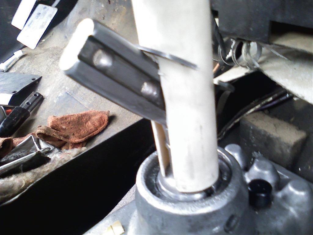

Im working on pics now.. I was just so excited to have found an easy way to do it that i had to share. I finally came up with a method that my scrawny self can use to mess with the shifter. I can have the shifter out... then back in just like that.
Old Mar 4, 2009 | 06:23 PM
Bogurt's Avatar
Joined: May 2008
Posts: 166

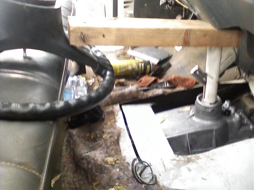

as you can see, it is regular 1 inch pvc with a slot in it for the shifter. It (the pipe) extends to the bottom of the dash. to use the tool, i press down on the pvc, and insert a 2x4 between the dash and and the top of the pipe to hold the shifter in place. takes less than a minute.

Where did you get that shifter base? Mine is threaded, and the shift lever threads into it.

I think the getrag shfiter design changed to what you have in like 92

Great idea, I wish I knew this when I was doing mine.
Thank You.

the donor truck for the shifter base was a 93. that was my 89 in the picture with the hole in the floor courtesy of the previous owner.

heres what it all looks like. with the whole tool being used
