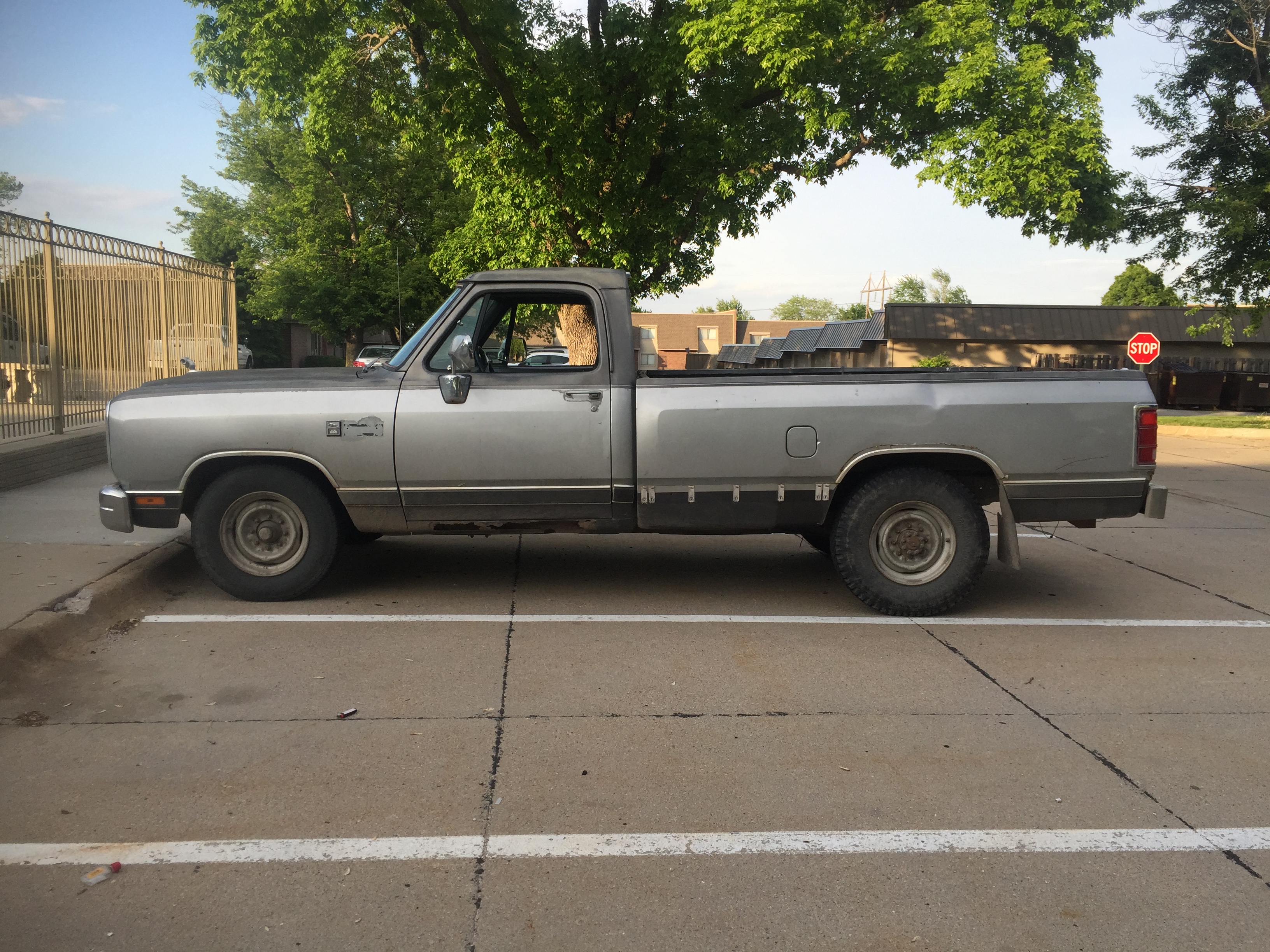

I have a 90 D250 that seems to be sitting a little low in the front. I attached a picture of it so you guys can tell me if its normal or if its time for some shocks and springs. There isn't a whole lot of the D250's rolling around here, so not sure how they normally sit. There is a good bit a rattling coming from the front suspension area when going over bumpy roads. I did check and my front axles are rated for 3840lbs, but could I still put the heavy duty springs and shocks to get it to sit a little higher?Let me know if you need more info

That's the typical 2wd cummins front end sag. A set of Moog HD coils...believe they are 7226S? Will get the front end back up to height.
Your noises from the front end are probably worn bushings and BJ's etc. Probably a good idea to go through the front end and replace what's needed at the same time.

I put the Moog standard duty 1 ton springs in mine and it raised the front end up about 3 inches.
