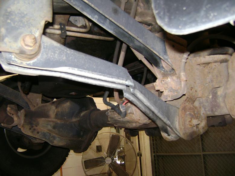

Mine was doing the same thing, and one day I heard a metallic clunk. Turns out the actual control arm had snapped. This damage was done after about a day or two of driving on it. Oh yeah, bet on your bolt snapping like mine. Go get some new ones from the dealer before you try to repair it.
Attached Thumbnails Suspension front axle moving front to back feel it in steering-dsc00660.jpg   Suspension front axle moving front to back feel it in steering-dsc00670.jpg   Suspension front axle moving front to back feel it in steering-dsc00666.jpg
