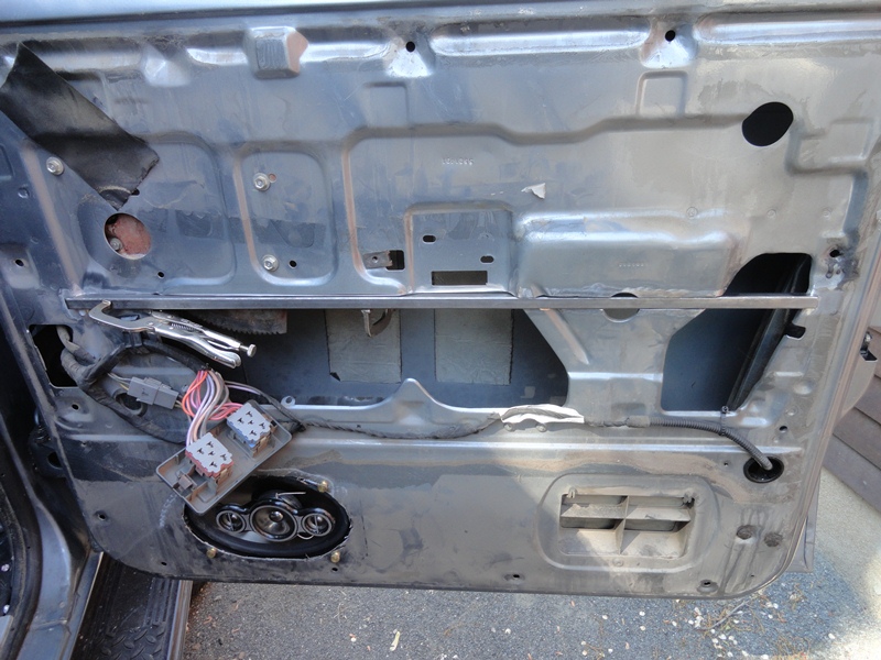

I saw what you did with your doors, and I loved the idea of having my doors feel like a truck door, vs a whishy washy floppy noodle.
Today, since I was upgrading my speakers, I figured... what the hay ! What a great idea, and a "Must have" repair to anyone with our trucks.
Can't thank you enough, as my doors feel solid like bull. Here's an imaginary beer heading your way...
I used a smaller tubing and it worked fine. If I went with a 5/8" tubing, my speakers wouldn't fit through the hole anymore.

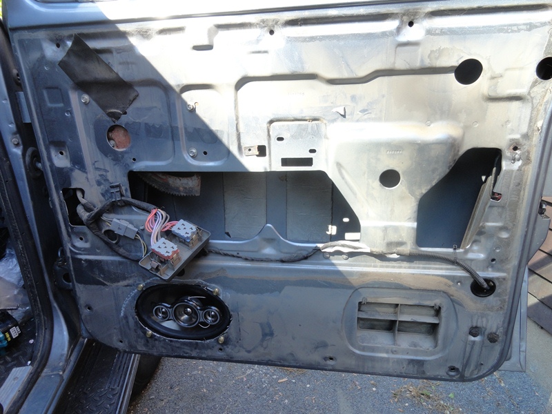

Again ..... thanks a bunch... You made my day.

After the "upgrade" fix, my windows work much faster.
I think that the inner door panel was flexing in and out during the window motion, which in turn slowed it down. The window movement wasn't consistent, meaning that it moved quickly, then slow, then quickly again. Now it's consistent as it travels either up or down. It must have been binding in the tracks.
What a great idea. The doors perception of stout is amazing, as you have said.

For the hour or so it takes, depending on how good you are at welding, it's a no brainer. You will not believe how much different the door feels after it's all put back together.

The new speaker was just slightly larger than the OE (in diameter). I traced the new speaker onto the speaker shield, removed the front plastic mesh (it distorts the music) and fit the new "hood" to the speaker. The OE bolt holes remained on the top, but the lower ones were removed due to size constraints. The speaker, front grille trim and mesh, and the speaker hood were all bolted together to the door. I then traced the speaker front trim onto my door, using the bolt holes as a guide, so that the trim fits exactly through the door panel. This allows me to remove the door panel without physically touching the speakers. I also used a line of electrician's dope on the hood to seal between the door and the hood, so that water couldn't get into the front of the hood.
Worked out great.... and the speakers are un-freaking real. 700w units off Amazon, and they're crystal clear..... I think they cost around $30 for the set.
