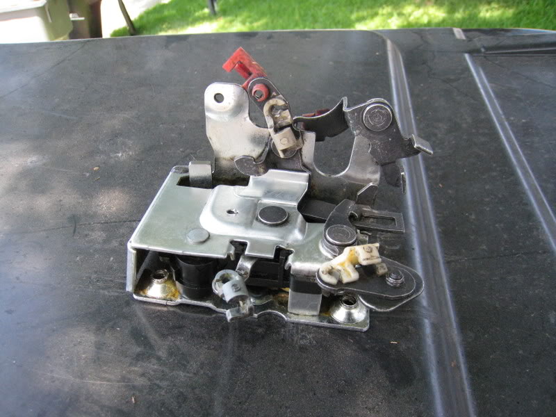

Here is a look inside your door.
https://www.dieseltruckresource.com/...d.php?t=218946
And here is your latch, I gave mine a good cleaning and then regreased them.
Jim
