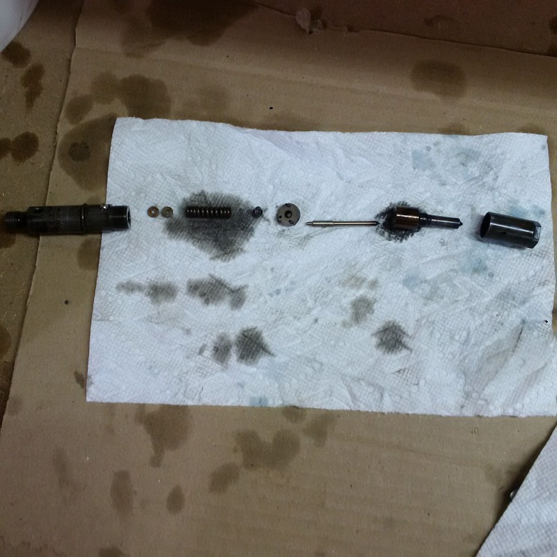

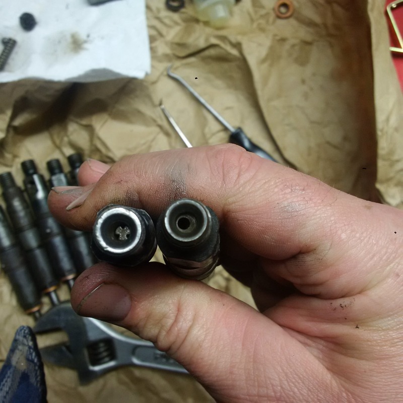

Then I decided I would tear apart, clean and inspect the spare set of injectors Dan (dan123dbl) sent me to try in my motor to see if the noise changes, or goes away with a known set of decent OEM injectors.
Only problem was one of the injectors had stripped threads on the return line port. But I had my old 9mm injectors so I took one and pulled it apart. After looking at everything carefully, and checking and measuring things it appears that the main bodies are the same....Sweet! Only thing I could find different was right at the inlet on the injector, the 9mm has an open port, the 7mm has what is called a edge filter.
Tore them all down, cleaned everything, made sure the tips were not blocked and then re-assembled using 2 cycle oil for lubrication.
