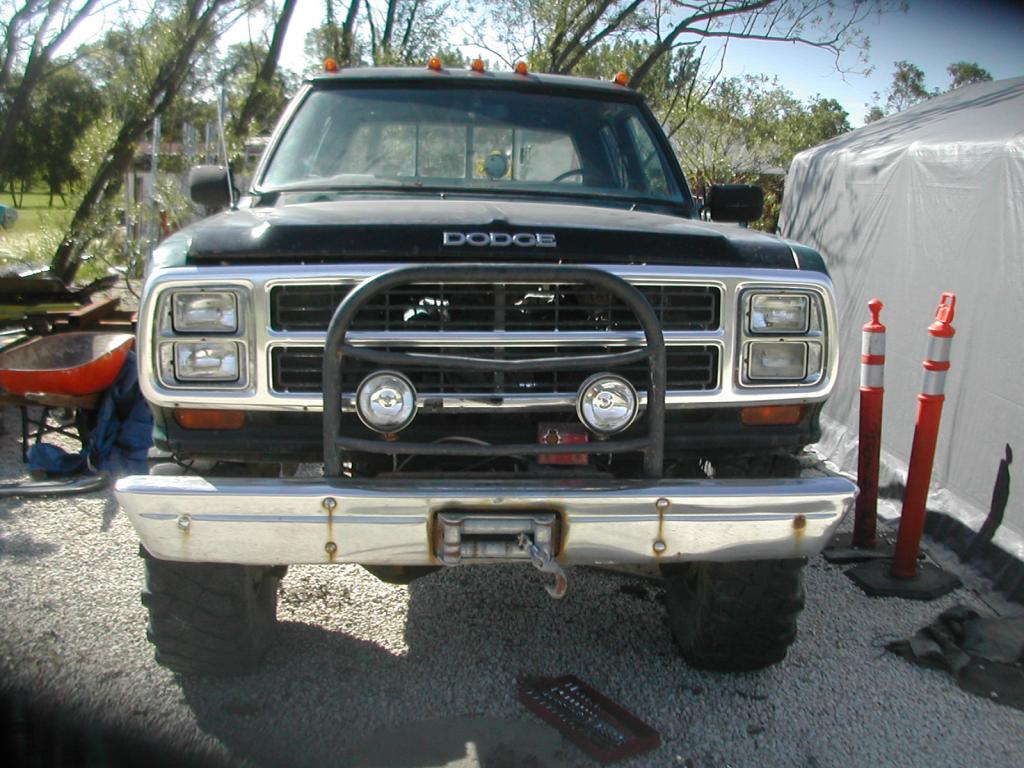

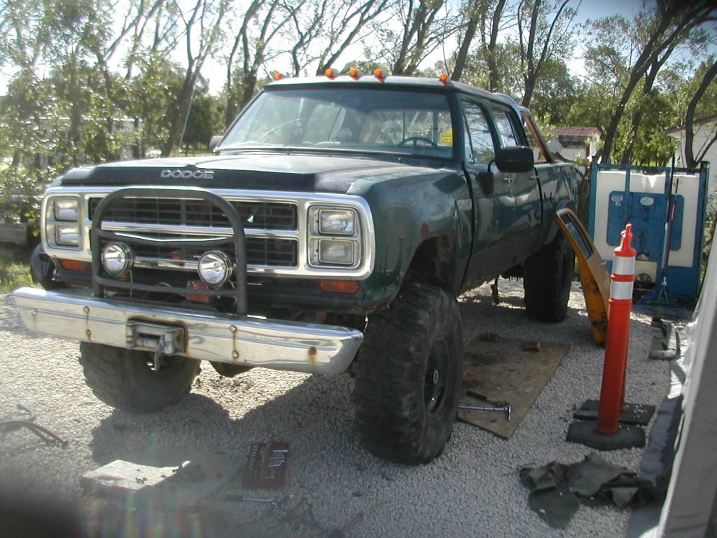

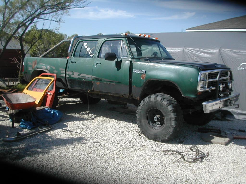

Hello im new to DTR and i thought i would share some pics of my truck. Its a 1980 Power Wagon 200 crew cab short box but im extending the frame to a long box and dumping in a 93 cummins 5 speed getrag. Tell me what you think

Flippin' awesome. Stick with the chrome bumper and quad Headlights. You have a winner.

That is a bad truck will be nice when it is done.

I don't care for it, tell you what, p/m me your adress and I'll road trip over from Alberta and get it out of your driveway for you
Seriously, that is sweet.
I'm with theidlemind,keep the "retro" front end if at all possible.

Sweet truck, I think the front end looks good on the older trucks but its your truck and coin. Do what you think is best. How in the world do you Canada guys find rust free rigs up there? Good luck with the build.
