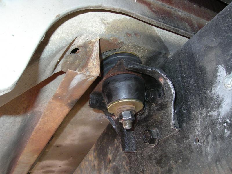

Yeah I added extra hardened washers under each of the bolts so I could torque them down properly. After removing all the grease...that I should not have put there...as Mark mentioned. I lubed up the bolts with never seize and slid them down through.

Guess I should have said I put the washers under the nuts. I didn't want to add any washers under the points of contact with the body because it would have amounted to a small lift in the body.
Here is a pic with the washer installed.

Ok. Looks like mine. It's the grease why not lather up grease on the bushing contact point? Will this cause the popping also? Reason I ask is I slipped a swipe with the index finger on the bushing tops/ bottoms with Syl-Glyde
