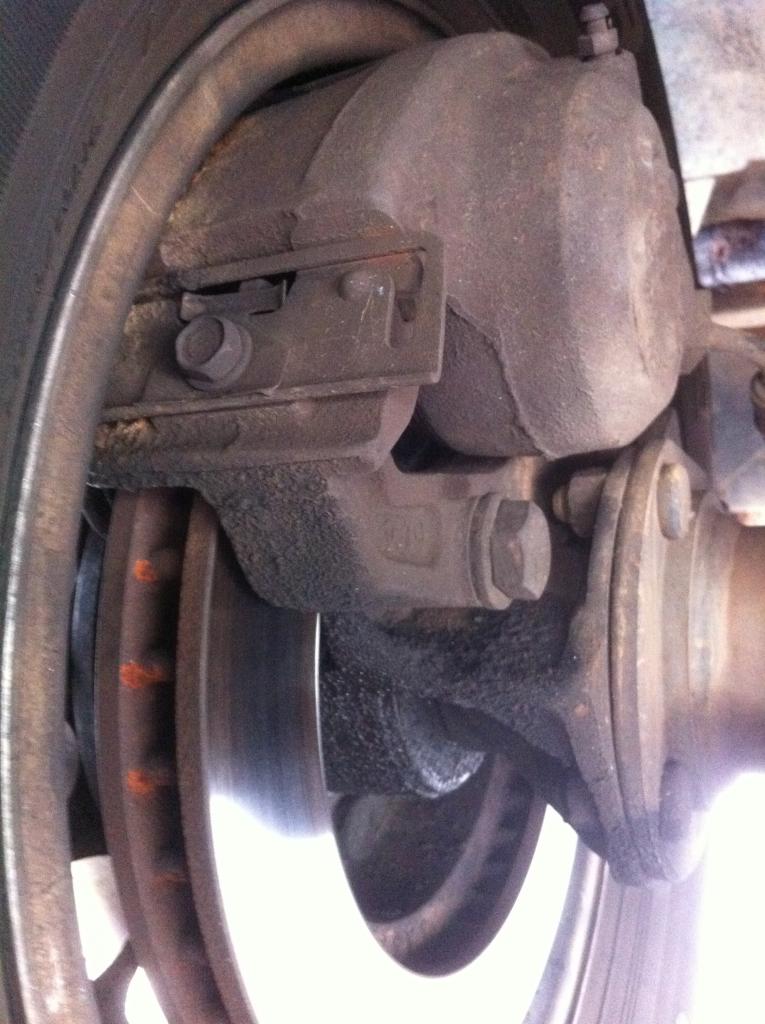

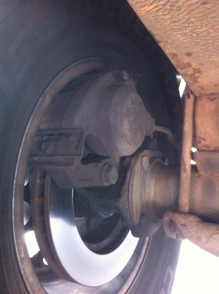

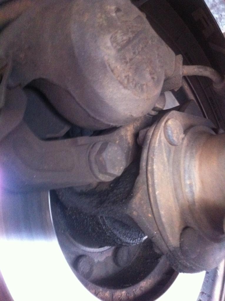

Here are the pictures of my setup. I plan to use a mechanical caliper off of a Kubota RTV for the driveline brake. For the disk I plan to make my own disk on our water jet machine at work. The reason I used the 1st gen calipers is because I had them from the donor truck for th crew conversion. Hope that helps give you some ideas.
Andy T
Andy T
Why not use a 4x4 hub?
I used 2wd parts because thats what I had to work with. I had just replaced the calipers, disk and pads about 2 weeks before I wrecked the '91 D250 (donor truck). I didnt want to waste those parts so I used them.
