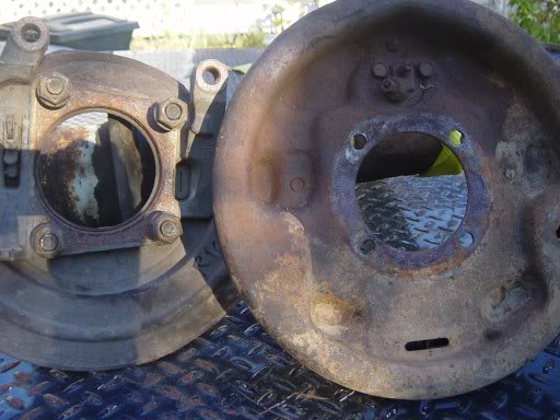

Some of the later 2nd gens had 70 axles with disks on them. The problem there is the mounting flange for the drum and disks have different bolt patterns. Here is a pic of the drum backing plate deside a disk mounting plate.

Thanks for the picture Philip. Would an adapter be possible? The picture is showing the 2nd gen mounting plate? I ask because it looks like the 3rd gen I looked at yesterday.
