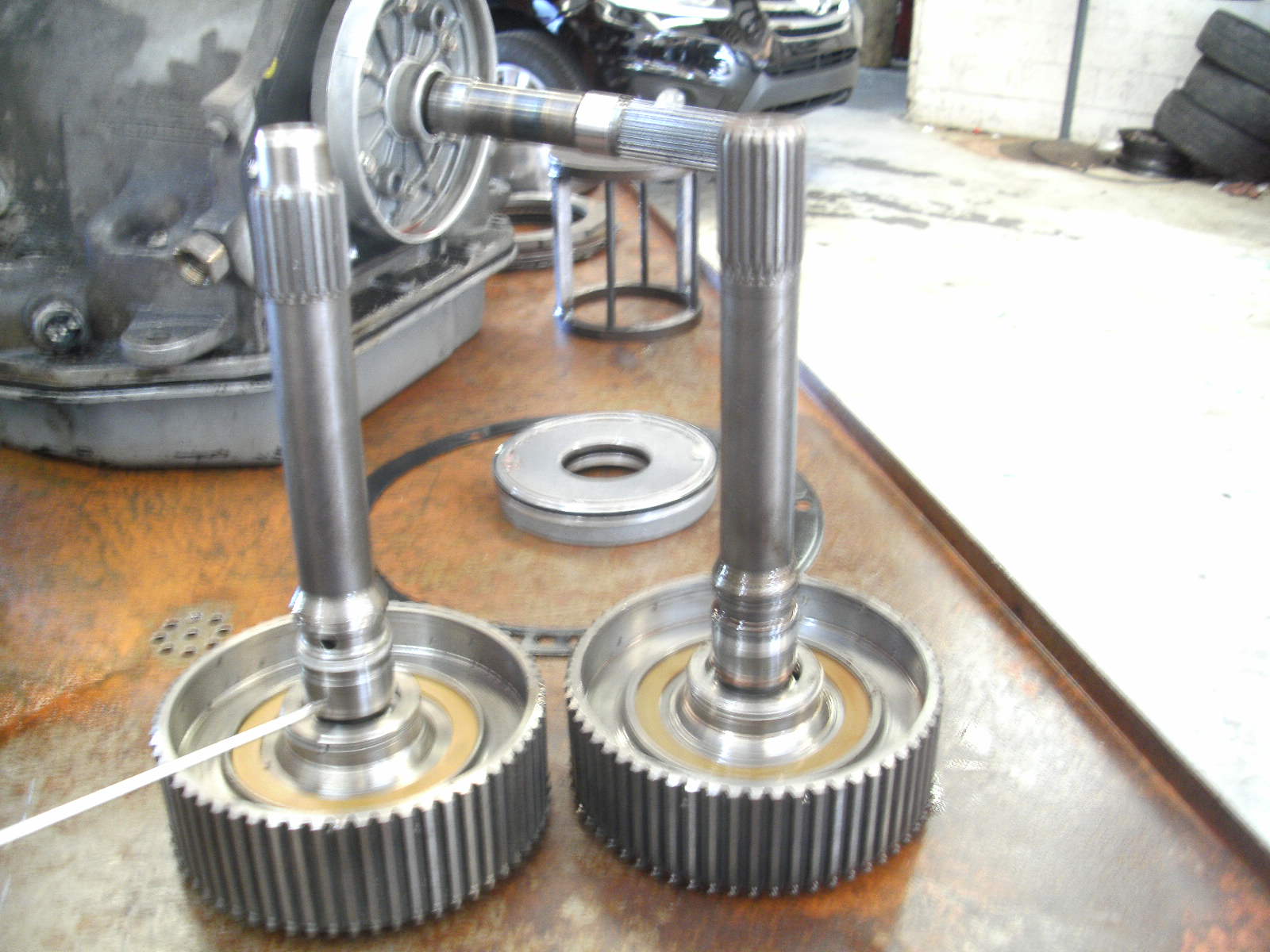

-I'm planning to rebuild the trans (46RH) since I know that's a common failure point. One of the threads I saw referenced a ATSG manual download on Scribd but the link is broke. Is this still out there somewhere? I have the factory manual but it sounded like that was an easier to follow manual.
Any special tools required for the trans?
From what I've seen on here you can add lockup if you change the trans pump & nose housing, use a lockup valve body and a lockup converter. Anything else?
Can you use the lockup valve/solenoid from a lockup gas 46RH trans to backfit lockup to the 46RH valve body? I expect the shift points are different so you can't just swap valve bodies, but can you pull the lockup control bits off the 46 and add to the diesel body? Alternatively, what exactly is different between gas & diesel - could you pull whatever springs and such off the diesel and use on the gas body to convert it?

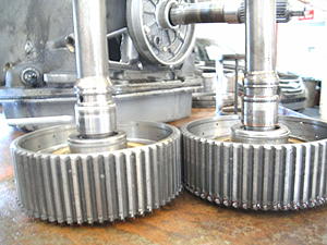

While I wouldn't use the input shaft and reaction shaft, sometimes called the stator support, from the gas truck the valve body should be fine as long as it has the boost tube, and it should. You can't use much of the non lockup valve body on the lock up body. The big difference in the diesel calibration is the governor assembly. You can use the input and reaction shafts from any 47RH or RE. I found mine on EvilBay.
Now getting your lockup working correctly automatically is another story. I'm going to have to do a write up one of these days on this I just don't have the time right now. I ended up using 2 relays and two Hobbs switches with a latching circuit to get it to where it doesn't hunt at certain speeds. Do not believe what any site tells you about governor pressure being about 1 PSI per 1 MPH on a diesel. That works for a gas version but the diesel runs much higher governor pressure to get the trans to shift at the lower RPM range of the diesel.

Interesting, I thought the valve bodies were different. So all that changes in the governor pressure? That's helpful. Now I just have to decide if I can figure out how to put the one I tore apart to clean & inspect back together again....
Any reccomendations on where to get the front pump/stator support/shaft/torque converter? I read your thread and it sounded like you initially got the wrong stuff?
I also had a 46RH in this truck (the gasser) fail last year due to the pump seizing - not sure why that happened but I'm a bit paranoid about trans pumps now and want to make sure it's right.
Any special tools that are needed?
Lockup control I can figure out. My take would probably be to use a PIC type microcontroller taking an input off the vehicle speed sensor. Seems like it would be pretty easy to make a simple control board driving a relay for lockup control and the program would also be simple and easy. Then of course you can use it for all sorts of other stuff like temperature/pressure monitoring & alarms....
