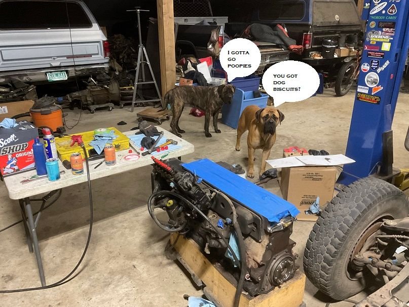

So, Ollie asked me to post up a few photos for him. I'll try my best to put them in order, based upon what I'm seeing in the photos.
I'm sure he'll chime in for any "esplaining joo need to do Lucy"
Prepping the deck with some fancy colored plugs
Next
The motor inspectors showed up about mid way
Next
Some bling on the block, hopefully someone will esplain
Next
Does anyone really know what time it is ? Does anybody really care, about Time ?
Next
Gasket installed, along with a water bypass gizmo on the end of the block, Ollie can esplain about
Next
Weight lifting class in session by these two handsome fellas.

The pictures show the first two days of wrench week.
We started off with the cleaned up and milled down .012 head I had just gotten back from the shop the day before. Then new Cummins valve seals along with 60 over valve springs where installed.
The block was shop ragged up then taped off for the piston bores. Then plastic plugs where used for pushrod holes, water galleys ETC. The block was then throughly cleaned up.
With the block deck cleaned up and the head assembled, we headed [no pun intended] toward timing the pump and block followed by pinning them. The P7100 pump was pulled from the timing case, making room for a fresh bling tappet cover from Keating to be installed. I also used their frost plugs and the rear plate.
The picture of the magnetic wheel on the damper was used to measure the amount of timing we added, by rotating the motor without the injection pump connected to the gear. Then installing the timed pump onto the motor so we gained 7 degrees of timing. This got us from the 13.5 stock # to 20.5 of timing now. The P-7100 pump does not have a key that fits into a slot in the gear like the VE pump does.
Before installing the injection pump back on I modified the AFC housing for more travel. Added a stiffer and longer AFC spring that now allows me to not fully bottom out till over 30 PSI. I also swapped the fuel plate out for a #10, then added 4K Gov springs and used some 191 delivery valves I had in the shop.
A Cummins HG I had sitting on the shelf since 2011 was used and then the fresh head was attached.
Then that night after dinner we torqued down some ARP studs in order from the center of the head outwards in rounds of 25 LBFT increments. Setting the valve lash, installing a 3 piece exhasust manifold and a turbo rounded out the last few hours of that night.
But that is getting ahead of the pictures...

I like the mastiff captions, I assume Tman speaks dog?
That timing tool is cool, never seen one of those.
Do I spy Athletic brews on the table?
Man I could spend all day in that shop looking at vehicles, tools & parts. I can see why you want to spend most of your time there with the dogs - and kid when she can now.

I have a dial indicator tool to double check the timing but the magnetic timing wheel was handy and quick. We also found it could be helpful for setting the valve lash.
Yeah those are some of Athletic Brews IPA offerings on the work table. A little tasty craft NA beer while building the engine sounded like a smart move.
Working in the shop with the dogs is one of my preferred activities. My daughter was up on both Sat. and Sun of Wrench week to hang out and help. M-F, she works a real job.
She showed up Sunday morning with some tasty baked treats for breakfast. She was also the one that snapped the photo of the head being lowered on the block.
