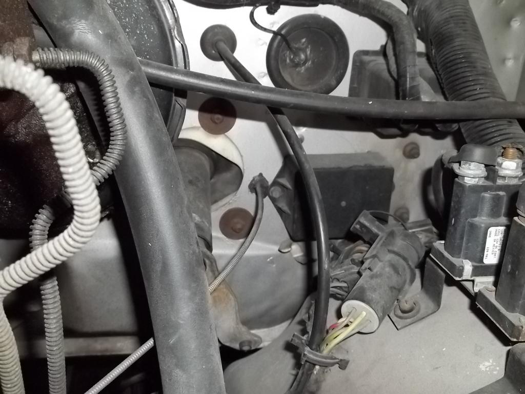

non intercooled (1989 1990) engines have an ecm.it is located on the engine side of the cowl towards the drivers fender from the steering column. it is a black box about twice the size of a pack of cigarettes.all this ecm does is control the ksb and the grid heaters.chaikwa,if you want to use an ecm either one will work,early or later style.but,you don't need an ecm.just run a hot wire from the ignition to the ksb.voltage all the time the engine is running (just what j martin said).to confuse you more you can delete the ksb all together.anybody familar with these pumps can delete it right on the engine without taking the pump off.all the ksb really does is keep the engine from smoking a little white smoke when you first start up.and this keeps our friends the air pollution people happy.
You are right, I was thinking of the one that controls everything, like the alternator, on IC trucks. I looked at mine and it is the one that has a vacuum line and a connector, but it is about half the size of a pack of cigarettes...Mark

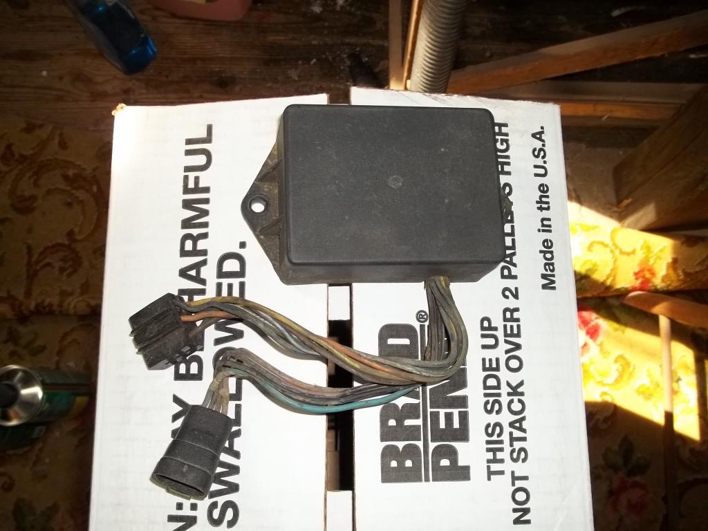

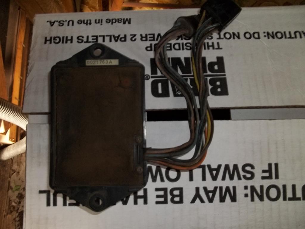

maybe368,you are looking at the wrong thing.see pictures: first one is ecm on the truck,second is front view and third is rear view of ecm.see the serial number on the paper label.
Thanks man, I have owned my truck for more than 12 years and I have never even noticed that box. I have even changed my booster twice, probably had my hand on it. I think I have pre-alzheimers disease......Mark
