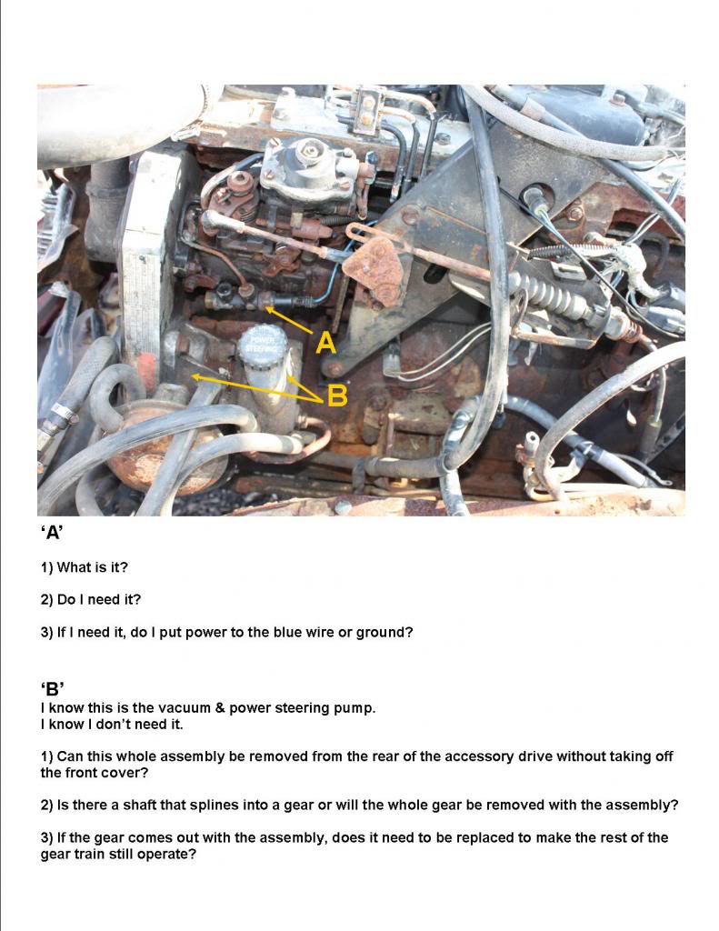

Finally got my motor for the wood processor, but there are some things I'd like to know before I go ripping and tearing things apart. I know these are probably mundane questions for those of you that are familiar with these, but I'm not one of them and any help would be greatly appreciated! This was in a '90 W350.

A.)KSB
Yes, cold starts. Changes timing. Do NOT put blue wire to ground. You can toggle switch it 12V (hot wire) for cold starts.
B.) Two bolts remove the pump. Gear is helical and will come right out attached to pump after you take the 2 bolts out. Does not drive anything else. You will need to block off hole or just leave the pump and let it spin.

Originally Posted by TIMMY22
A.)KSB

Likes: 11
Correct me if I'm wrong but the non IC Trucks KSB should be hot while key is on. So he should run constant 12v to it?
A.)KSB
True, that picture looks like the early KSB with the longer solenoid. They are backward from the later ones in that they remove power from the solenoid when cold, and apply power when warm.
do NOT just let the P/S pump spin, unless you run a line from the pressure out let to the return hose nipple and put ps fluid in the pump, otherwise the pump WILL burn up, lock up and cause a bunch of nasty things to happen. best to remove the pump and bolt a cover plate on the back of the timing case. cut a plate from 10 or 12 ga sheet metal, drill two holes, clean the plate and timing case with acetone or brake kleener, run a bead of red or black silicone, and bolt`er on. done !! one less thing to worry `bout !!!!

Posts: 7,294
Likes: 2,884
So the NON I/Ced trucks should have hot key on power to the KSB all the time?
My white '85 crew I just swapped using a '89 12V, I just have hot key on power to the FSS.
I don't have the KSB hooked up at all right now.
