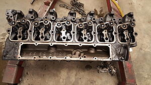

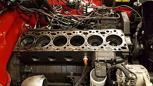

Unfortunately the only gasket I did not replace--the head gasket---is leaking. No evidence until now. Small external leak on the passenger side. I ran and drove it for about 2 hours last Saturday, ran great, but when I came back and checked for leaks, I found a coolant trail going down the block. It has never overheated, was not low on coolant, but this being the first time the cooling system has been fully functional and able to build pressure, I think caused the leak to raise its ugly head. It may have been leaking for a very long time.
Got the head taken off today. Cake, took less than 2 hours.
No visible cracks or damage, other than the head gasket---got it loaded in the truck to carry to the machine shop tomorrow for testing, a valve job, and a good cleaning! If they give it a clean bill of health and can update the valve seals without too much trouble, we'll rebuild this head, if not, Cummins Recon.

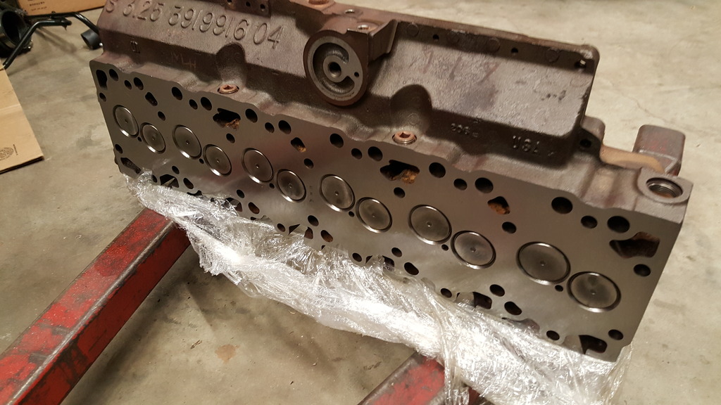

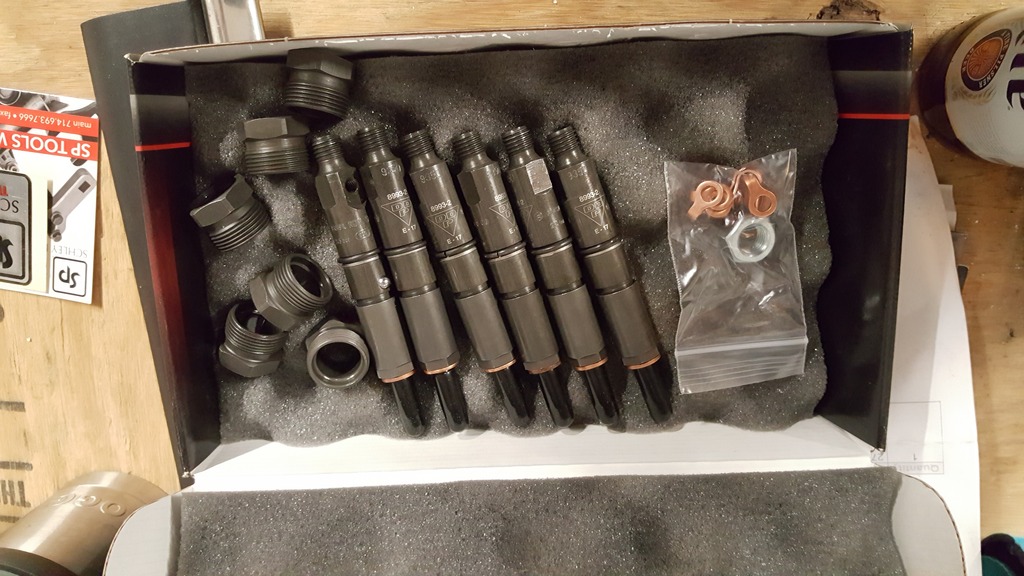

Lots of work coming this weekend, everything is here for the cylinder head job except the pump;
I ended up tearing the injection pump off as well, and sending it out for a refresh. Good thing, as it turned out to be a bomb. They found two of the plunger springs broken, and they had sent metal into the internal transfer pump and tore it up....after talking about it neither one of us could figure out how the engine was running so well...better now than 500 miles from home.
Large Cummins boxes are always good;
New fuel sticks!
Fresh head!
If all goes well, she'll be back running on Saturday, and I can get back to concentrating on body work, with a few more horsepower ...

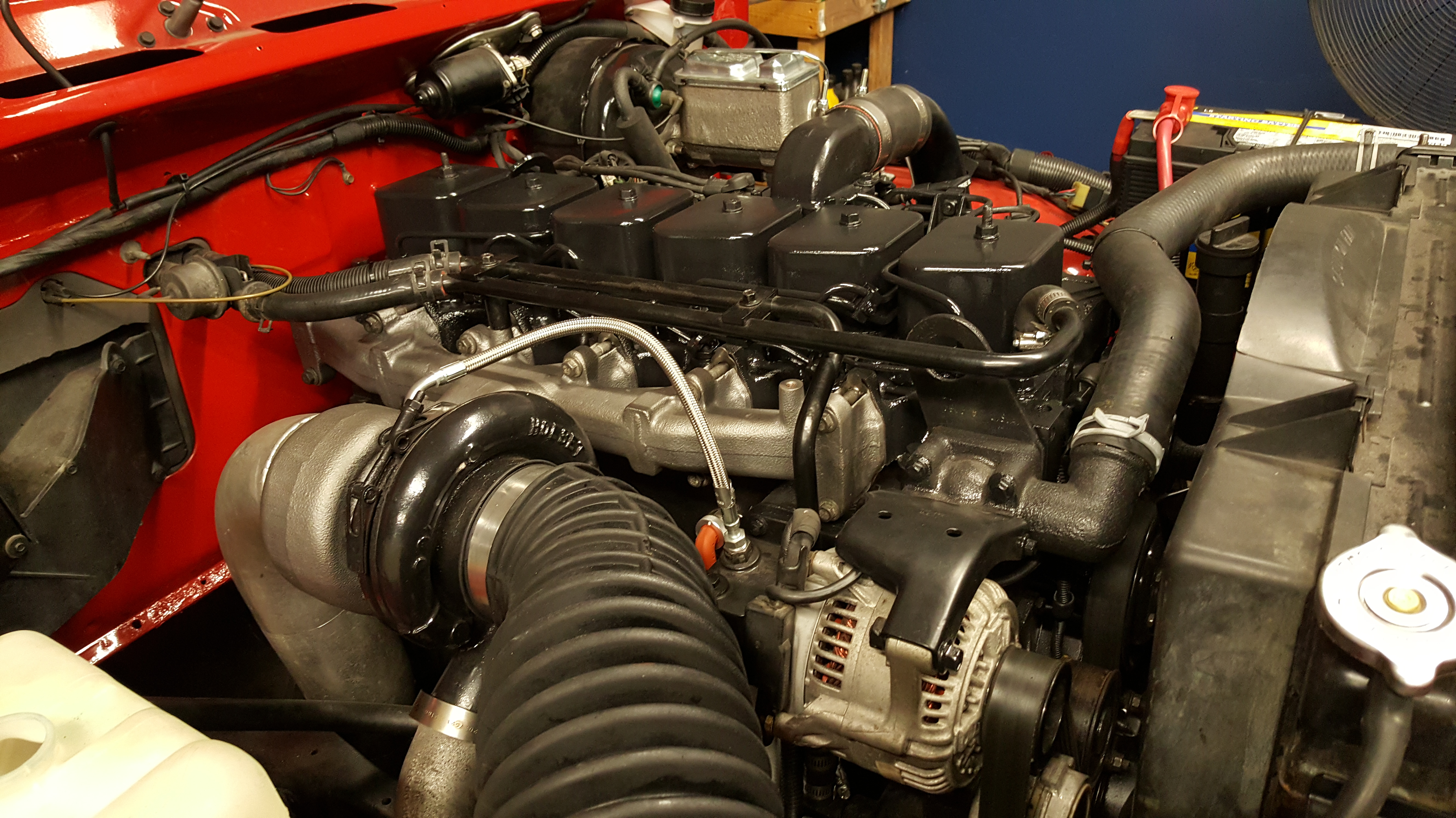

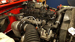

Time for an update;
The engine is all back together, **** does she run great. So nice and smooth. New Stage 2 injectors, head was rebuilt--no cracks in it luckily--and injection pump rebuild....going to be upgrading the turbo after the body work is all done; along with doing some pump tuning.

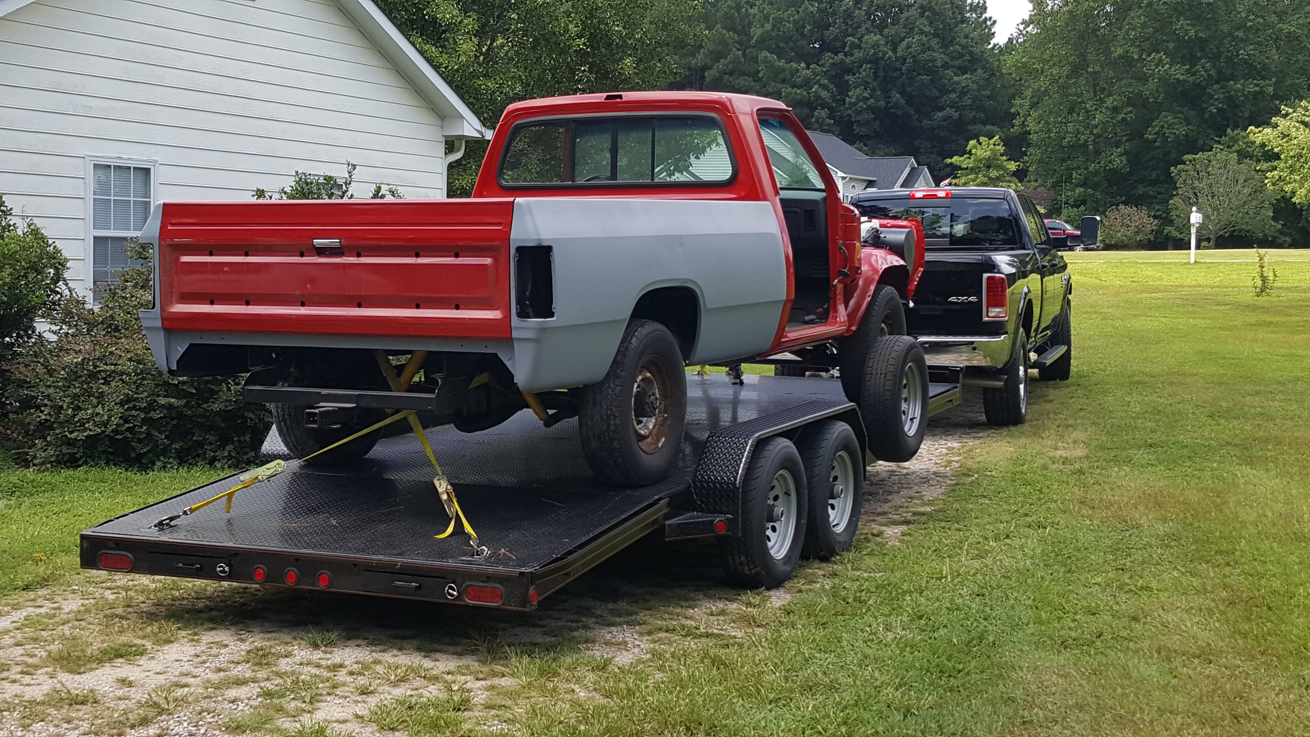

Its been awhile since the last update, not much to report as of late, other than shes now in the body shop for paint--since mid July. Hoping to have her back here soon, but no idea when for sure. Then it will be time for final reassembly!

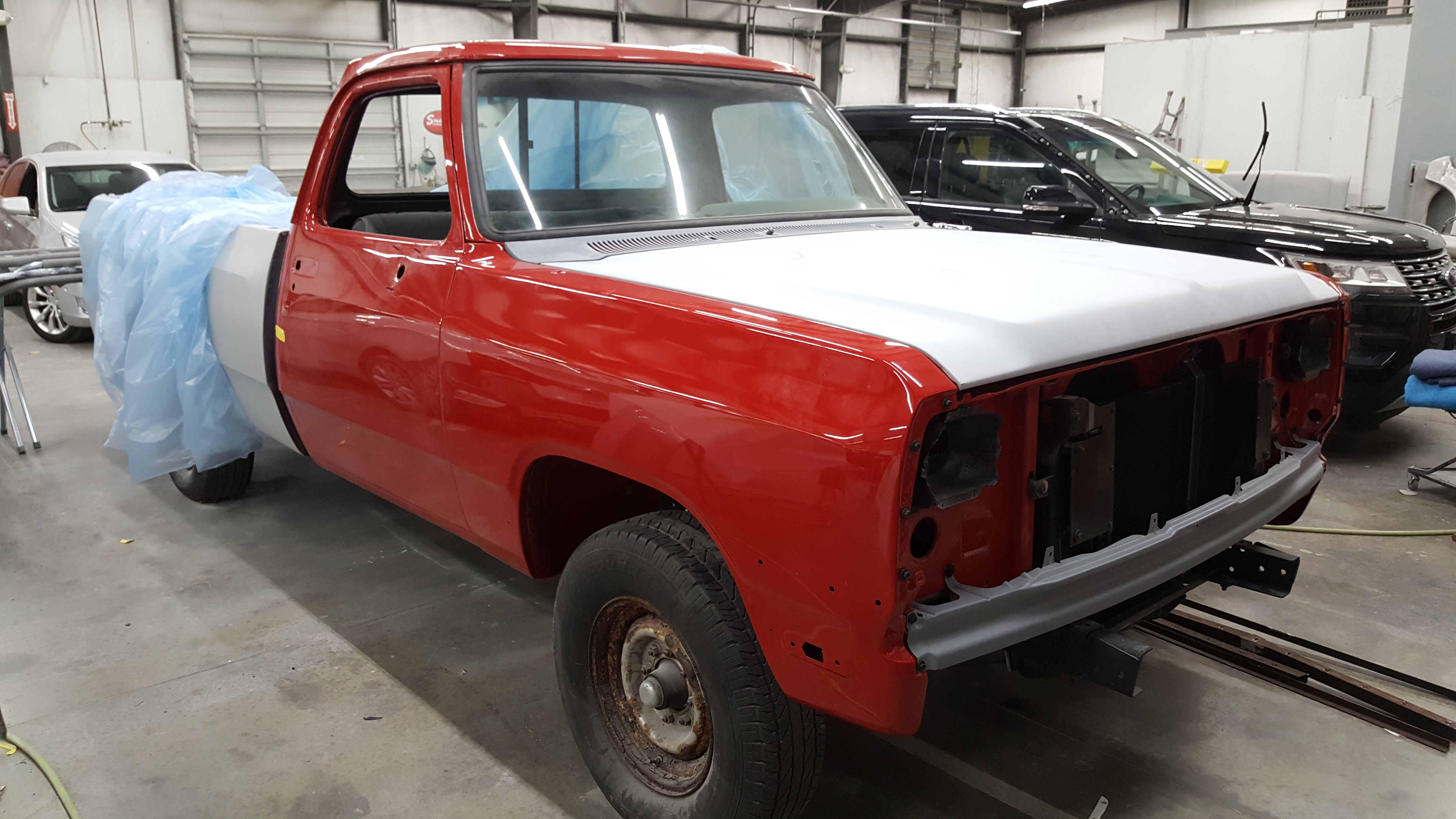

Old Apr 7, 2018 | 09:22 PM
  #74
Daytrepper's Avatar
Joined: Sep 2016
Posts: 110
Likes: 86
From: Zebulon, NC
Latest and greatest news; we are in the final stages of the job at the body shop. Everything is painted; next step is to get the bed back on and do the final touches on checking the fit of the body panels/doors; etc; then cut and buff. Estimating another month or less before she is back here to me for final assembly.

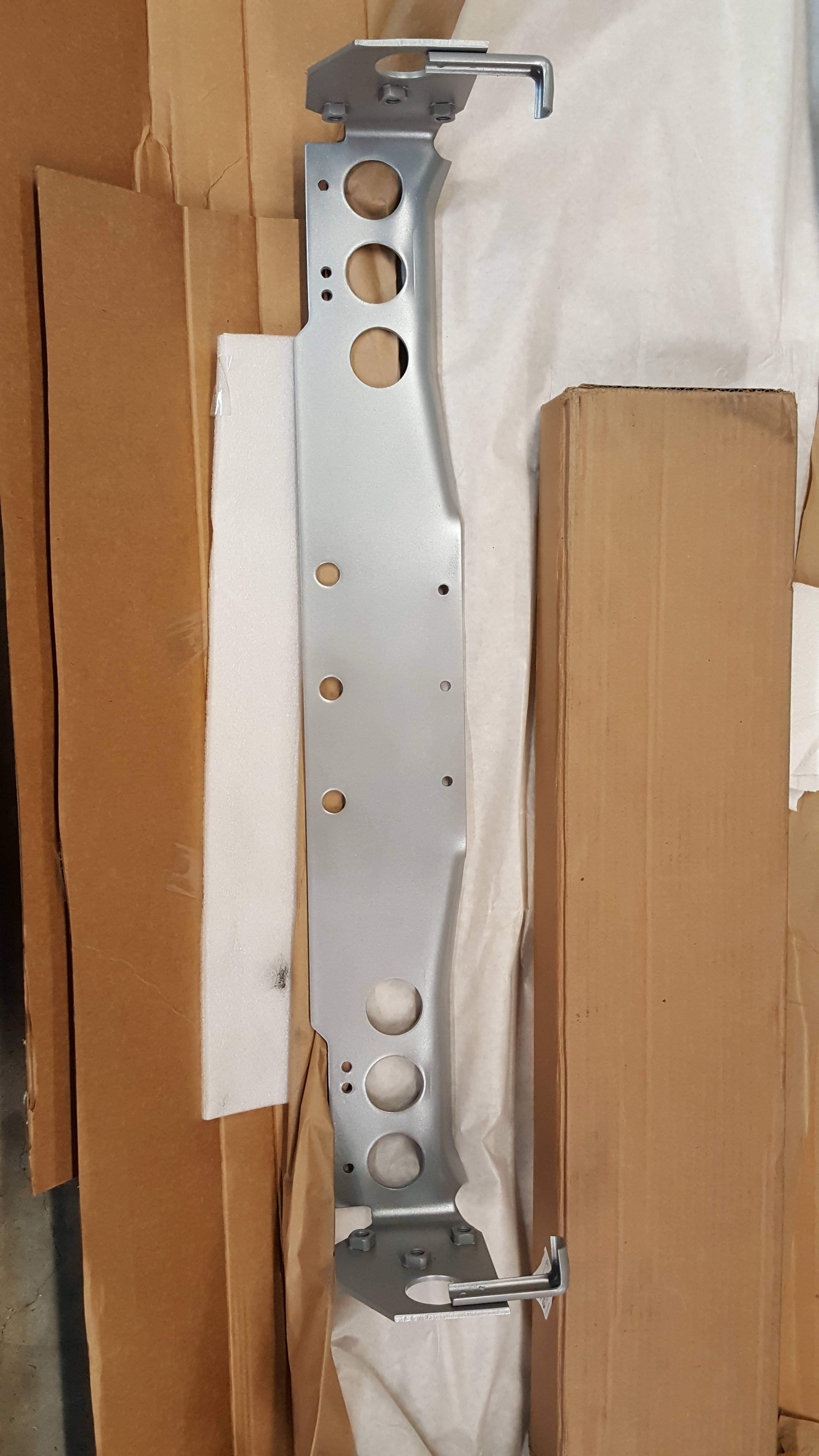

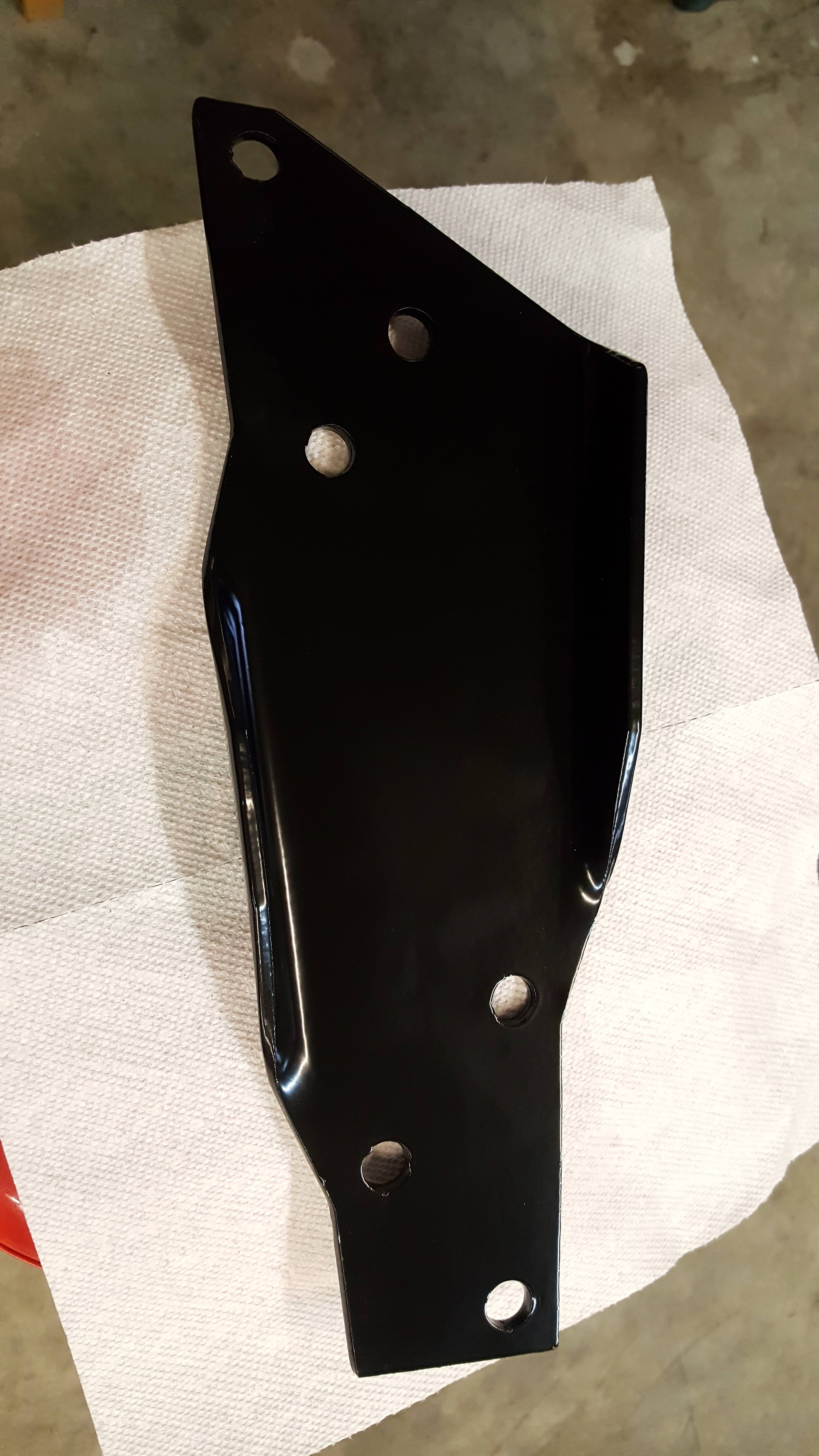

I decided to get a powder coating setup; as many small parts I have to do on this truck I figure it will save me $$$$ doing it here vs the local shop. The first two pieces, the rear bumper step in steel grey, and bumper bracket in black. After a few how tos and some research, they turned out great:

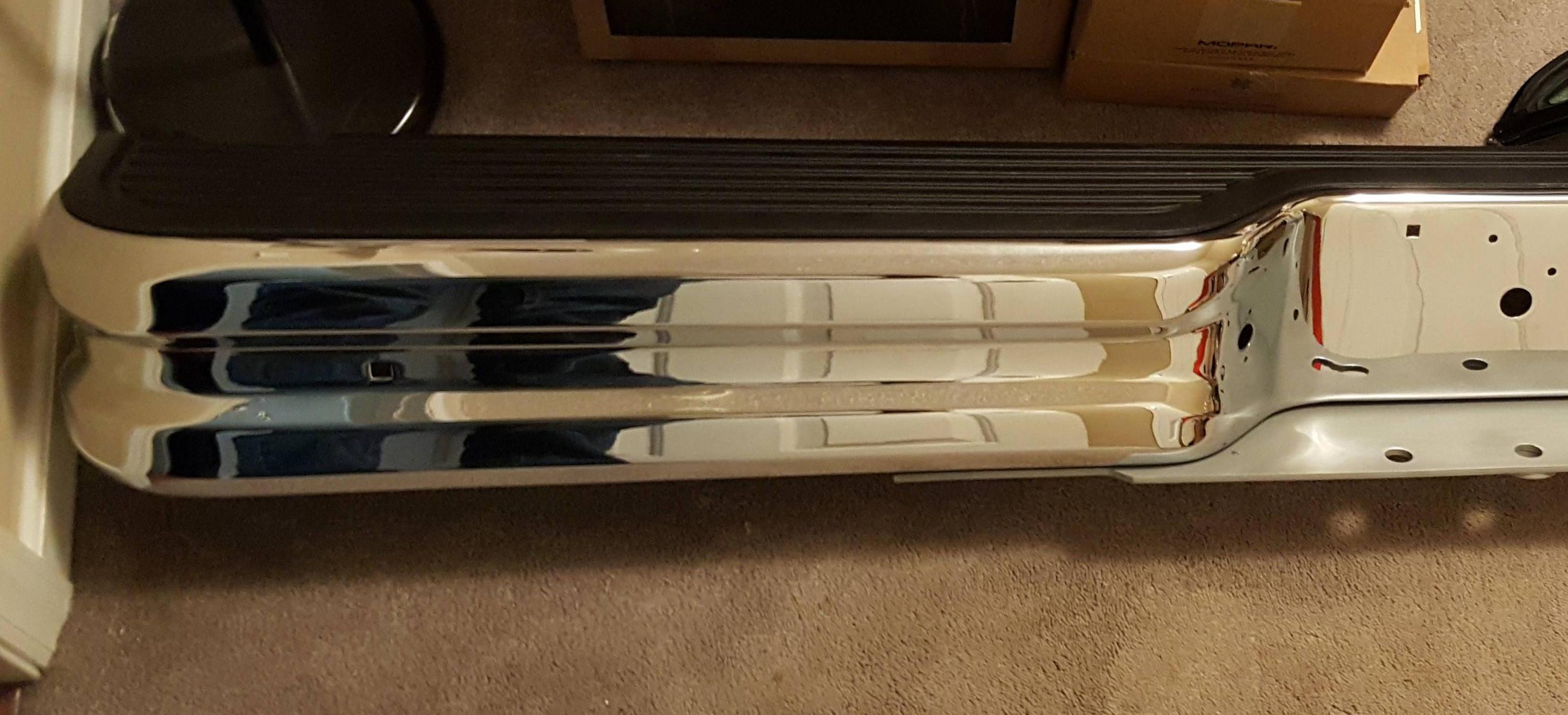

NOS rear bumper; sent it off and had it rechromed as it had a few dings and scratches from being in a warehouse for years.

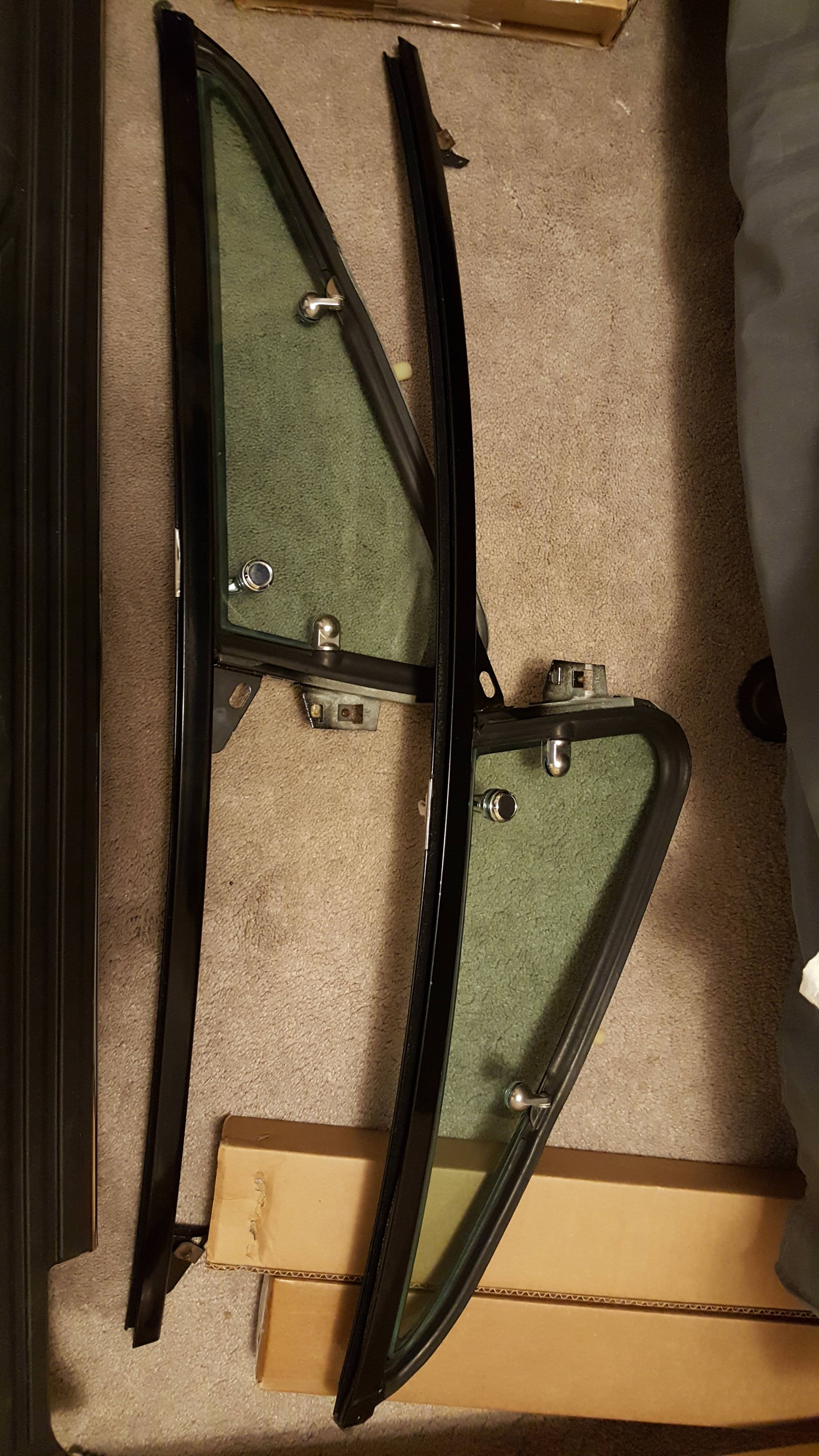

Powdercoated the wing window frames, and restored and repaired the latches;

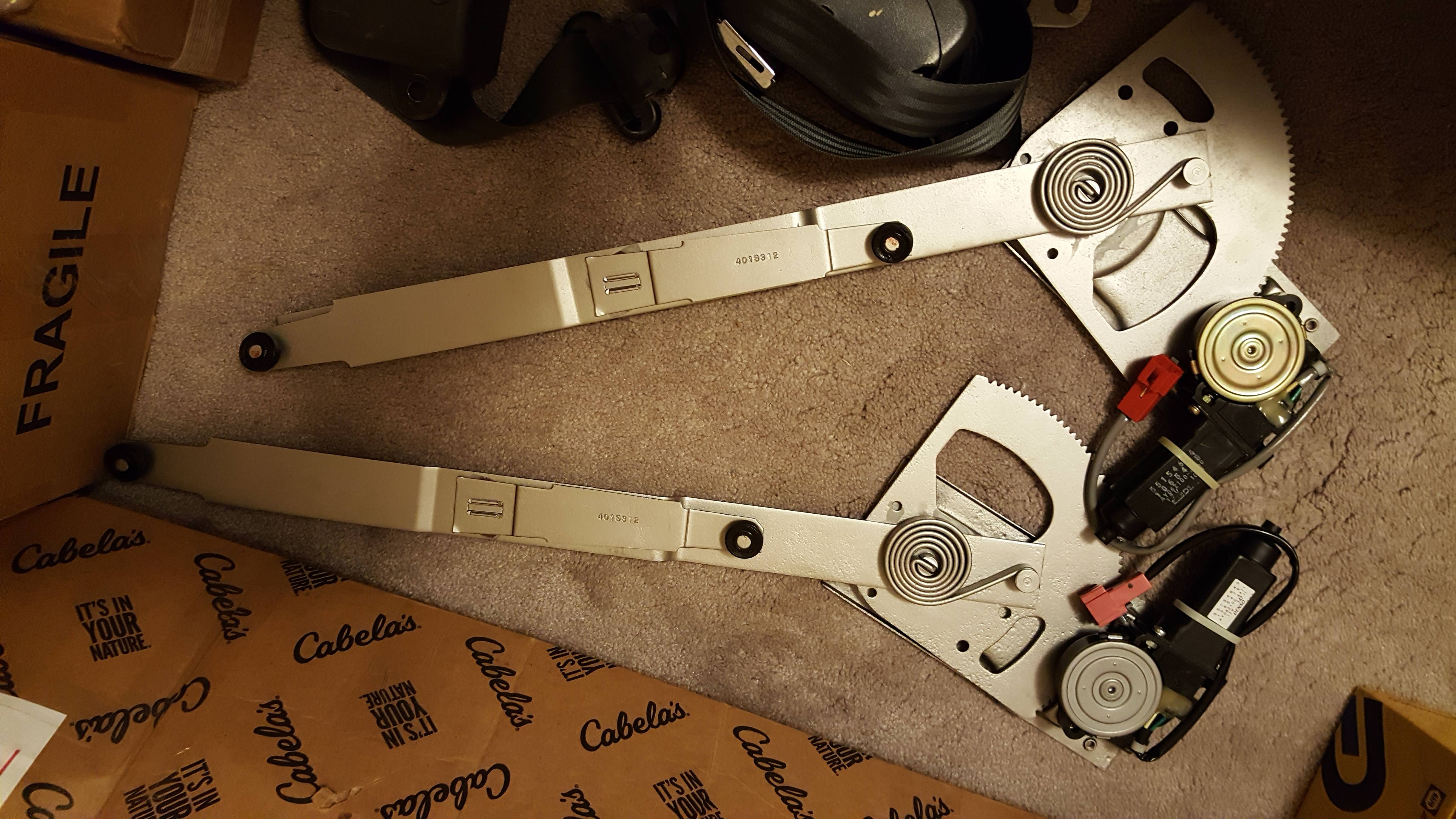

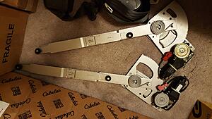

Restored the window regulators and motors;

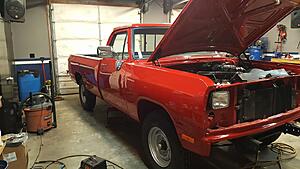

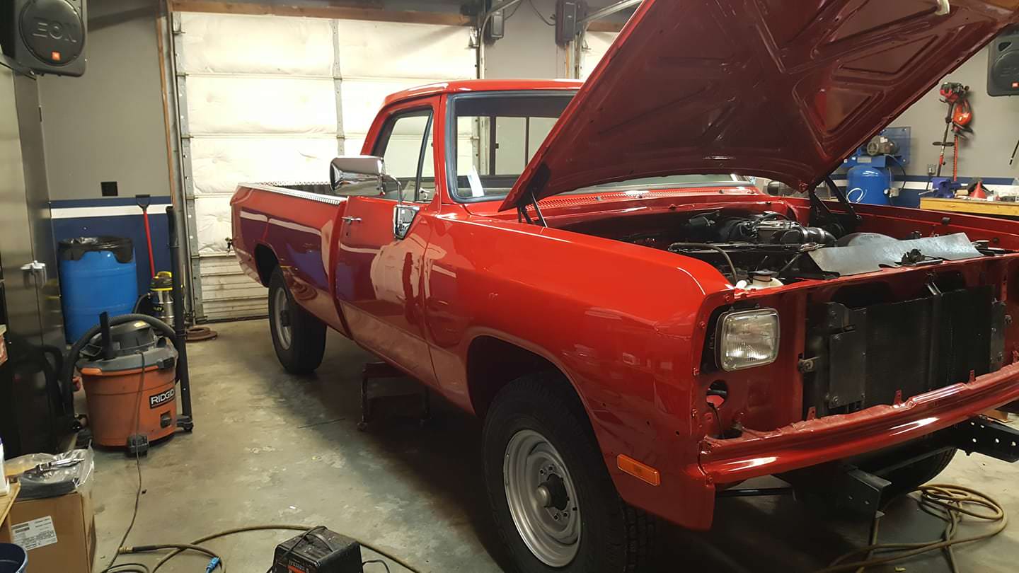

Been a long time, but after a long wait for body and paint to finish; she is back to my shop for assembly!
Ive gotten quite a bit done; as of today;
