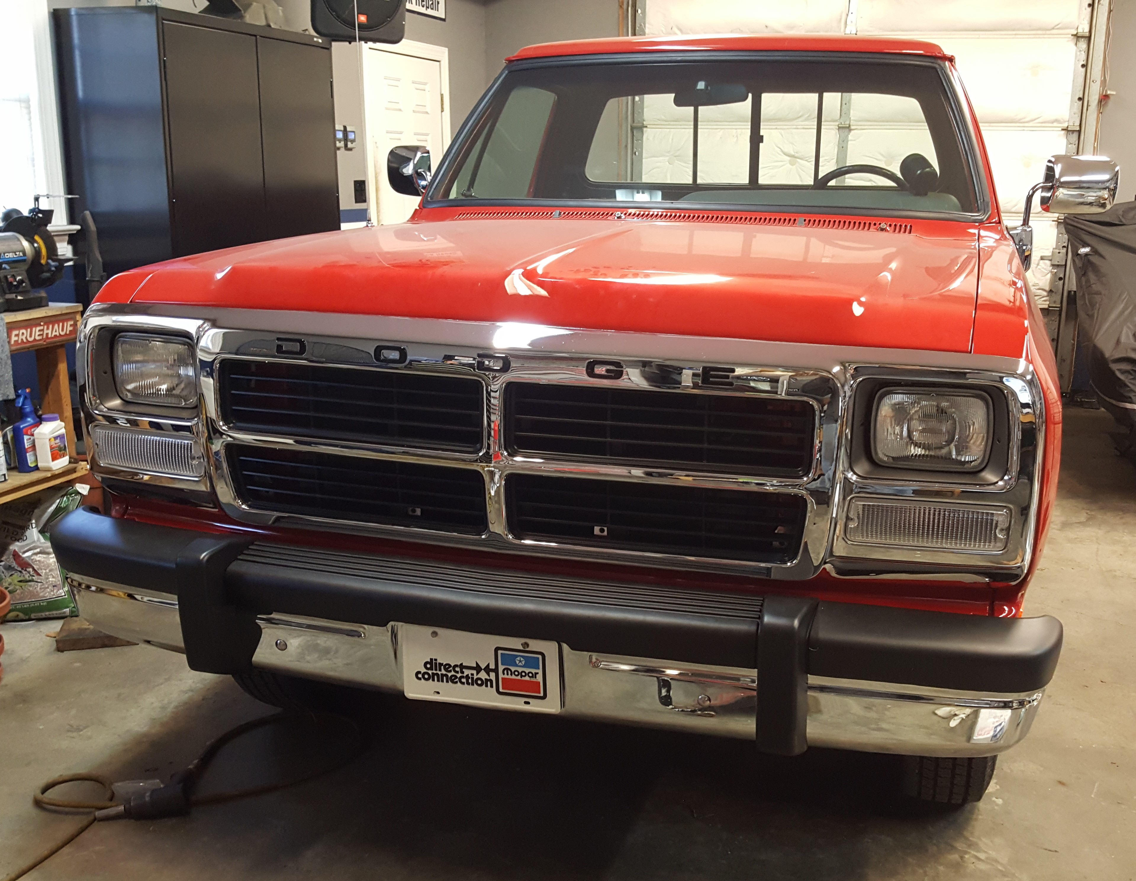

....and the front is done!

Hows the interior? From the front it looks like it just came out of the showroom!

Looks like Carlisle 2019 "best in show winner"

I don't think they looked that good sitting on the dealer lots back in the day . . . at least not out where I grew up. That looks great!

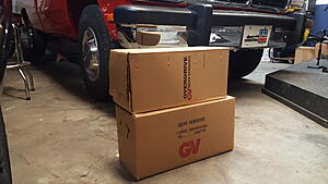

After a good test drive and trip to town for an alignment, etc; I decided to order a Gear Vendors overdrive unit. She runs great, but at 75mph, shes running 2200 ish RPM. Too high and more wear and tear than I want to put on her. Back in 1993, they just werent geared for today's modern speeds. This will set it up nice for the highway cruises to Carlisle, and other places. The Gear Vendors unit will put me at about 1800 RPM at 75, top speed in the neighborhood of 95 mph. Plenty lol. Since the GV unit will be "divorced" from the transmission, i'll be building new driveshafts, and keeping the original just in case the GV ever has to come out. I'll be adding a nice feature from a Freightliner truck. Instead of the stock GV switch, I'll install an electronic Meritor shift ****, which will control the cruise control, and the GV unit. This is being done with no modification to any original parts, should she ever need to be returned to original spec. Starting the install this weekend.
Other than that I have the seat back out for restoration. New seat cover, some foam repair, and a quick repaint of the seat frame and trim pieces, it'll be good as new.

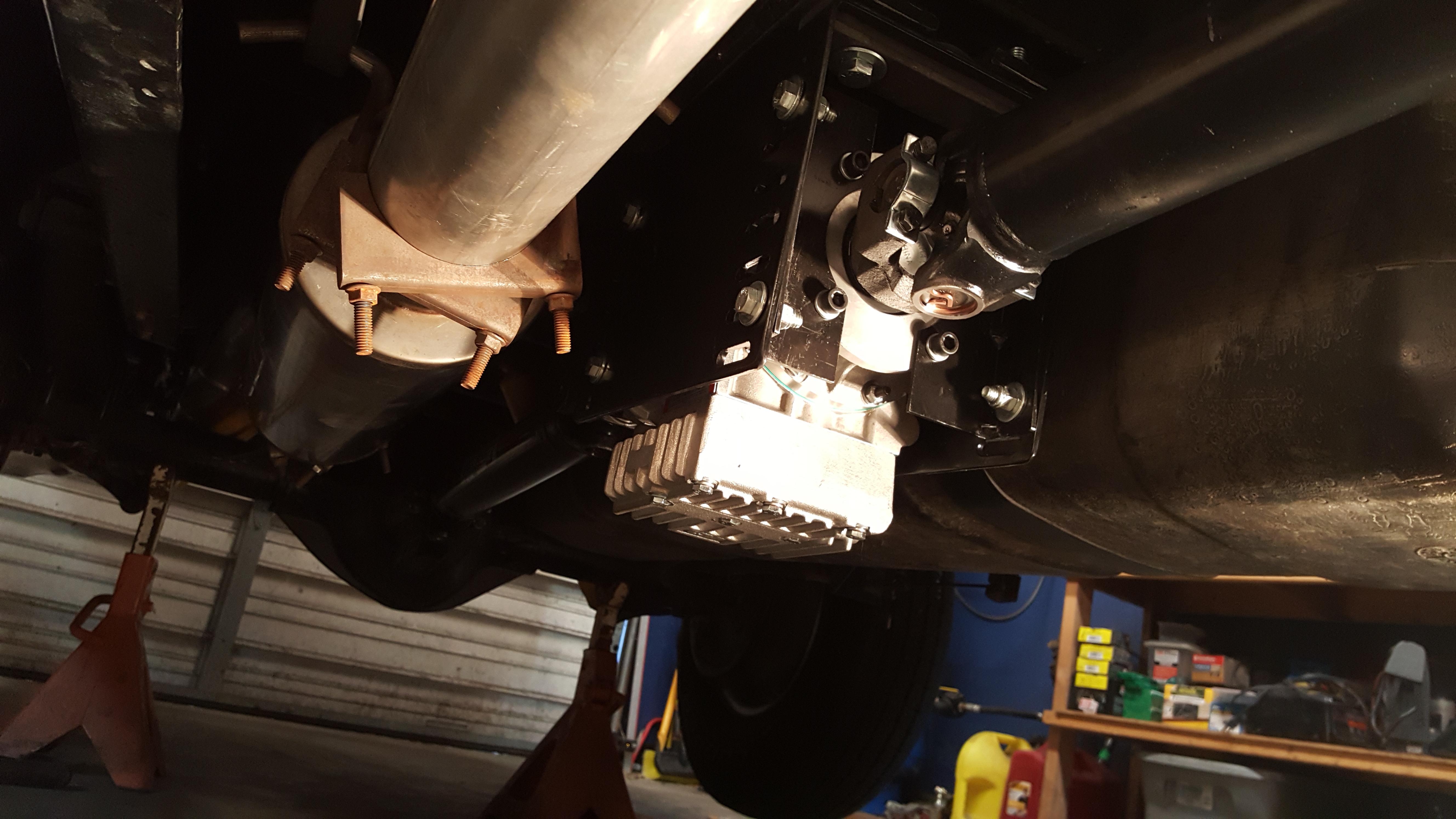

Gear Vendors install complete! Now onto the seat upholstery, so I can take it for a drive.
