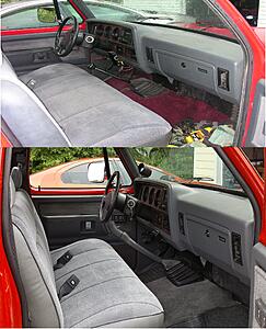

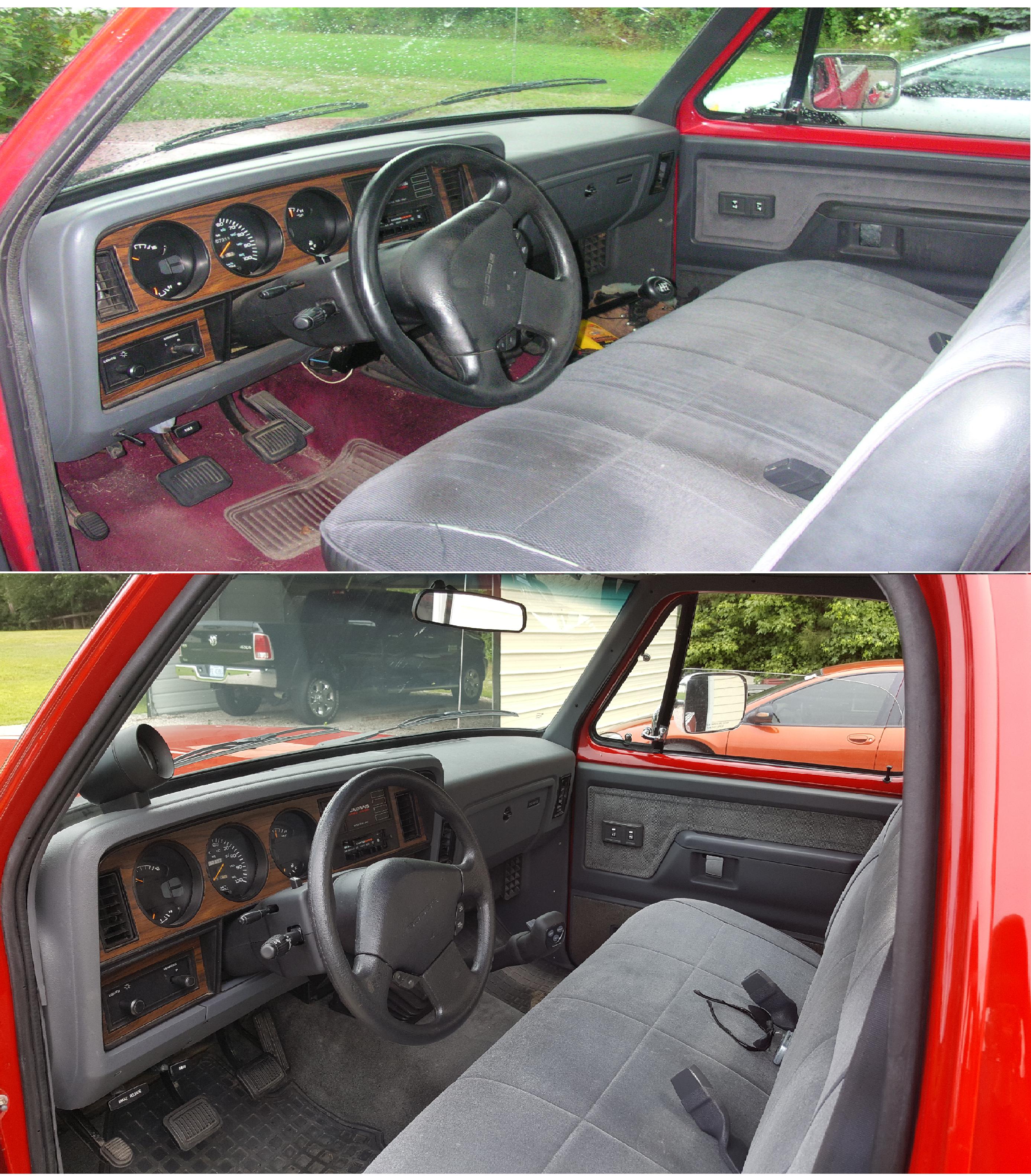

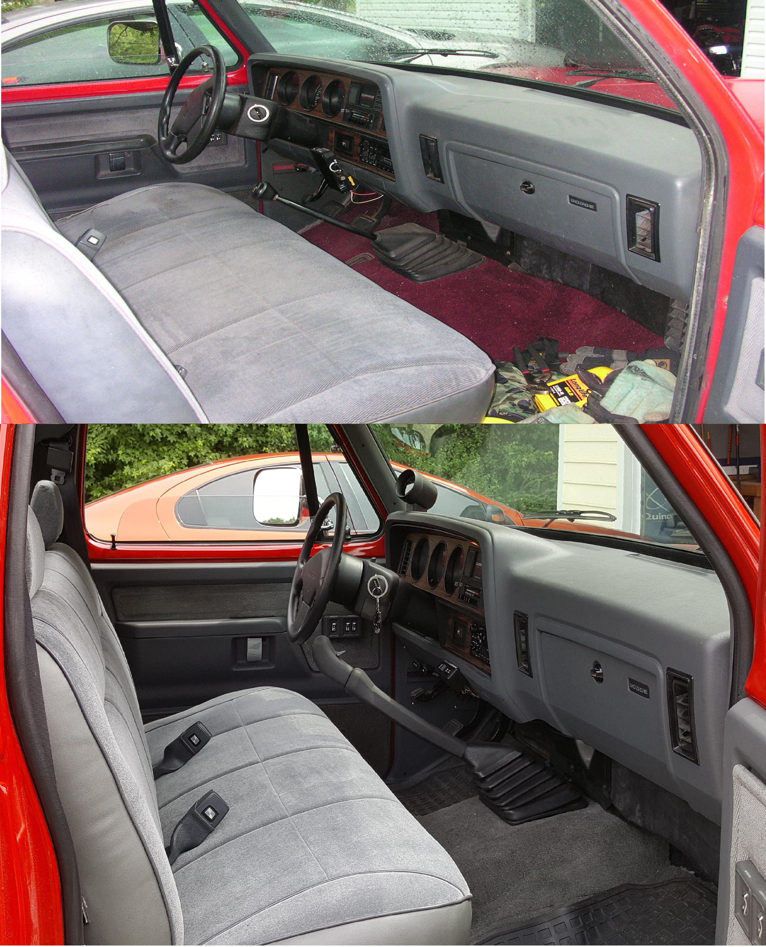

Here are some before/afters on the interior:
