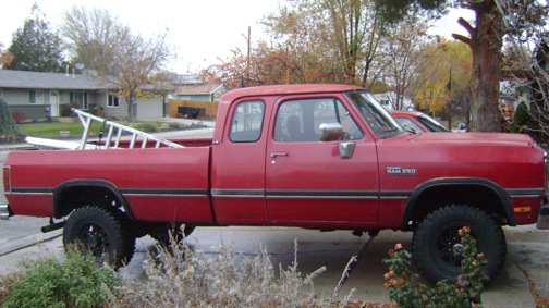

Hey, I gotta 92' w250 with an auto...having some tranny issues....I flushed it today, put a new filter in...the sea foam made it run better almost instantly....the tranny seems to be running real good now, night and day from when I bought it . The only issue is I am still having a slow leak coming from the torque converter....if any one has any simple fixes, it'd be a huge help. I really appreciate it.

there is not really an easy fix for a leak like you speak of.....gotta pull the transmission and change the seal....its cheap and easy but kinda time consuming.......the getrag is not wimpy and the NV4500 is not bulletproof, they both have there downfalls, and high pionts, i will say if you fix 5th gear in the nv4500 iv seen them takes tons and tons of abuse, and i have also put my getrag through lots of abuse, theres $0.02

I'll probably just fix the leak, can't afford to do a rebuild or upgrade right now anyways. Thanks for the info.

its not too hard to drop the trans out. make sure you do a real main seal while your in there. well id do one

My buddy and I took the pan gasket off last night. Its gotta a "heal a coil" on one side which is causing a bad leak...we can't get the bolt to tighten all the way down, it keeps spinning. I think we might try to tap a new hole and re-thread it with a lil' bigger bolt....I don't know. The engine is tops! Its just everything else on the truck that is achin'. Tranny, driveshafts, I am runnin' out of dough! Yeah, its a lil' steep on the price, but maybe someone will buy it for the motor. We'll see. Yeah, new seal is comin'....gotta find time. Thanks for all the advice guys...much appreciated.
