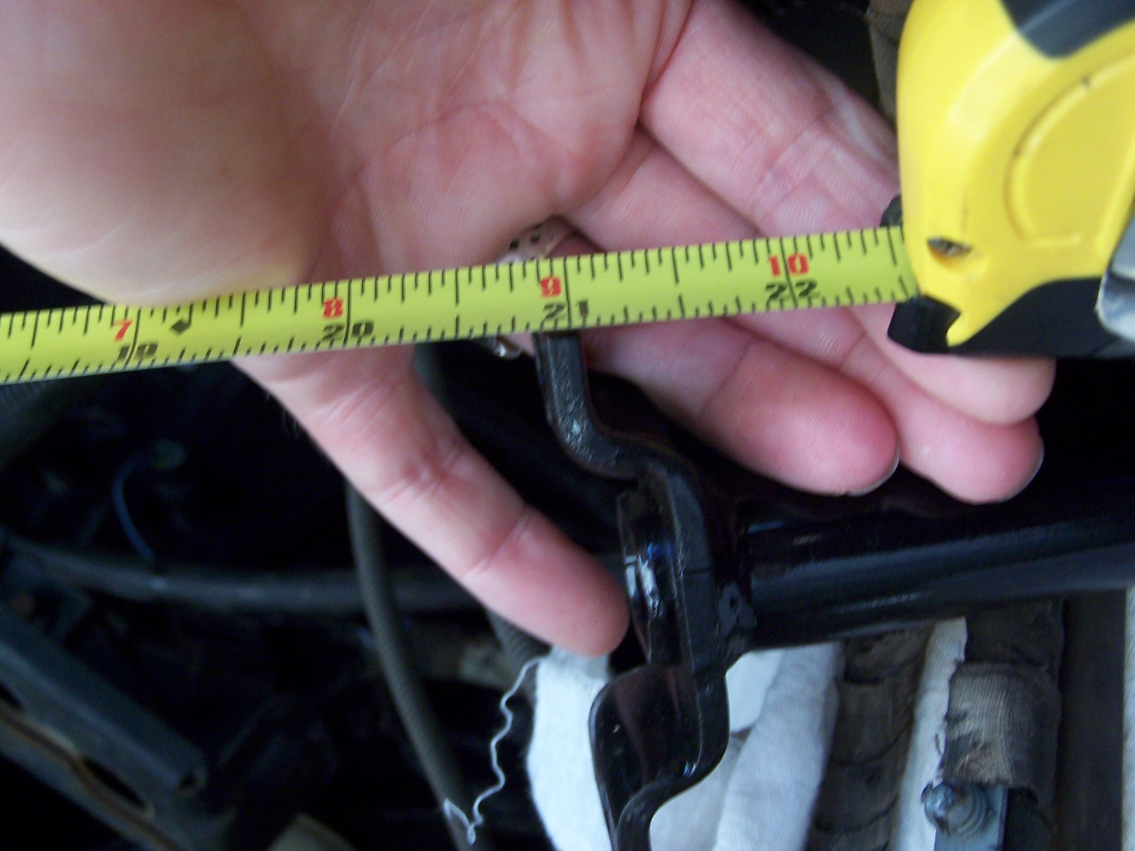

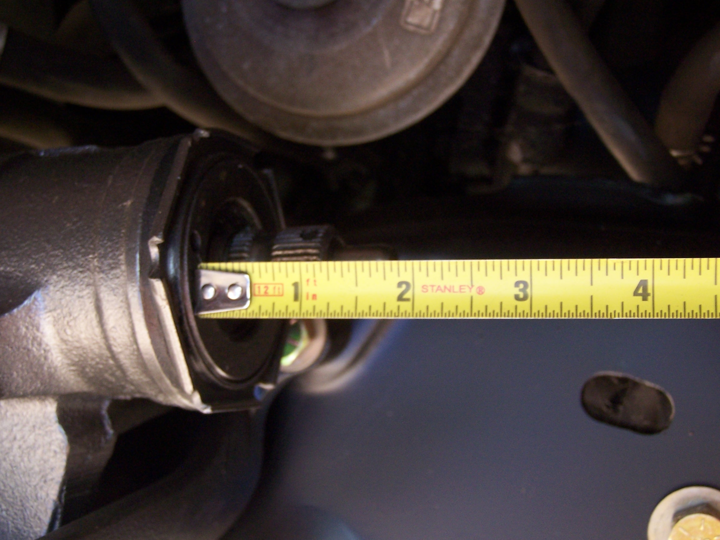

Here is a better measurement.A picture is worth a thousand posts
Ignore the angle of the tape in the first picture it is just for reference I had a hard time holding the tape and the camera at the right angle.

Thanks for the pics! Might have to cogitate on that a bit. I'm thinking 21" box to flange minus about 4" for the shaft splines and U joint plus an inch for shaft mating etc. Probably around 18" total length needed. I'll do some measuring next time I'm in the jy.
As long as as you start out long your good.
Is the input on your box 13/16"? or 3/4"?
