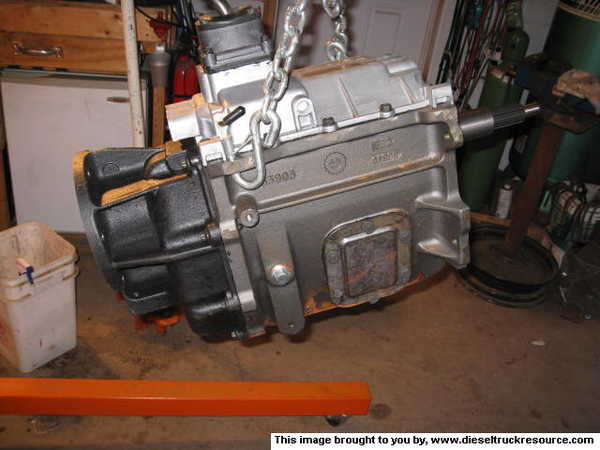

Here's a pic of the shiny new NV4500 that is going in the truck!
I wire wheeled the surface rust off the bottom, taped off mating surfaces and shift tower, primed it and painted it Valspar Equipment Yellow. Why you ask? Because TSC discontinued it and I bought 2 cases of it!!
