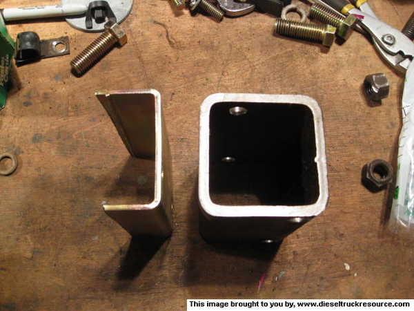

I replaced the chintzy, thin walled, weak excuse for a rear trans mount that came with the AA NV4500 conversion kit with actual 3x3x.25 inch steel tube. I should've done it when I installed the trans but I had misplaced the piece of square tube. I should have milled the slots in the mounting plate on the cross member about a quarter inch longer but it's in and it's solid. The mounting plate is a bit crooked now. Here's a comparison of the old mount and the new one.
That looks better.
