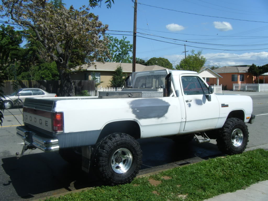

Congrats on the truck!! when i got mine i thought it was lacking power as well.. i got a denny T pin and gave me a little bite! only cost 100 bucks or so!
lol i would replace all the ujoints in that thing!
Got a pic of your pic up? post please!
