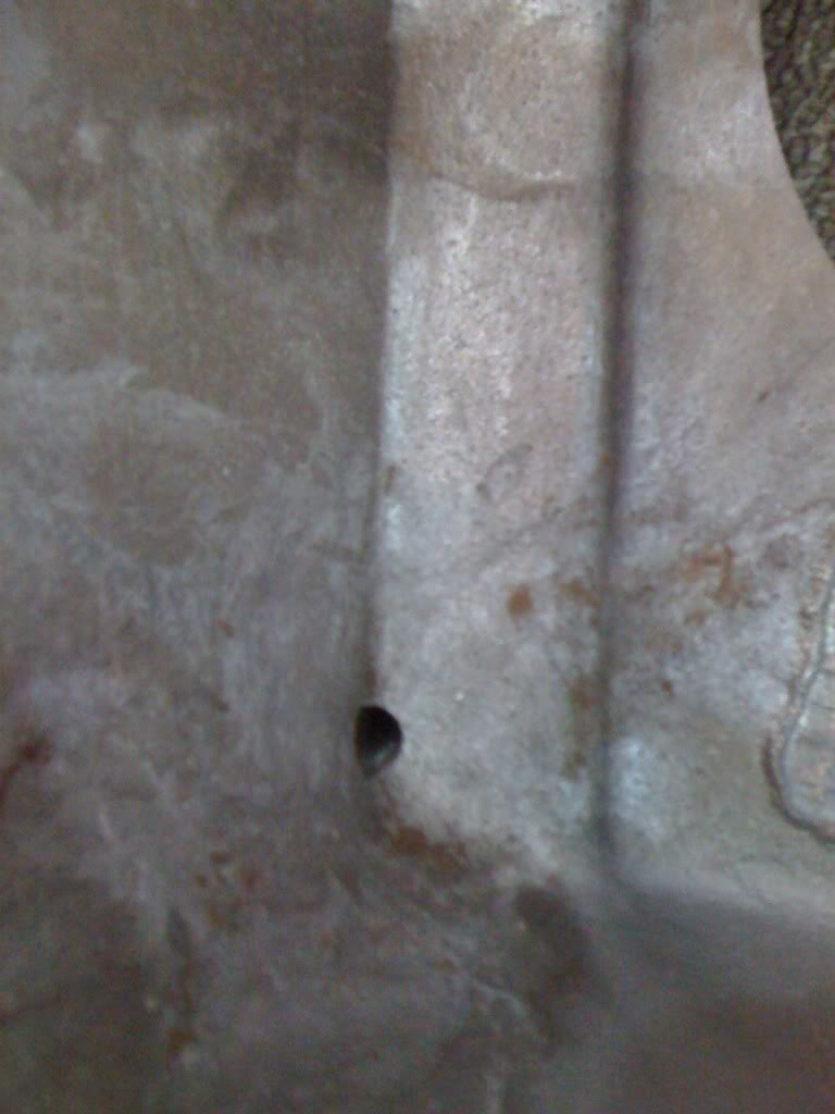

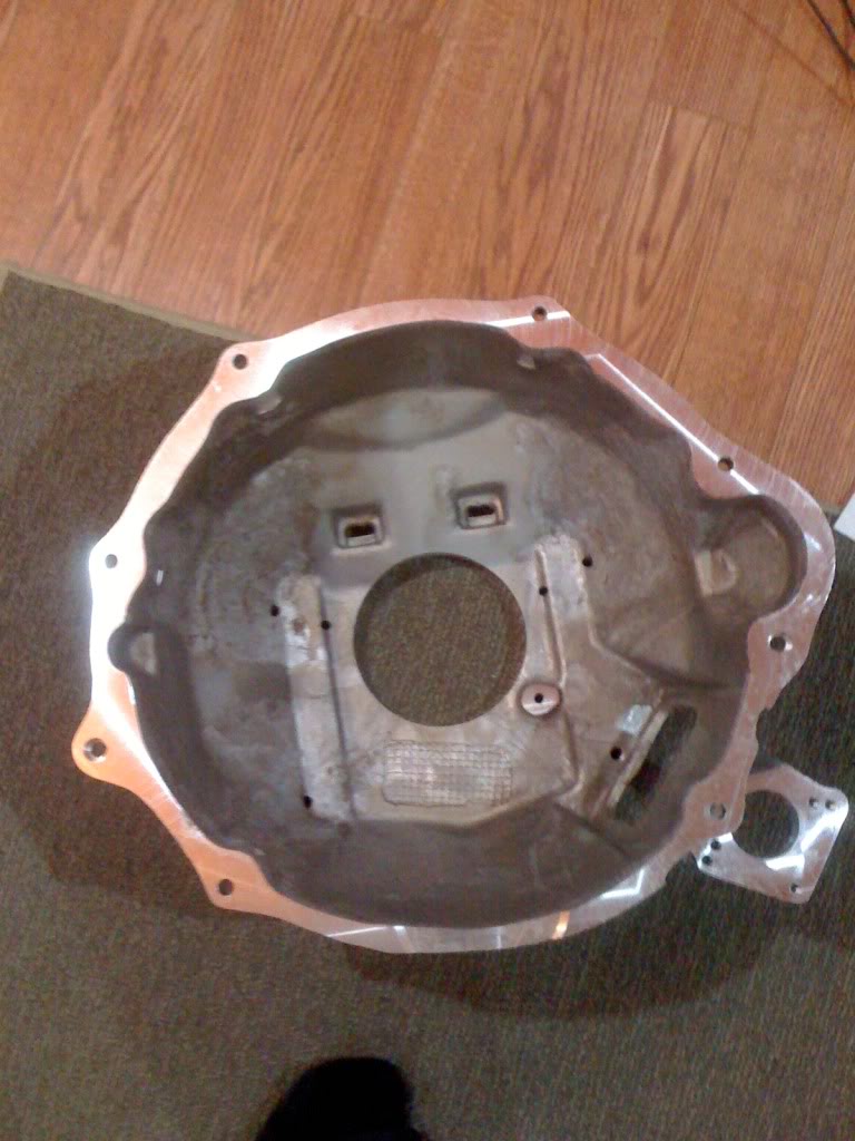

got my parts from hi-impact today - I'm not sure about the bellhousing - 3 outta 4 bolt holes were not drilled let alone recessed so you can bolt it to the tranny - I might have to take it to a machine shop to finish the job
tell me what do you think? sorry for my crappy iphone pics,,,
and a side pic so you can see what I mean about not being recessed...

I thought the bellhousing bolts on the front to the tranny like on most cars but I guess this one bolts through the tranny into the bellhousing...doh! Trying to find the right bolts for it now as it didn't come with any...and neither did my parts tranny

You should have bought an advance adapters kit. It comes with everything, bell, hardware kit, tranny to crossmember adapter, np205 bracket and rod if its a 4x4. I have used 3 AA kits and think its by far the best bang for the buck. It even comes with directions that show the correct length to take off the nv4500's bearing retainer. Made it real easy to take the it off then to a machine shop where they put it on the lathe and cut it straight and true. DONT USE A HACKSAW! Its very hard and it doesnt cost all that to have it done to the .001 on a lathe. I think they charged me $10 each time.
