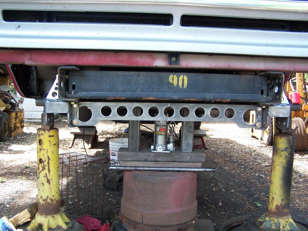

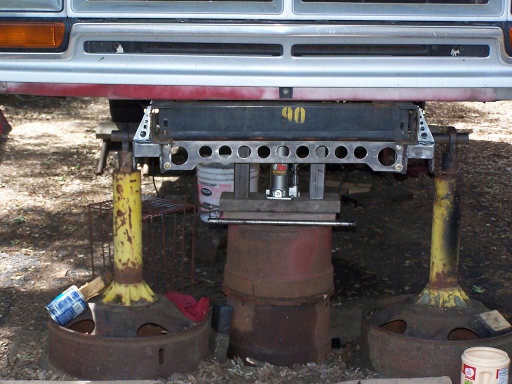

Holy parts batman
Today it decided the only easy way to assemble and dissemble my spring hanger brace is to make it a bolt on. So I welded up some flanges and bolted the hangers up (Again). It only took a little fitting to get the brace to fit.
All that was left to do was transfer punch and drill.A Little touch up and clean up and I am ready for some paint. who hoo!

I was trying to picture in my head, if and how, you where going to assemble that whole spring hanger unit and bolt it on as one assembly.
I see now.
Nice work as usual.
I see now.
Nice work as usual.
Thanks Oliver,
I couldn't figure a way to do it in one piece either. No matter how I would have tried to weld it the shrinkage would have bit me.
I think it is the best compromise I could come up with.
