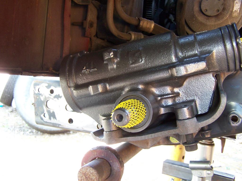

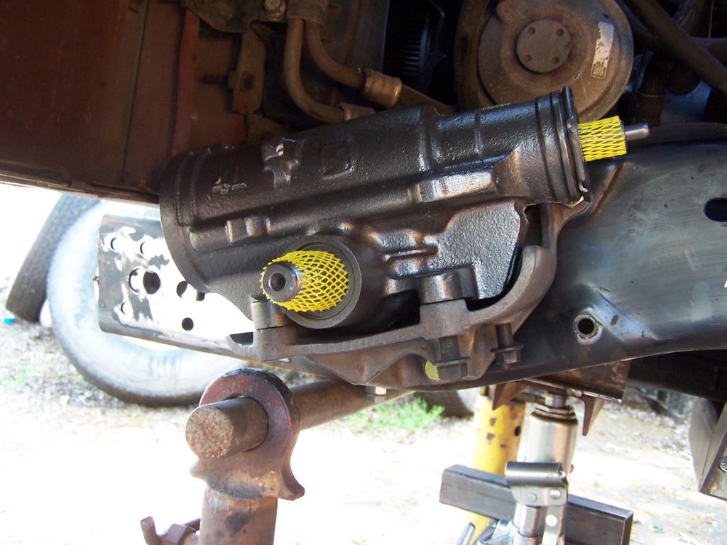

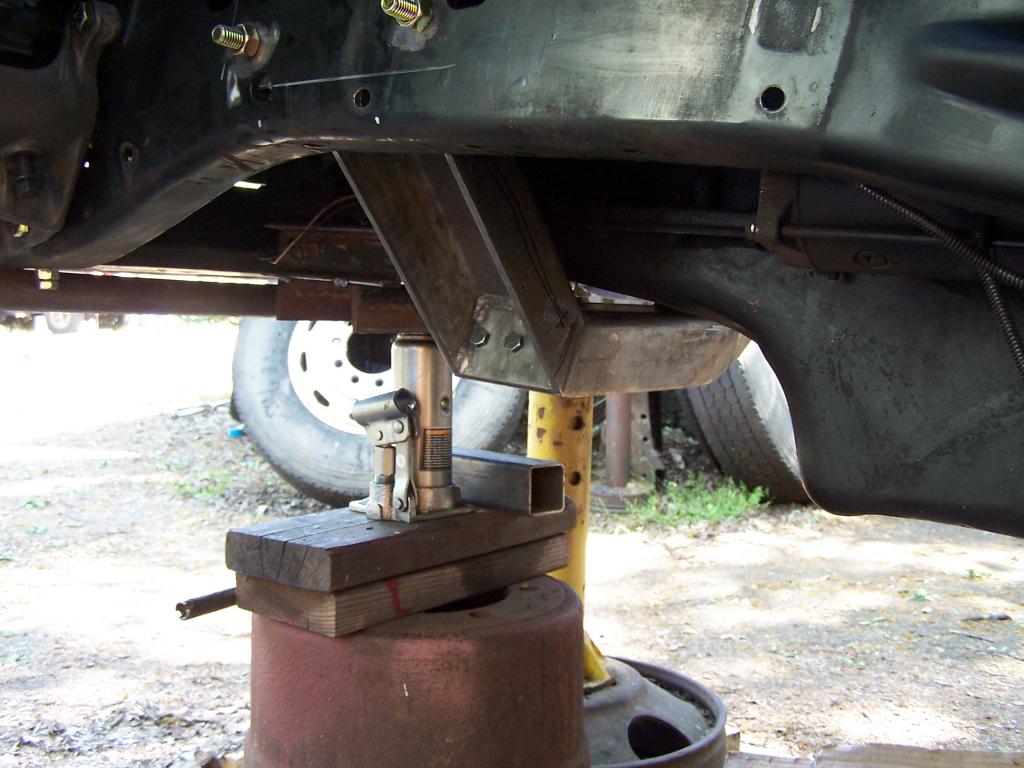

TodayIset the engine back on the cross member I is now low enough. the picture looks like it touches but it has 3/4": clearance. and the front of the engine is slightly lower than stock. T also loosely bolted the steering box up to check for interference with my spring hanger gussets. all is good. I also removed the front bumper and mounts for easier access.
Now I get to take it all apart so the rain doesn't rout it all up before I can paint it

Sorry pics somehow didnt show.
Attached Thumbnails 1990 D250 to W250-100_5493.jpg   1990 D250 to W250-100_5492.jpg   1990 D250 to W250-100_5491.jpg   1990 D250 to W250-100_5489.jpg
Old Apr 3, 2015 | 09:44 PM
  #637
That steering set-up just gives me tingly sensation in my happy places. You are almost making me want to do the 10 hour drive to go get the RR steering parts my buddy in Portland, OR has for me.

Wait….
It looks like your custom engine crossmember can be un bolted in case the oil pan needs to be pulled….

Wait….
SICK!
That was one of the added benefits of designing it to fit around the installed engine.
Doesn't it look so much better than the ones that came on our trucks.
ROAD TRIP!

Nice box .... Where'd you eventually get it from ?

I's a Lares From Rock Auto.

Did they offer it in a 3/4 AND a 13/16 RR box?
Just 13/16 I think.
