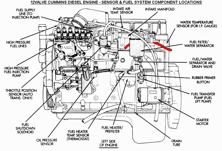

Return hose in red. Most times they suck air without leaking fuel so looking doesn't really help.

Thank Infidel - I've been unable to find that diagram large enough to make out the line well. The Red section is the "rubber" then - is that the braided stainless "Z" line or a separate piece connecting to that?
Just a hose clamp to the hard line from the IP I'm hoping?

It's a hard steel line at both ends of the hose secured by hose clamps.
Hose is 5/16" and about two feet long.
Like I said, you're ahead of the game to forget the short hose and instead buy enough to go all the way to the tank.
If you decide to replace just the short hose be very careful removing and installing the hose at the rear of the engine.
In the struggle behind the engine if you move the steel line much it's likely to crack leaving you with the same problem you started out with, just in a different place.
