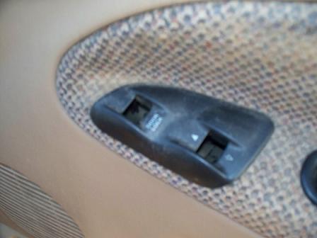

Anyone else had their door lock switch fall out of it's bezel?
Mine did, on passenger side. My passenger went too open the window and the switch just fell into the door interior. (see pic).
I'm guessing it's from dogs tending to stand on the arm rest on that side?
Just wondering if I can get the fixture out without removing the door interior panel.
RJ

First time I've seen that.
RJ

The whole bezel can be removed without pulling the door panel. There are little spring clips at the front and back of the bezel. You should be able to pry either end up to pop the bezel out, then you can see whether you can fish the switch out or not.
Thanks Justin. Found out can go through the door "pull cup" to get to the spring clips. Prevent possibility of breaking the bezel!
Saturdays project....along with changing out differential fluids.
RJ
