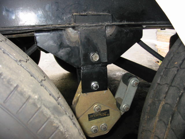

Here are some pics of the center bracket I installed (right pic) to enable use of those additional lower mounting holes on the outer spring mounts.
The center pic was before the change.
I didn't think about it changing the camber. Looks like your trailer suspension is similar to mine.
